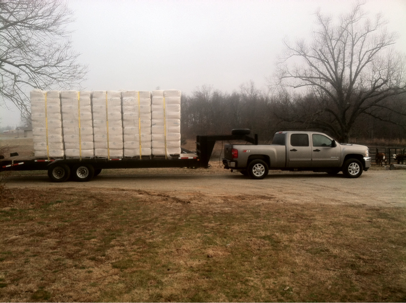

I switched to a gooseneck for a couple reasons well more than that. Number one, there is not a bumper pull that I am aware of that I can haul both my tractor and crew ranger. They are to short. I have to tie the ramps agaisnt the ranger with part of it sitting on the dovetail. That's with the loader on the gooseneck and the backhoe turned sideways. Also, I haul livestock bedding on pallets, 45 to a pallet, 1000 pounds to a pallet. Ten at a time. See pic. A deck over is the only way to go for this and hauling round bales of hay. It's just handier for me and handles my loads much better. Which I know you can get a bumper pull deck over. I agree that it sucks for taking up bed space. I always have a 50 gallon fuel tank in the bed, roadbox and 65 quart yeti in the bed. So it's always a move out of the way game when I hook up. LUTT

   / Is this right? I can tow MORE with a bumper pull than I can a Gooseneck? #22

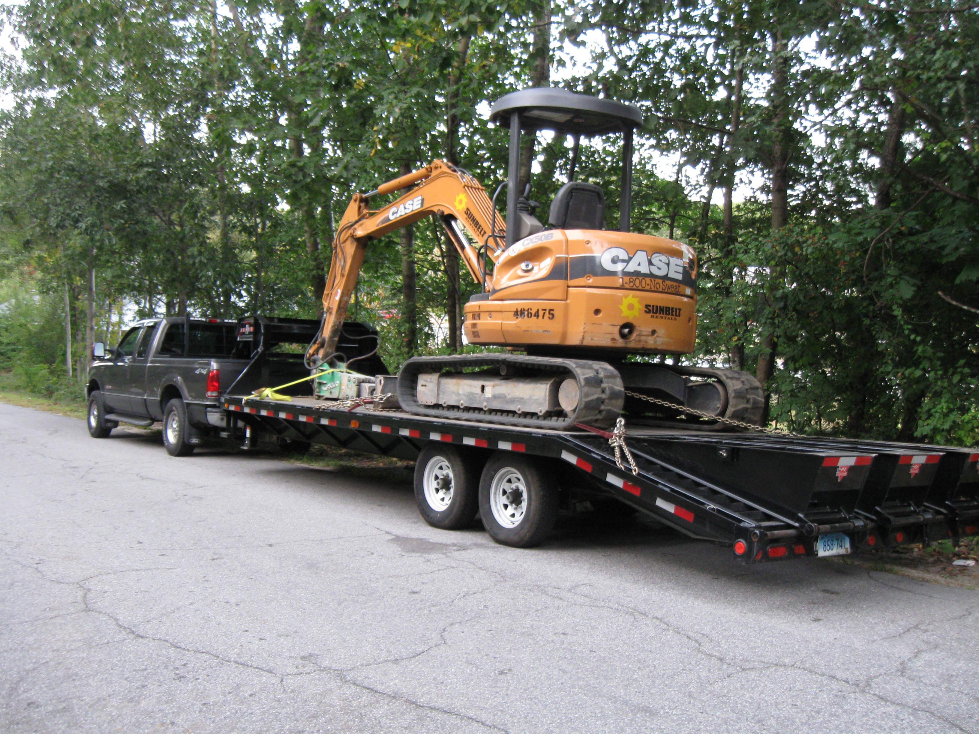

A gn won't weigh 6k unless you go with tandem duals. My PJ 25' weighed 4600 lbs empty, a gn is without a doubt better ride. Load placement will not be as big of an issue with the GN either. This was my last ride, an f250 with 9900 rating. It was night and day difference with this setup vs a BP.

That's an awesome setup Matt. The trailer looks REALLY nice! I have no doubt that a GN would ride better, that's a fact, and has been beaten to death already on this short thread :D Once again, the "best" ride isn't my main priority, fitting all my implements is, and for that, I need space in my bed. So although I completely agree that a GN would ride better, that's besides the point. The main point was that I was surprised I can carry more weight legally with a bumper pull than I can with a GN, and I wanted to double check to make sure I was figuring this right.
Maybe now that we realize my weights were off, it may make a difference. back to the calculator...
Your right, I was looking at the weights for the tandem duals by mistake. I was looking at this brochure from PJ. http://www.pjtrailers.com/brochures/web_flatdecks.pdf They list the standard dual 25' GN as 5,100 lbs empty, so certainly a difference from the 6k I stated earlier, my mistake.
They list the bumper pull 26' as 4,340 lbs. I'm just using the PJ brochure as an example. They also state right on there that the weights may not be exact, so who knows what to believe. Bottom line is the equivalent GN will weigh more than the bumper pull, and now that Rusty convinced me that my tranny is a ticking time bomb, I better stay as light as possible :laughing:
