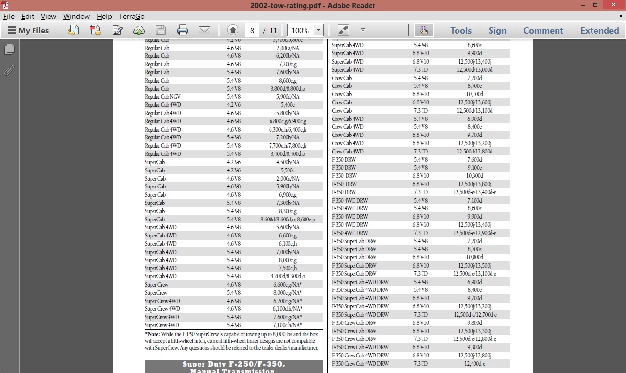

Couldn't you read the link I posted?
From trailerlife magazine.
It shows bumper pull up to 12,500 lbs.
here's a page View attachment 379818
I looked at your attachment which was for 2002 Ford vehicles
The OP stated he had a 1999.
Ford has various GVWRs in 2002 that go up to 11,500 lbs for a F-350 and you are correct in 2002 does allow a bumper pull up to 12,500 lbs with WDH.
I was just trying to get as close to the OP's vehicle as possible.
The GVWR for model year 1999 and 2000 appear very similar as they both list max. GVWR of 9,900. Lbs.

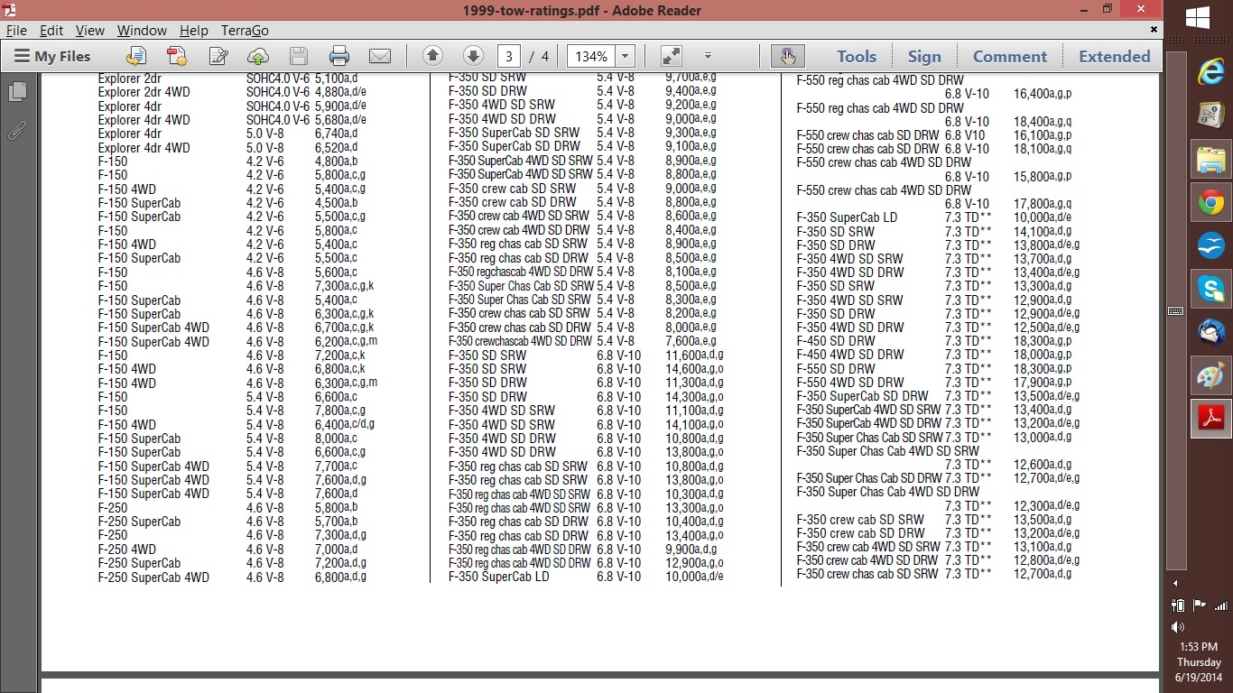

I'// try 1 more time:
What's the GCVWR rating? You might be above the rated tow capacity with a 16K trailer. My 2002 max tow capacity is rated at 12,500 lbs. according to published specs. And I've a 11.5K GVWR.
Texas - did you read the LINK?
View attachment 1999-tow-ratings.pdf
it doesn't seem to separate out bumperpull.
In my haste to reply I copied from the wrong file. I've the trailer life's files back to '99.
hopefully this will work - I have to do a screen print.

I think that is saying that my tow capacity would be 13,500lbs if I'm reading it correctly
Ok, I'll try one more time.
My info came directly from Ford.
Type in 2xxx ford trailer towing guide and do a search on that. (xxx for year)
Camper/Trailer Towing Guide - Ford Fleet will come up as result for what ever year you search on.
I would be more inclined to go with Ford's literature that a third party's
