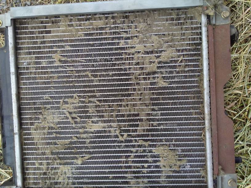

I think that's good logic Axlehub and agree almost completely. I have a different view of one topic which is cooling. I have a BX2200 which I've used for 16 years, have bought 2 others (used) as a service to other family members, etc. and I firmly believe there is a cooling design problem with the BX series. All these machines have the same issue about cooling. By the way I also have two B2150 4 cyl non-BX tractors that have NONE of this disease whatsoever. All the other tractors I ever owned (Deere, Massey Harris, Massey Ferg) had huge overkill in cooling capacity.
The problem is this: the BX series tractors, operated for longer periods of time in hot outside air temps (90's and more) while pulling a significant load, (like that of a 60 inch MMM deck mowing grass without stopping for an hour or two) will get hot. Period. Mine runs at the top end of the black range very near red under those conditions and always has -- that is with all the due diligence of cleaning the screen with compressed air, back blowing the radiator, cleaning the external shroud around the battery that lets cooling air in, etc.The slightest overlooking of care and it will go into the red under these conditions. These little buggers just get hotter than they SHOULD. Every once in a while one gets out of hand requiring remedial attention (there have been several TBN threads about it.) All the discussion to date contains a lot of speculation, the usual due diligence described above, etc. but NONE that I have ever seen get to the bottom of the problem and NONE have identified the real cause.
By process of elimination I feel I know what the cause MUST BE -- namely too small a water pump. The radiator is way bigger than necessary for that size a little engine. The fan likewise. The air paths are overkill and adequate (if cleaned out religiously...) , etc. I would bet some cash that a larger capacity water pump will cure the marginal issue. And it is a MARGINAL issue -- one you can get by with, one you can live with "BUT it ain't right!" I've never taken the time (nor invested a dime) to find out if the slightly larger Kubota engines' water pumps will fit the BX engines. I'd love to try it if I could find one that fits.
We have a BX2660 and it has had problems with cooling, but most stem from junk in the fins of the radiator. Attached is a picture of the radiator when I cleaned it and replaced the thermostat this spring.
Most of that was not visible with the radiator in place.
