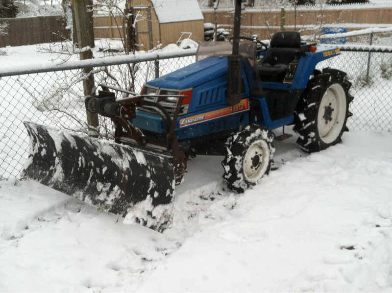

   / Iseki TU 160F #15
Does it look like this Roy?
   / Iseki TU 160F
#16
Hi Yes it looks exactly like the picture, except the side panels where it says Landhope 180 are missing on mine.
I assumed mine was a 160 because the engine mark is K3D 37205, K3D-D11G 16. and I thought the 16 meant 16hp hence 160.
What year is yours?
Roy
   / Iseki TU 160F #17
I wish I new what year it was but sadly I don't know. From what I have gathered it is a TU 180F. The f being for four wheel drive and the 180 being 18 hp. I have mostly used it for rototilling and plowing snow so far. I really like it, but am a little nervous about when it comes time to find parts.
