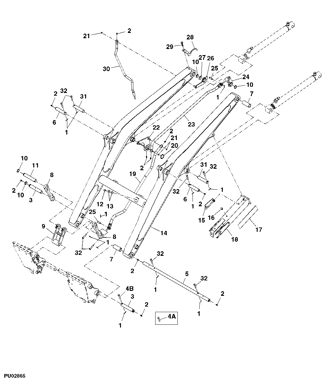

After comparing parts diagrams and the machine, it looks like the bellcrank is 90 degrees out, see part # 24 in the diagram. This might explain why it would work in some positions and bind in others. It also appears that someone messed with the bracket (part #28 in diagram), I'm not sure of its exact purpose, but it looks to be a stop so that the bellcrank doesn't rotate past its stop and bind/get stuck.

I've noticed that too! I'm too embarrassed to post a photo of the bracket that was bent out of the way. I'm not sure if this was done because they didn't understand how this setup works, but it looks like it would prevent the bellcrank from spinning around and getting stuck and binding.
