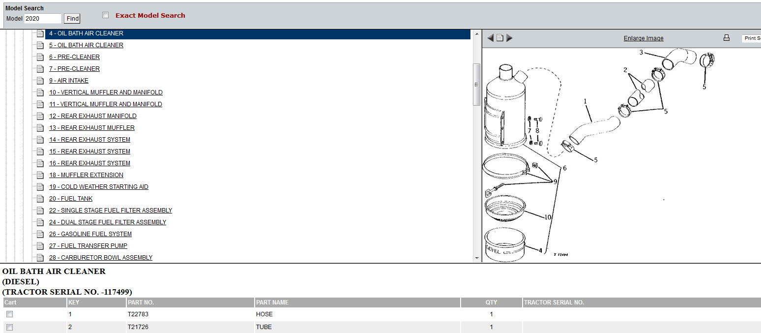

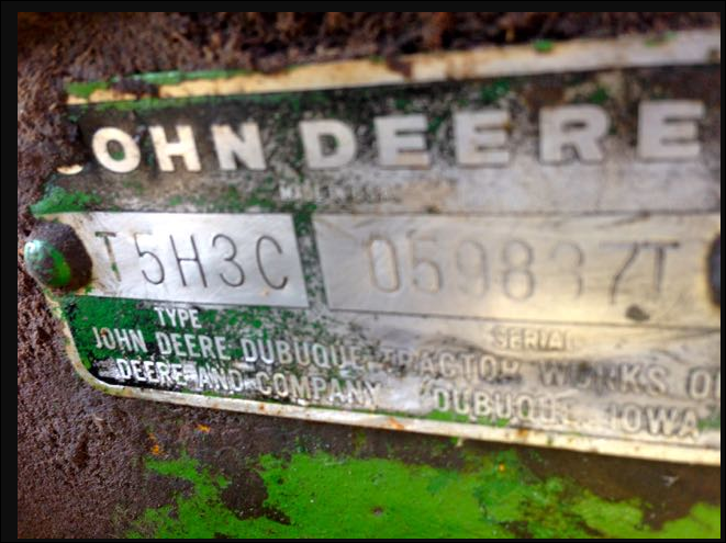

Oil bath air cleaner also came on 2020 built for N American sales contained in PC 971 in correct SN range for OP tractors SN of T5H3C 059837T

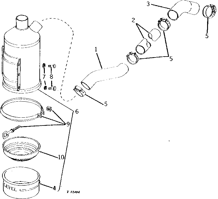

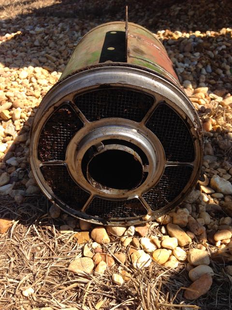

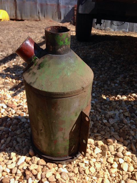

Oil bath air cleaner i took off today... (i wish i could modify this to an air filter...)
the oil bowl is easy to clean. but the metal interior???? do i really have to soak this thing???
   / JD 2030 Tractor SERIAL #? #43
Well, yes. It is a filter element doing its job of filtering dirt. See my post #39. The filter element is removable for cleaning. (Item #8)
Yes, but the Air Intake pipe plumbing is different for the various engines. A picture of the piping layout would help clarify matters?

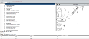

According to JD Parts - Oil Bath was optional on Spanish-built 2030 & 2130 WITH S/n 50000 +
2030, 2130 Tractors (s.n. 50000- )(Built in Spain)
View attachment 521298View attachment 521299
my set up is pretty much your diagram.. i'll take some pics. any pics etc.. on how to get that filter element out. and what's the best solution to clean the mesh element.. tx
   / JD 2030 Tractor SERIAL #? #46
bodin
I think you can see how it comes apart in reply #39 (post by spanner).
Or do you think that is not your air filter system?

I think photo from 2020 parts catalog will be closer to correct air cleaner than the photo spanner posted for an oil bath AC for 2030 built for Spain sales. The mess screen isn't designed to be removed to clean. To clean mesh one needs to submerge canister & mesh in solvent as a unit.

The filter mesh is available as a seperate Part Number from the 'can' on that particular model which is why I suggest it must have been replaceable, therefore removable as 'beenthere' has noted.
Bodin: As far as washing the mesh - Any clean solvent - Parts cleaner, Brake cleaner, White Spirits, Kerosene, Spray-Gun Cleaner, even petrol if you have nothing else, would do the job.

You brought up a good point. OP's serial tag states Dubuque,Ia not Getafe,Spain. Mesh in OP's air cleaner that in his photo is not easily removed.

His engine S/N stated made in Dubuque Iowa (USA)
That's because I'm nearly 100% positive it's not a 2030!!!!!!!!!! Read my #4 post on this thread Z5 does your 2030 have 4219 on engine SN tag?
I'll check it later today. I have the stamped number recorded, but not the complete tag numbers. Also my engine S/N does not match my frame S/N
