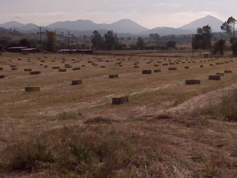

well great news i put 170 poly twine bent the tucker finger arm so they are even against the back stop then adjusted the tucker fingers to where they are supposed to be. today i baled 168 bales and did'n't miss one tie. thank you barry and everyone else for all the help and support.......
   / jd 214t baler
#50
here are some pics. even got my daughter baling
