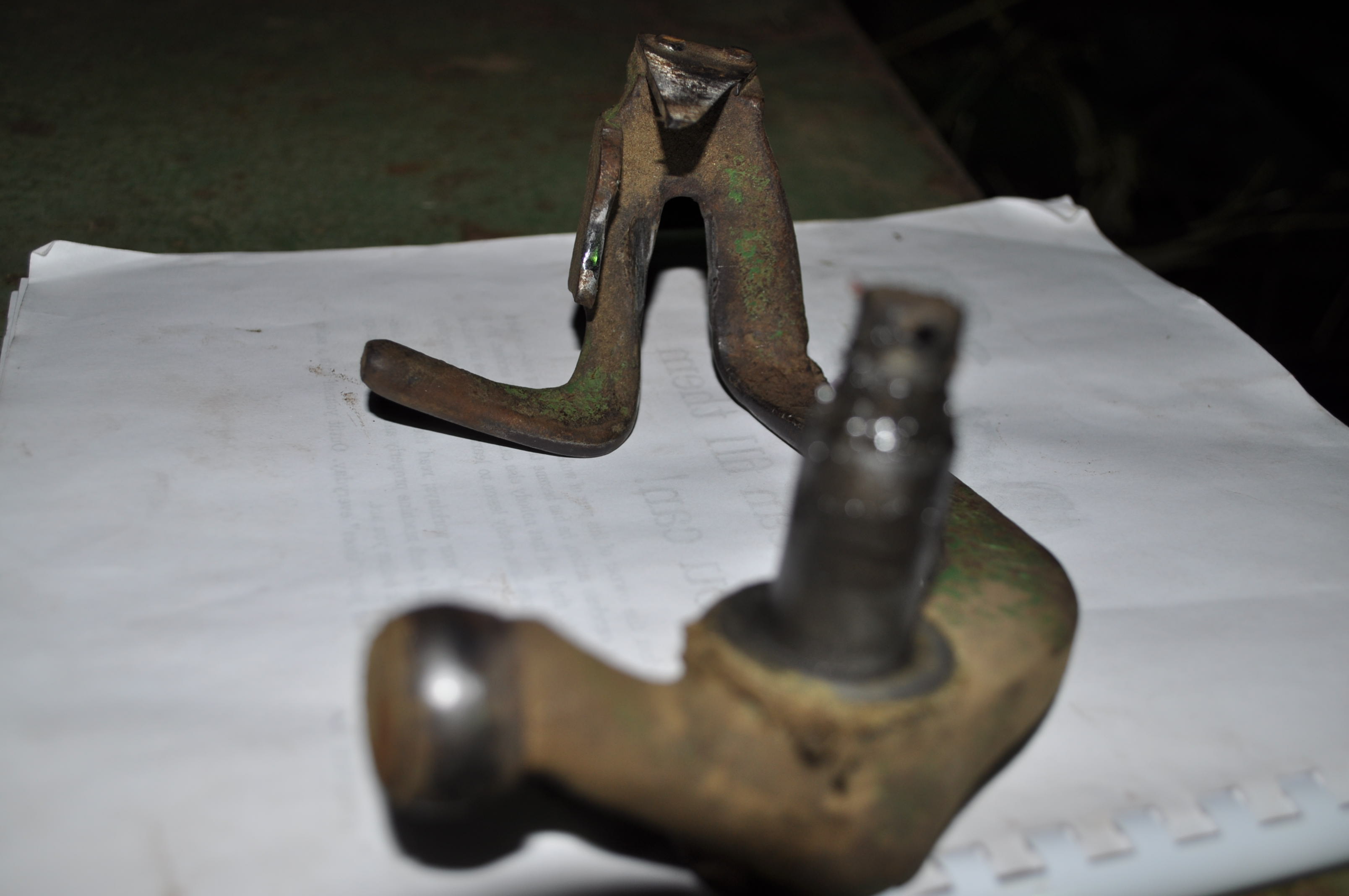

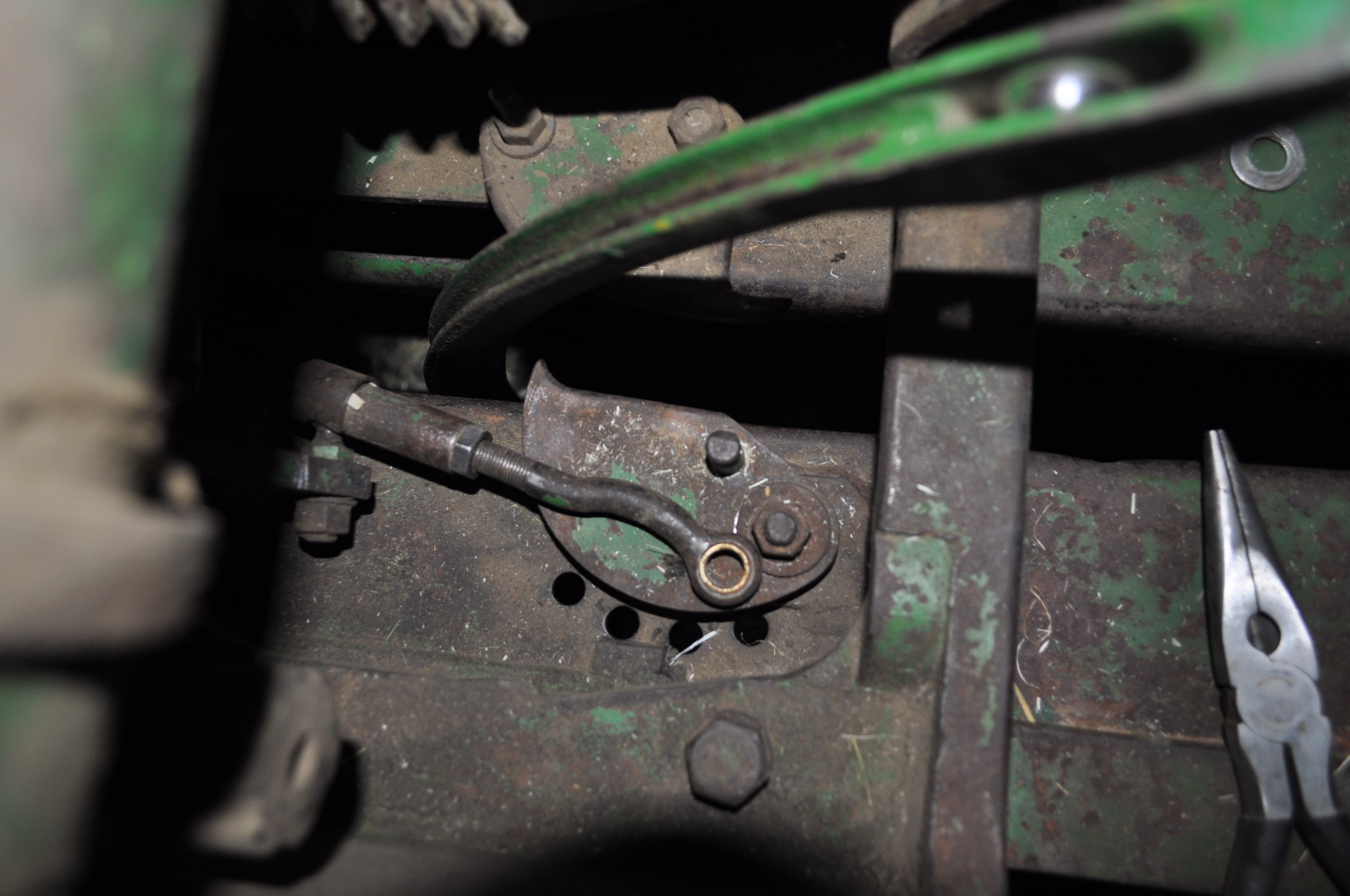

the ball is there ill look into the wiper more i did take off the flat springs and wire wheeled them put some anti sieze and reinstalled, also today i took out the right hand side disk holder and twine disk. the gear on top has some play in it and the pin is real loose. any thoughts on that? i found some knives in the bucket of stuff the guy gave me i might put them on i do have the knife pretty sharp. here is some pics of the tucker finger when i adjusted it to the book the left stopped knotting i put it back to where it was and it started knotting again. I have started to get more to knot on the right side having them adjusted the way it is now...take a look and lemme know. and Barry thank you for spending so much time helping me with this i'm learning alot and still enjoying the learning, although my hands still hurt from tying all those bales!

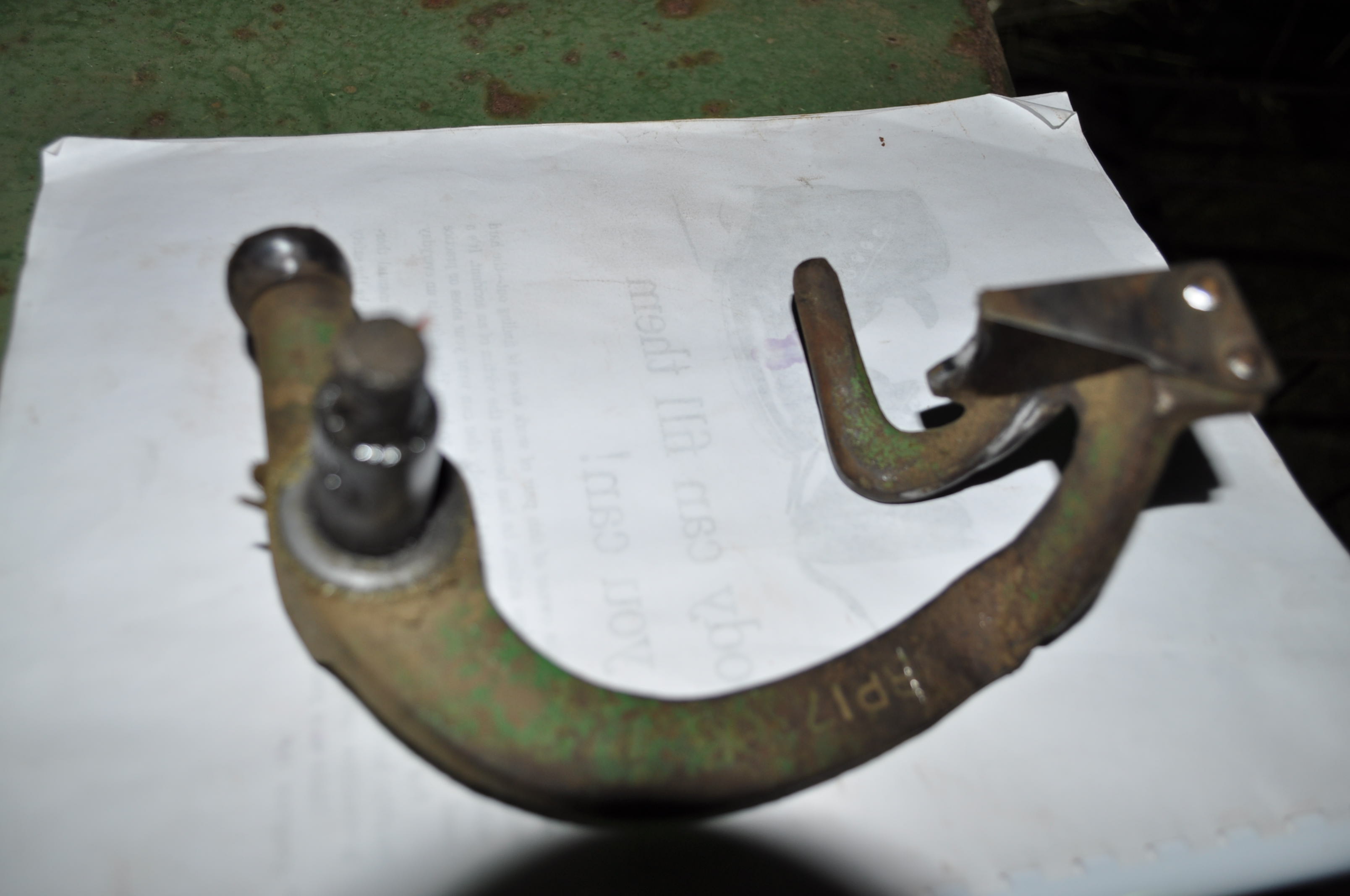

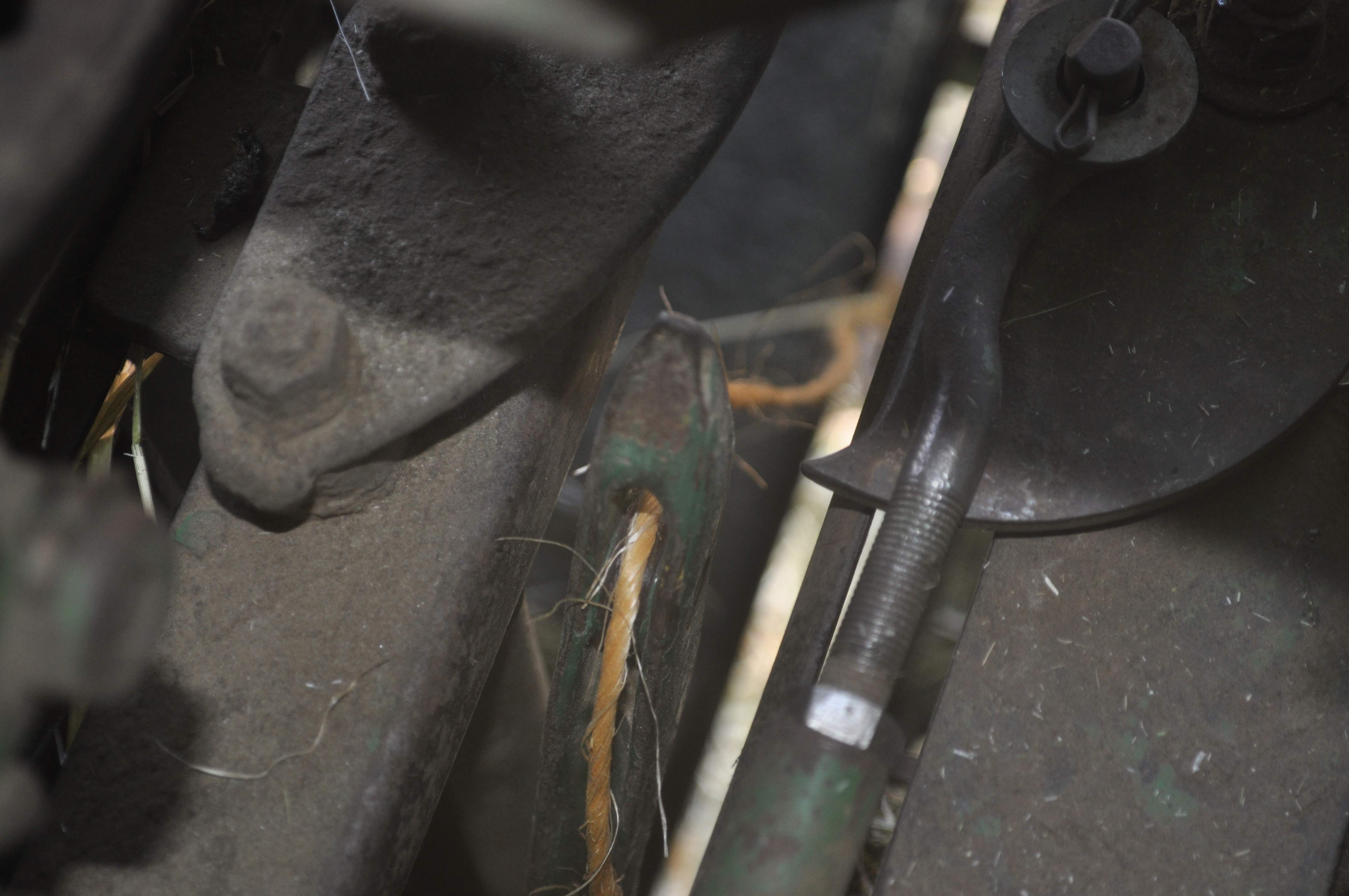

ok here is the wiper does it kinda look "normal" i think it is still kinda loose. i rubs with pressure but not 10-15 lbs pressure the tip is rubbing but like 2-3

With out actually holding it to look at, that does not strick me as being anything majorly wrong there. It looks pretty good. The pictures you send of the twine hanging on the bill hook is classic, I say classic, loose wiper and or dull knife. While you have it out, clamp it in a vice and give the wiper a good hammer blow. Work it back in and see if tight enough or if it needs more. Personally I like to sharpen the knives with a file, but wear gloves in case you slip. Rough sharpen with good file, and finish with fine sand paper. If you replace then, I have bolted then on instead of rivets. The ones I have done, a 1/4-28 thread worked just right to tap into hole. Becarefull not to long on bolt to get in way else where. JD did go to bolting on when they got into the 336's. It will make sharpening later much easier also.
The actual twine disc should not be loose. The disc cleaner that fits into the twine disc is loose naturally. The tensioner that goes into disc on the spring side hangs loose when no twine, but tight when loaded. If loose, maybe during tying, it holds twine tooooo tight???maybe?? You may need to determine if the shaft, or the knotter frame is worn to determine where to go from here. The twine disc and gear should still be available, but lets make sure that is the problem before we spend money. Maybe try switching up the twine discs and gears and see what you get to see if it is the knotter frame being warn or what. For older balers like this, see if there is a grave yard some where in UPS range. I have been able to buy complete knotters this way for like 100. The twine disc and gear will likely cost this or more. Some times these old balers got parked, because the people working on them just could not get it perfect or even close to right, but we will keep trying.
As to the tucker fingers, if you had a spot that was working well, stay with it. Older models like this do not have the same exact adjustments that the 24t and new have where the tucker is on a plate and moves forward and back for adjustment to the needle face. When this gets more critical is when you are really packing the hay to it.
