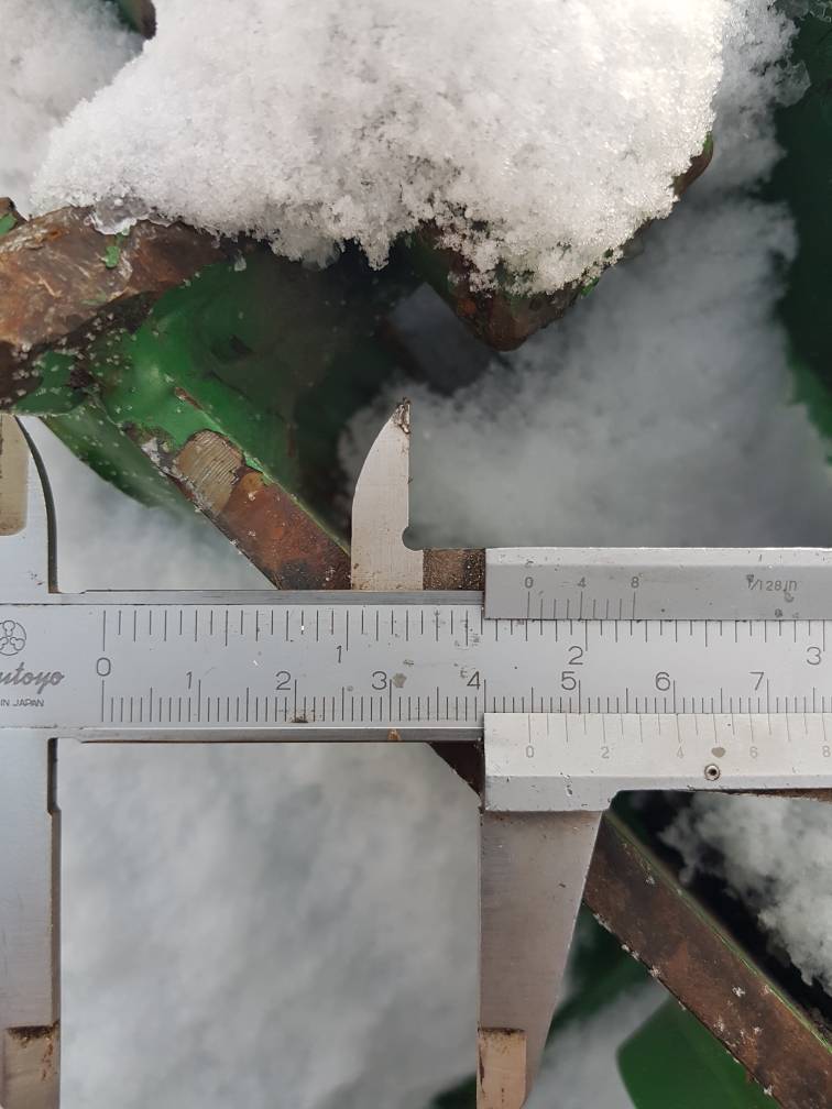

Does anybody know if H260 & H340 carriers will interchange ?
   / JD 540M Loader with Global Carrier Questions #24
I can give you the measurements tomorrow. For the bolt diameter, I may have to get a close guess.
#25
I took a skid steer carrier off a 540M (Same as H260) I bought & a buddy is wanting it for his H340.
I think it’ll fit
   / JD 540M Loader with Global Carrier Questions #26
The inside width between the loader arm is 38", the outside is 44 1/2", the bolt distance is 10 1/4" and the bolt diameter is 1 3/4".
I'm usually a metric guy and tried to get the imperial reading as good as possible.
#27
Bolt or Pin diameter ?
   / JD 540M Loader with Global Carrier Questions #28
Pin diameter.
   / JD 540M Loader with Global Carrier Questions #29
I see, I posted " bolt diameter". It should say "pin". I didn't take the snap ring out, but I assume the tiny edge outside the ring is the real diameter of the bore already.
#30
My pins are about 35mm or 1-3/8” so it probably won’t fit the H340
