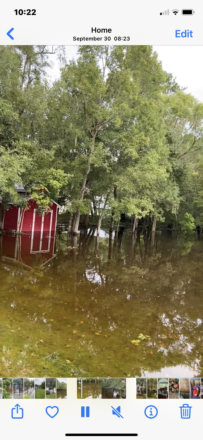

Team,
My 2010- JD2305 was in my little barn during Hurricane Ian a couple weeks ago here in Orlando. It was completely under water. Once it was dried out for a week. Oil and hydraulic fluid checked, no water in it.
I attempted to start. Once the preheat an two orange lights clicked on the dash, I tried. Nothing. So I put a battery charger on for a few hours. Got it started, mowed for several hours. Few days later, same thing.
What I finally realized after checking with a meter is the battery is good. So what I do is try to start the first time, nothing. Turn key off then quickly try an starts every time.
Only does it when cold. After ran for a while, starts right up. Anyone have any idea where to look ? It’s like a fuel solenoid is stuck.
Thanks for any info on my baby.
Bill V.

Went to start 2305 this am. Click. Let off key -then started. Back to its old trick since the flood.
I took the hood, grill and lower dash off. Disconnected battery.
Pulled every plug apart or off a relay I could find. Including starter and Alternator Sprayed out every connection with isopropyl alcohol pressurized. Blew dry with air. Used dielectric grease on all pins and assembled.Back together. =Click. Then starts on second attempt. Ugh. Again, only started this after the flood. Water level was half way up radiator, so I know the top dash and key switch wasn’t submerged.
At a loss. Any ideas out there ?
Appreciate any advise.
