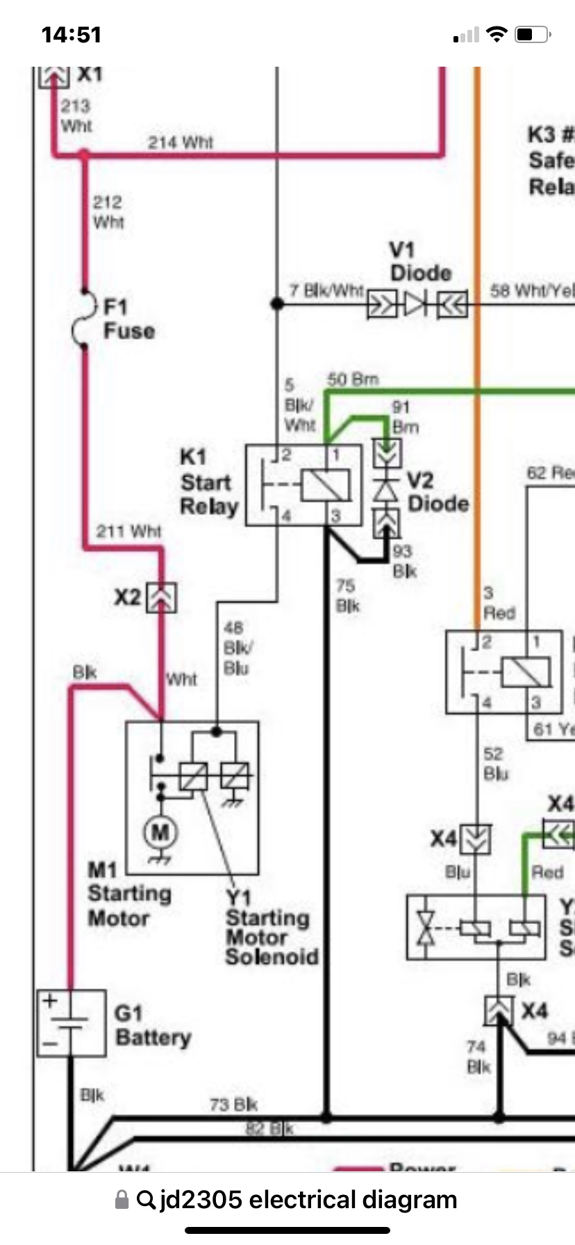

Relays are probably the issue. As said before, they are most likely not waterproof. Wet inside and slowly corroding away, especially if there's power in there to feed electrolysis corrosion.
I once had a flood in my basement and the sump pump outlet was sitting on the floor rather than draining the water away. After everything was fixed, everything was fine, and the pump worked great. But 6 months later, the sump pump failed. Water got into the little micro switches and it took a while for them to corrode away.
I would recommend replacing every relay, if it's easy to get to them. They're typically not too expensive and will get you ahead of a lot of flaky behavior.
Edit: Solid state "relays" should not be affected by the water, not sure if there are any of those in there.
Thanks, looks like a total of 5 relays. I may try to work on it Fri night. Probably try to take apart an clean. If I can’t. See if same part number and do some swapping on relays. Read on the starter. Looks easy to get out. Very comfortable with taking apart. But after reading. Yikes. Have to pull exhaust system an motor mounts. Take loader bracket off. Jack up motor. Ugh. Starter will be last I look at.

Agree. My jD gator, Cazador golf cart, JD D100. Farmall Cub, Kubota BX2380 and JD2305 all got new fluids, and filters. D100 was the only one that had water in the head. All are back to running 100%. Gas, diesel ,oil and hyd fluids all had water. Quite the mess considering I’m above flood plane. The 2305 is my last problem child. And really the one I care the most about. ( figures). I’ll get it eventually. Was just hoping that someone had seen this before and make the troubleshooting lazy for me. I’ve thrown $ and parts at things before. Don’t want to go that route till I know the bad part. As always, thanks for the valuable input. Really appreciate each and every one.

Started an new thread. Figured out it’s the starter. Or solenoid on the starter.

Yeah, kept delaying looking at it. Had loader on moving brush from the storm. I had started it several times. Then was like oh. It doesn’t do it anymore. One less thing on the to do list.

I’m just glad it finally showed me where the problem is. I’ve put 8 hours working on it so far. 6 trying to get the starter off. It’s an unbelievable bad design. I’m guessing another 8hours or more just to get the starter off. Mostly depends on how many times I have to stop to go patch my hands with bandages.

As for the design, they could have used two bolts instead of 3” studs. I plan to change the studs to bolts. Next guy will have a 20 min job. What I’ve figured out to take the starter off as built.
Remove mower deck
Take loader off
Remove left loader bracket from tractor
Remove exhaust pipe
Take nuts (4) off two left motor mounts.
Jack motor up for support
The worst part…. Take 7 bolts off plate on side of engine so top will come off both motor mounts.
Two nuts on starter
Elect removed (3)
The plate on the side of that holds the motor mounts is the worse. Barely get a wrench on the bolts.
14” wrench isn’t long enough to reach from the bottom, yet no assess from the side. Had to weld 6” bar onto 14mm wrench to reach them.
I’ve got them all loose, but not off yet. 1/4 turn at a time.
