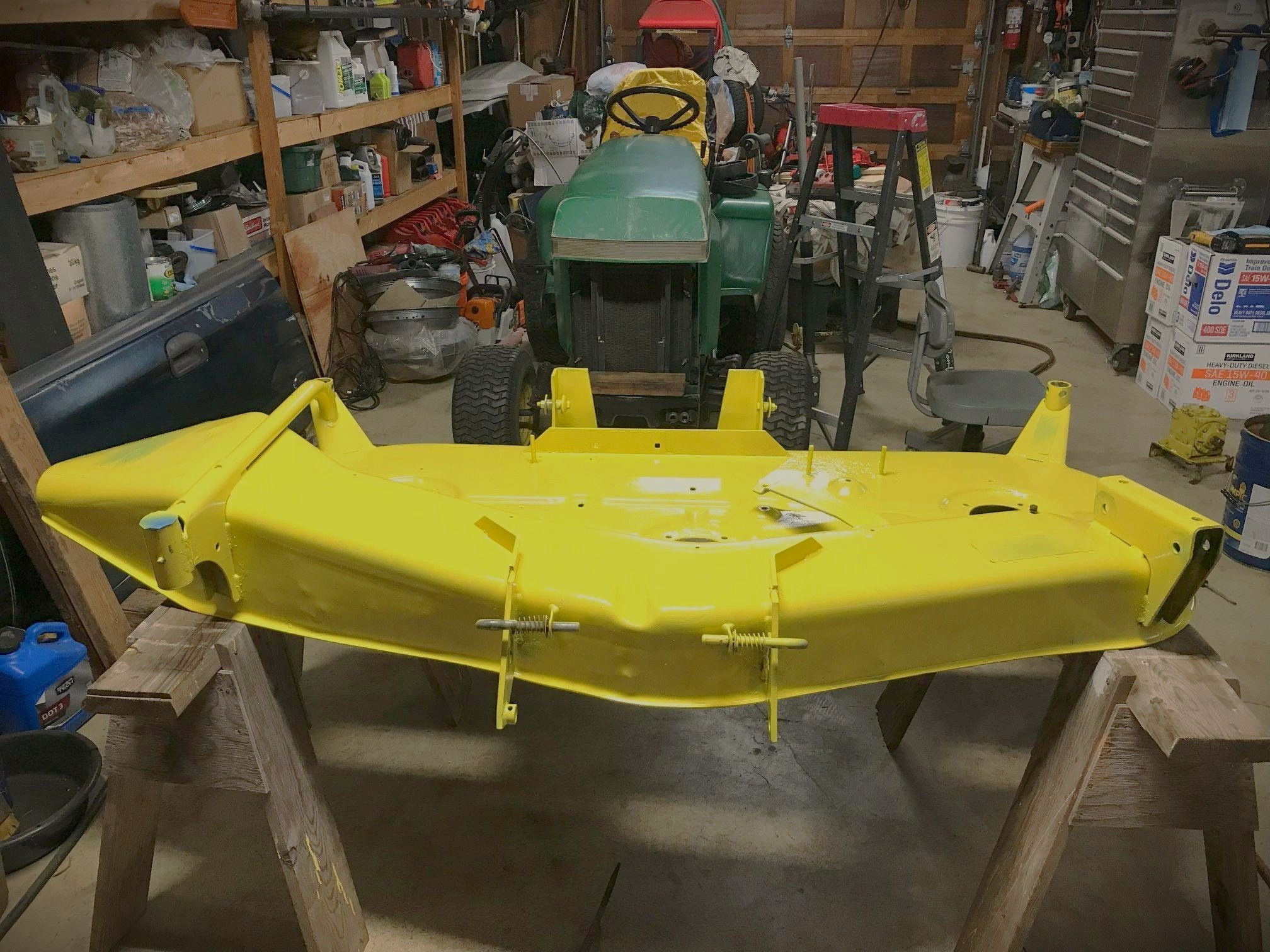

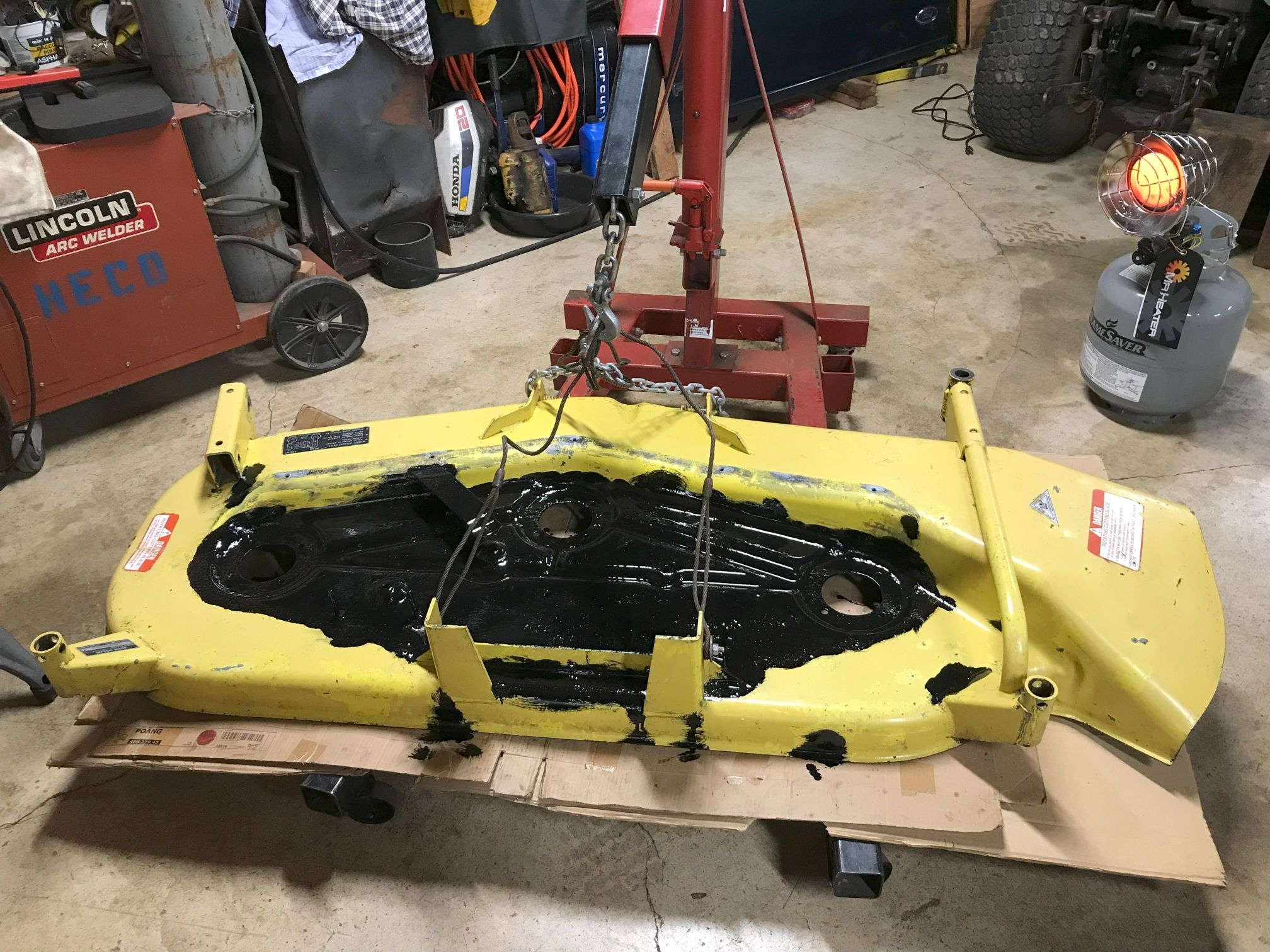

As mentioned in earlier post #24, I bought a used 60" JD400 mower deck in October and instead of using it as is decided recently to take it apart & overhaul completely.
Underneath the deck is in excellent condition and practically does not need any work, but it had some surface rust up on top where the safety shield was.
Under the shield there had been some (wet) grass clippings, hidden from the previous owner!
Here it is after surface prep and coat of Por15 paint:
After surface prep and a new coat of top paint:
I will probably delete the shield...
Overhauling the spindles & refitting new idlers, wheels etc. is in progress now.
