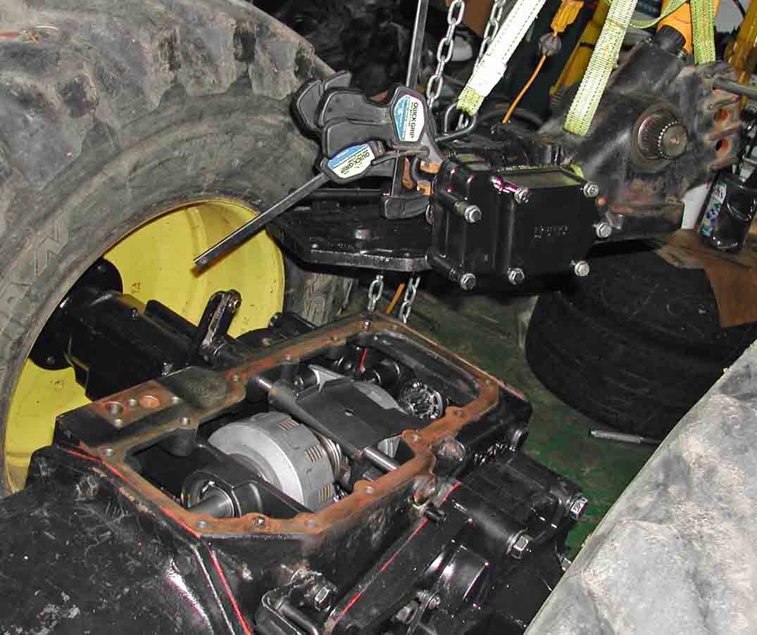

#286

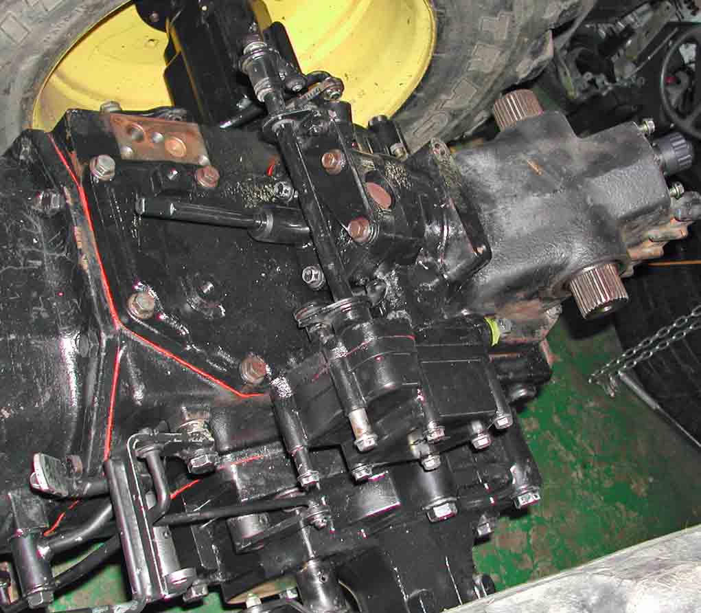

Here I am putting the 3-pt cylinder housing back on. All the rust has
been removed and it has been repainted....hopefully better than the
factory paint.

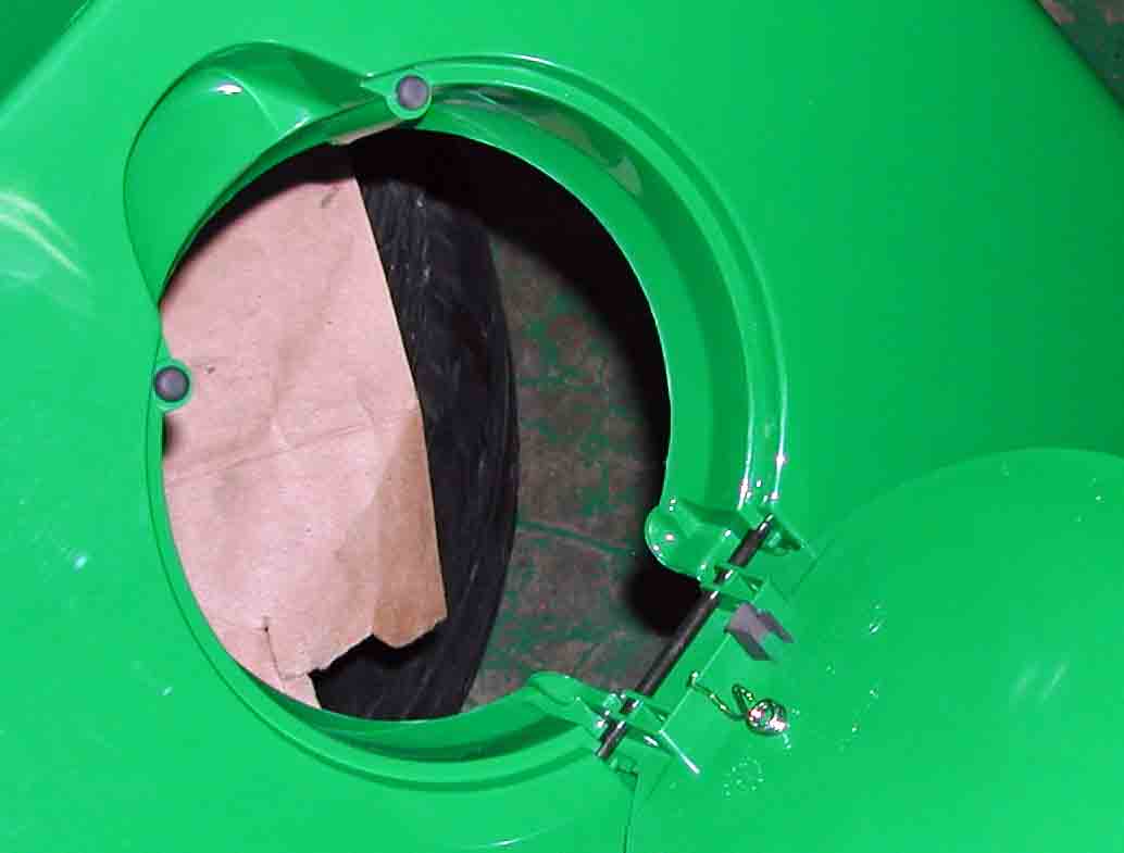

#288

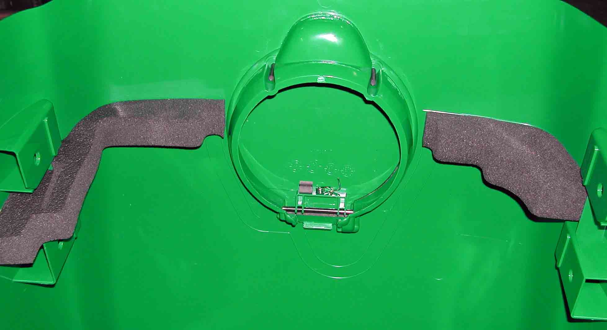

OK, here is another question for you 4x00 and 4x10 owners.
I am putting together my new hood and fuel door, which was totally
missing from this tractor. Some may think this door is optional. Anyway,
I have the door, which came with the hinge pin in it, and I have 2 clips
and one spring. I think the parts book says you need 2 springs. The
opening in the hood is assymmetrical. A picture of how the spring(s) and
clips go in would sure be helpful....

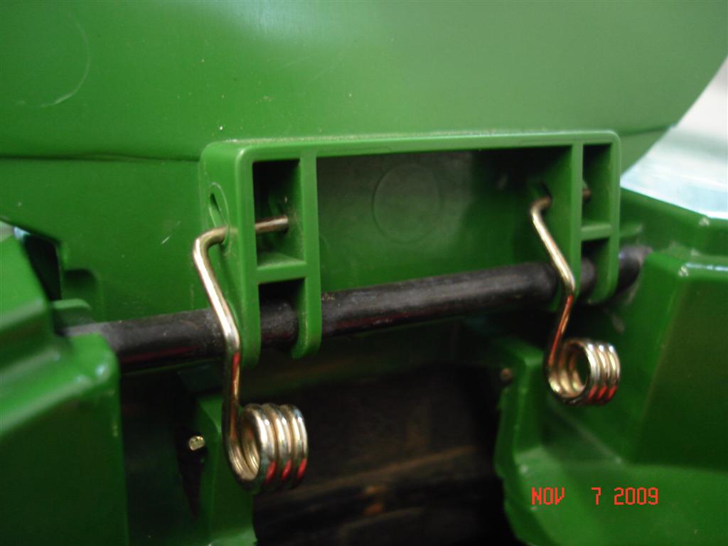

   / John Deere 4300 complete rebuild #289

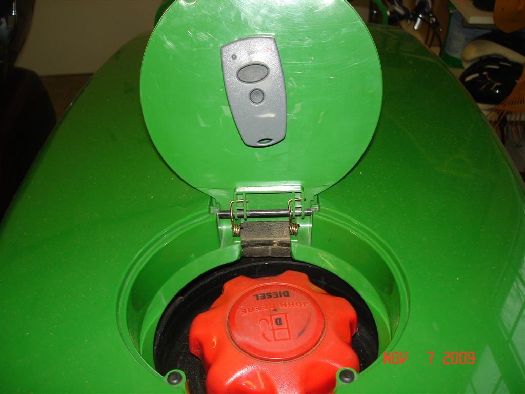

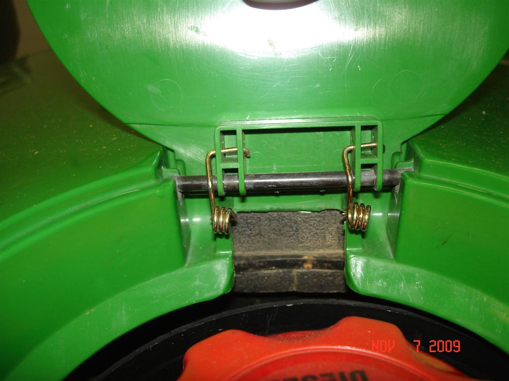

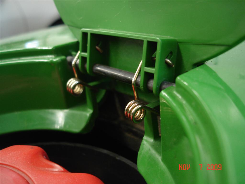

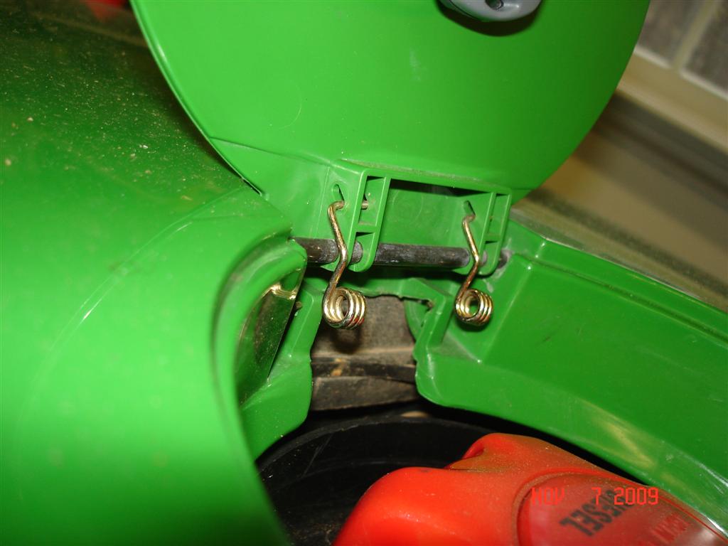

The fuel door is standard on the 4000 series of that vintage. I don't remember springs being on my fuel door. I'll try and get a picture for you tomorrow or Sunday.
   / John Deere 4300 complete rebuild #290
Here are 5 pictures: BTW-I have no "clips" but 2 springs.
