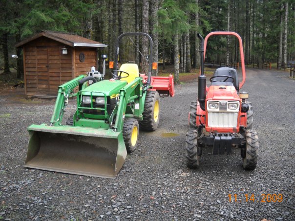

Wow, I bet you cant wait to see a backhoe on your 4300. Since the neighbor lost his shop/mancave last week to a huge fire, ive decided it would be fun to fix up his tractor that was inside durring the fire. It is a John Deere 4100 with a FEL and a rototiller. He did have insurance on most everything in the building but he did loose $500,000 worth of stuff. I originally wanted to fix the FEL and the tiller but yesterday my mom's friend said that a diesel tractor is usually saveable since it is only going to loose the plastics/ rubbers/ and wiring. Oh, and the paint. Looking at the tractor, externally it looks in fare shape except the tires are gone and so is all the paint. I was the last one to drive the tractor and did notice it had some things that needed to be fixed. Like the FEL cylinders had internal leaking so they couldnt hold in a curl or lift for very long. The 3 point had issues with lowering the tiller, and it seemed to like to turn left on inclines. If I do in fact get it, it will be a major project and im sure it will cost a bit in parts but in the end I will have a nice tractor for a very low price. It would be my 3rd tractor. Im 14! Opinions are welcome and so is any advice. Oh, my mom knows some people who know a lot about working with diesel engines as well as a guy who used to be a mechanic at John Deere. So I wouldnt be alone. I will most likely have to wait to work on the tractor itself until my mom builds a shop next summer so my first focus is the tiller and the FEL. The only problem, getting it home. I will probably remove the tiller and haul it home on my forks. I would do the same with the FEL but i know it wouldnt work to well.
   / John Deere 4300 complete rebuild #368
Here is the Deere next to my Yanmar 2 weeks before it was in the fire.

If its been in a fire, I would pass on it, unless the damage is very light. If it burned the paint off and roasted the tires, it got hot and that can weaken the metal.
   / John Deere 4300 complete rebuild #370
Not only that, a lot of the seals/o-rings could be melted or damaged (warped/distorted) from heat so that once you got it running, it might start leaking from any number of places. You see what it did to the rubber tires, right? You could really tie up some money into having to replace a bunch of seals. I would have to pass it on it, but that's just my opinion.
