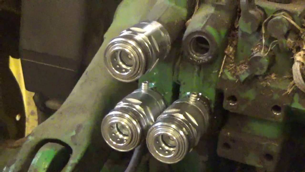

Let me try this again I am attaching a pic that is not mine but we have the same quick connects( right term?) I am 99% sure we have the correct size it works and has been working but it goes through these times and the only thing so far that as allowed us to use for any length of time is replacing the quick connects sliver things? Eventually they start blowing the implement hydraulic house out of the quick connect while at the same time shooting fluid out from between the quick connectors not where it is screwed into the tractor(green paint). We have replaced them at least twice and they work for awhile and then start doing this again. I have hooked it up to different implements with the same result.
This is not my tractor in the pic but same set up.
   / John Deere 6400 Hydraulic hoses keep popping out!! #19
Those don't look like JD couplers. Those look like high pressure (10,000psi) couplers (TC-371). I've only seen those on automotive ram jacks and such--The locking sleeve stays back when released. If that's the case, the couplers are mismatched for typical tractor implements.
Back to post #13. We need to see the male side of the QC connectors.
