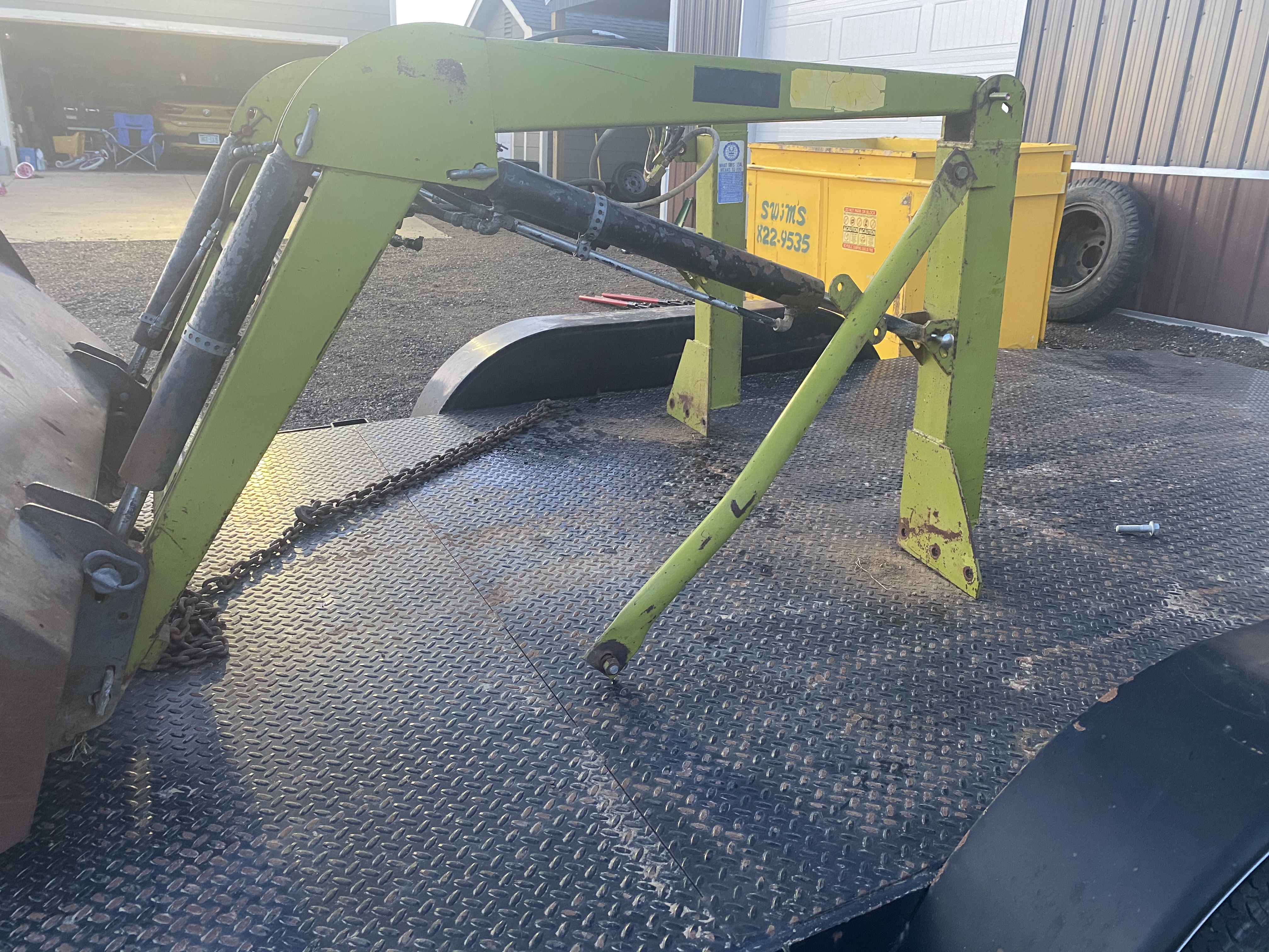

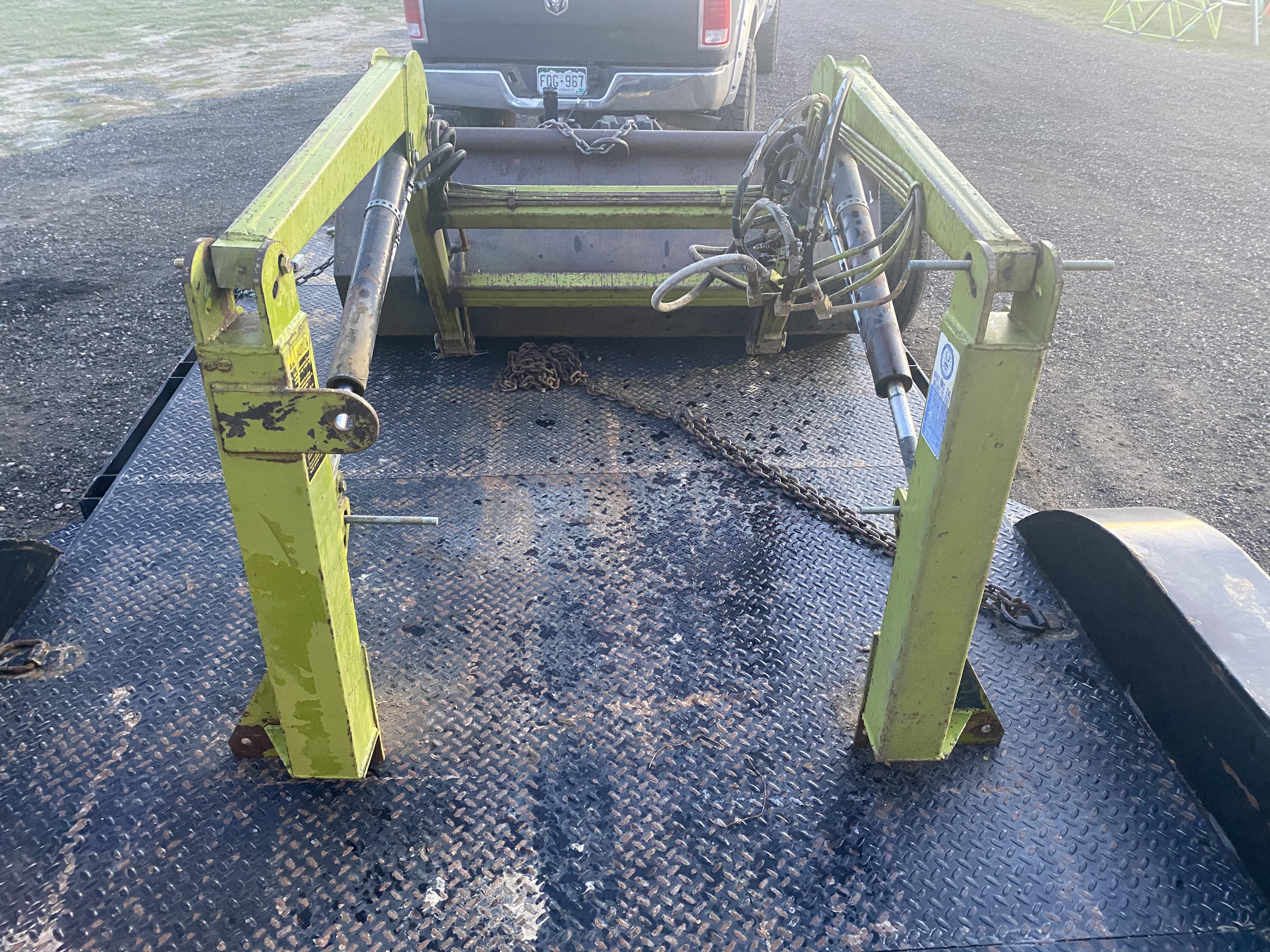

Does anyone Recognize This loader model?
Just picked it up tonight. Guy said it came on my ym240d.
I had assumed it would be a YFL240, but that doesn稚 appear to be the case.

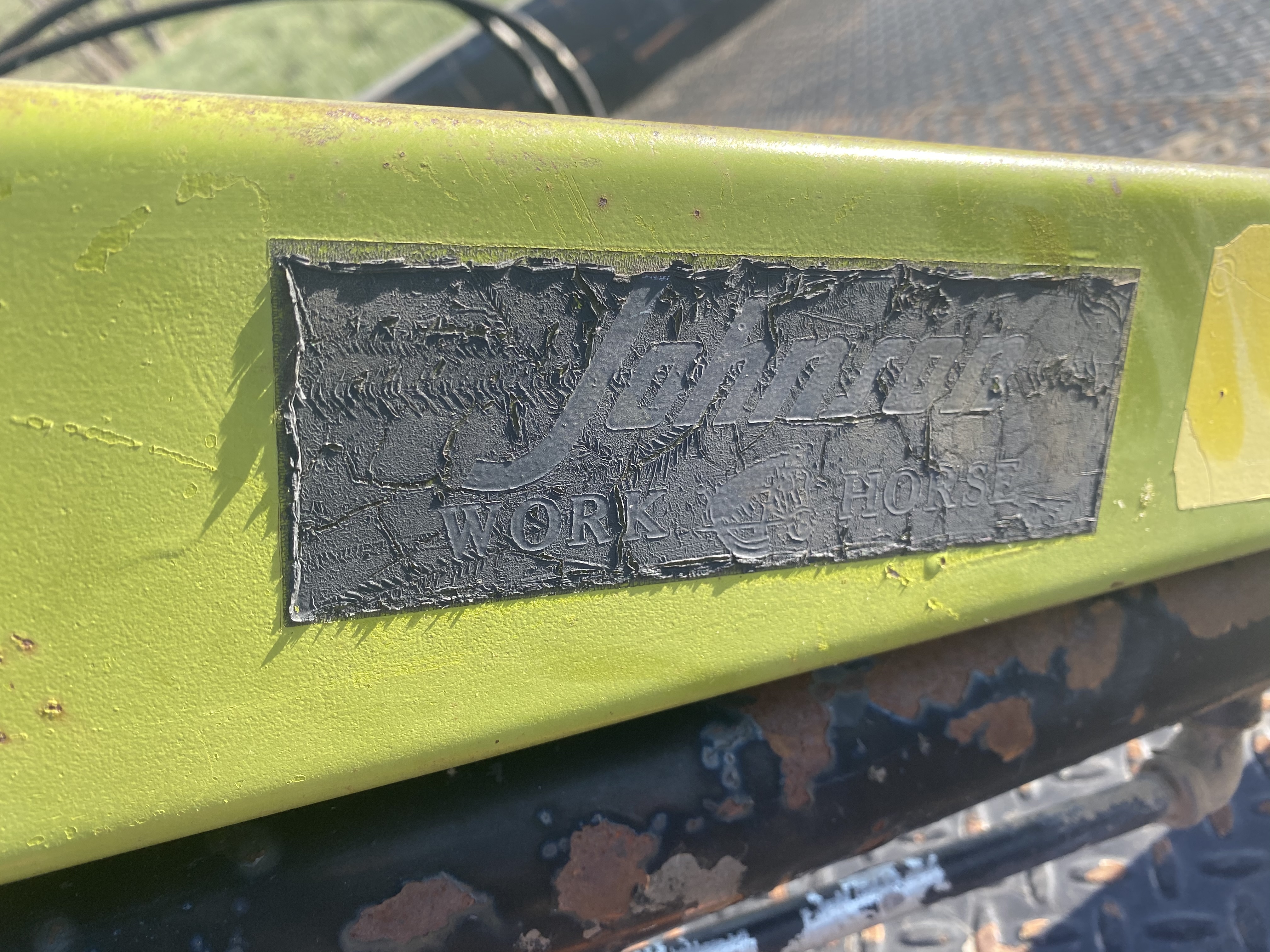

The only tag I can read on it says å±*ohnson workhorse?
That doesn稚 give me much, but it痴 a start.

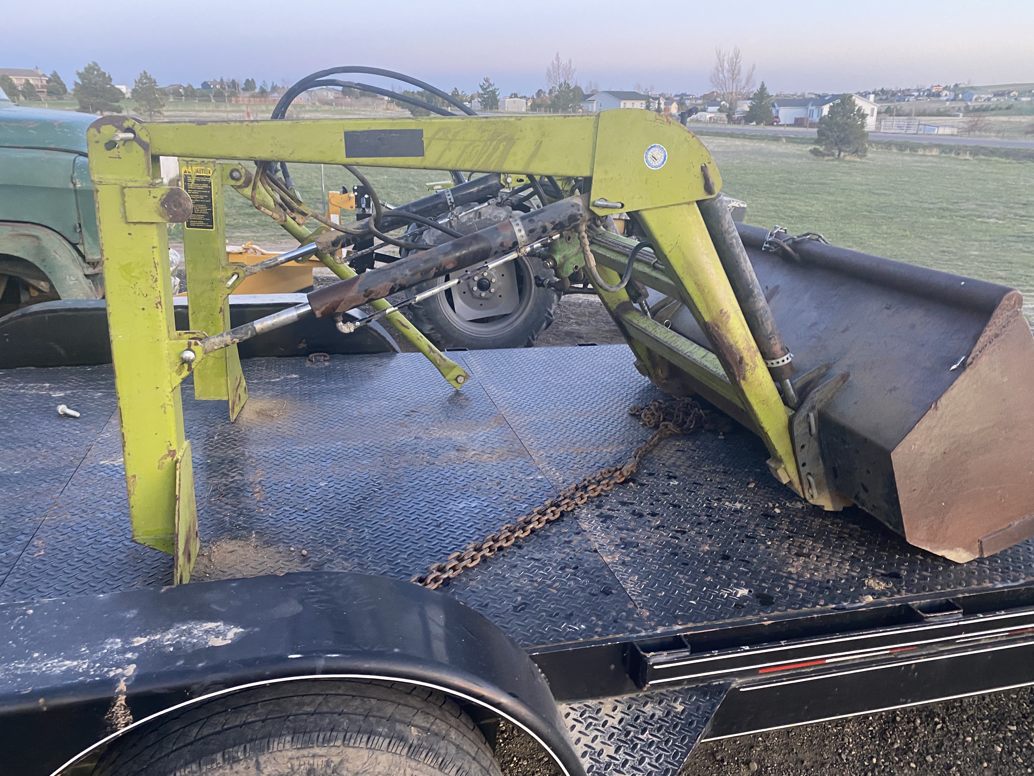

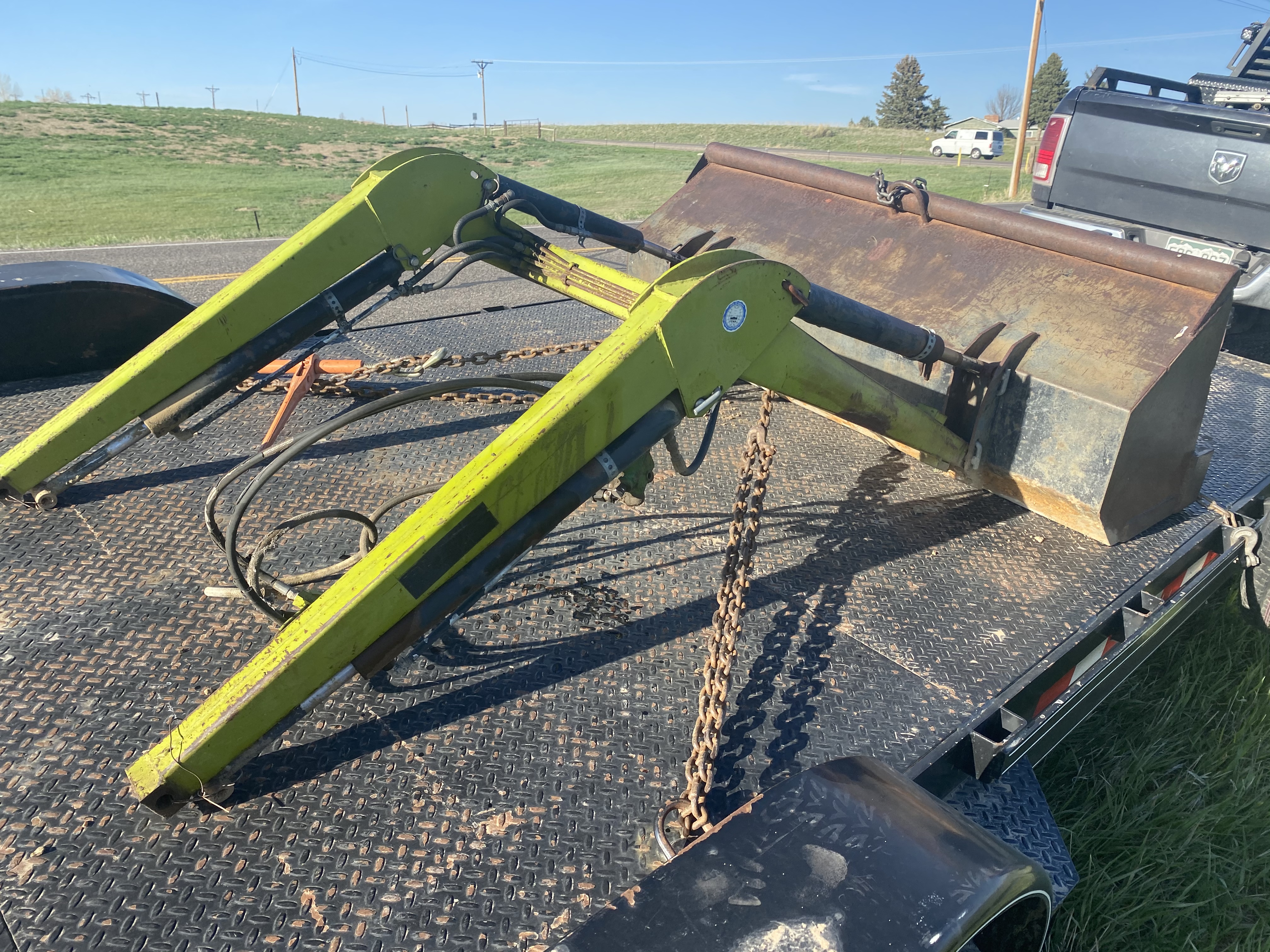

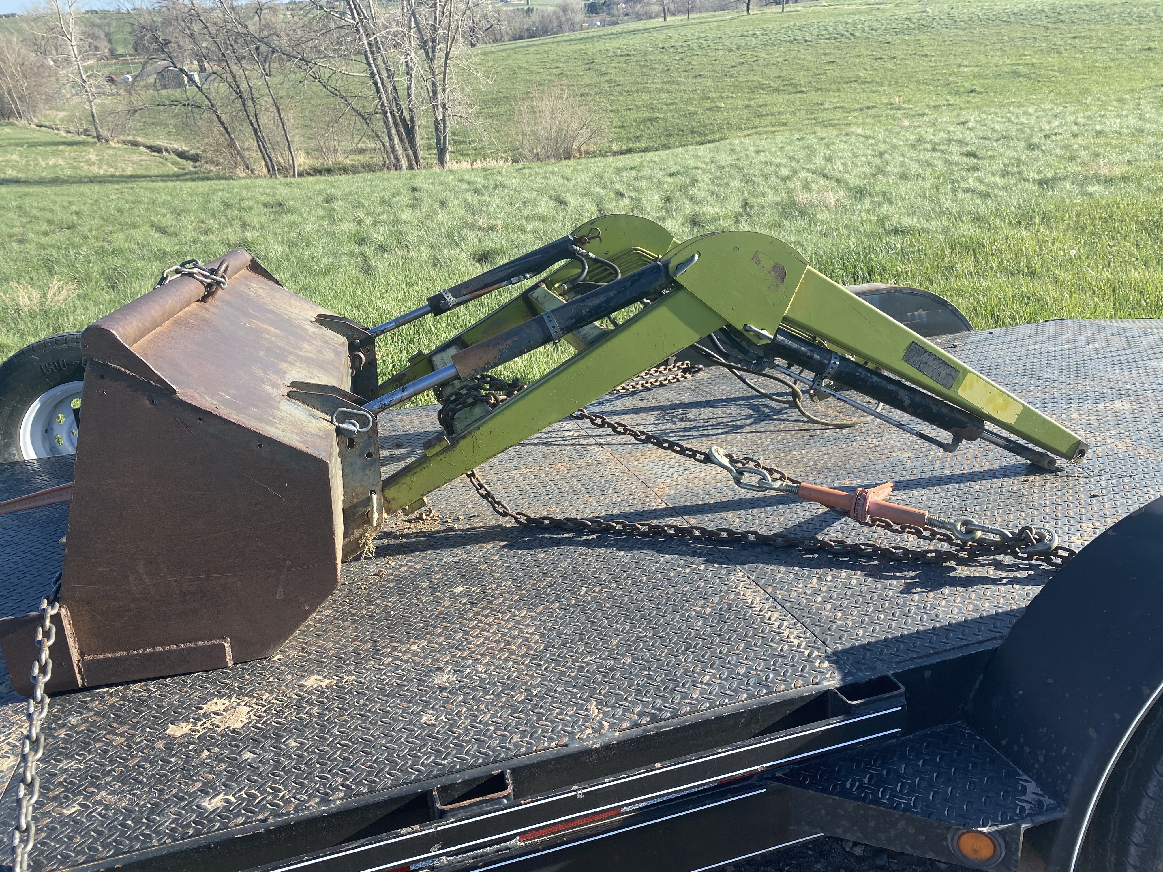

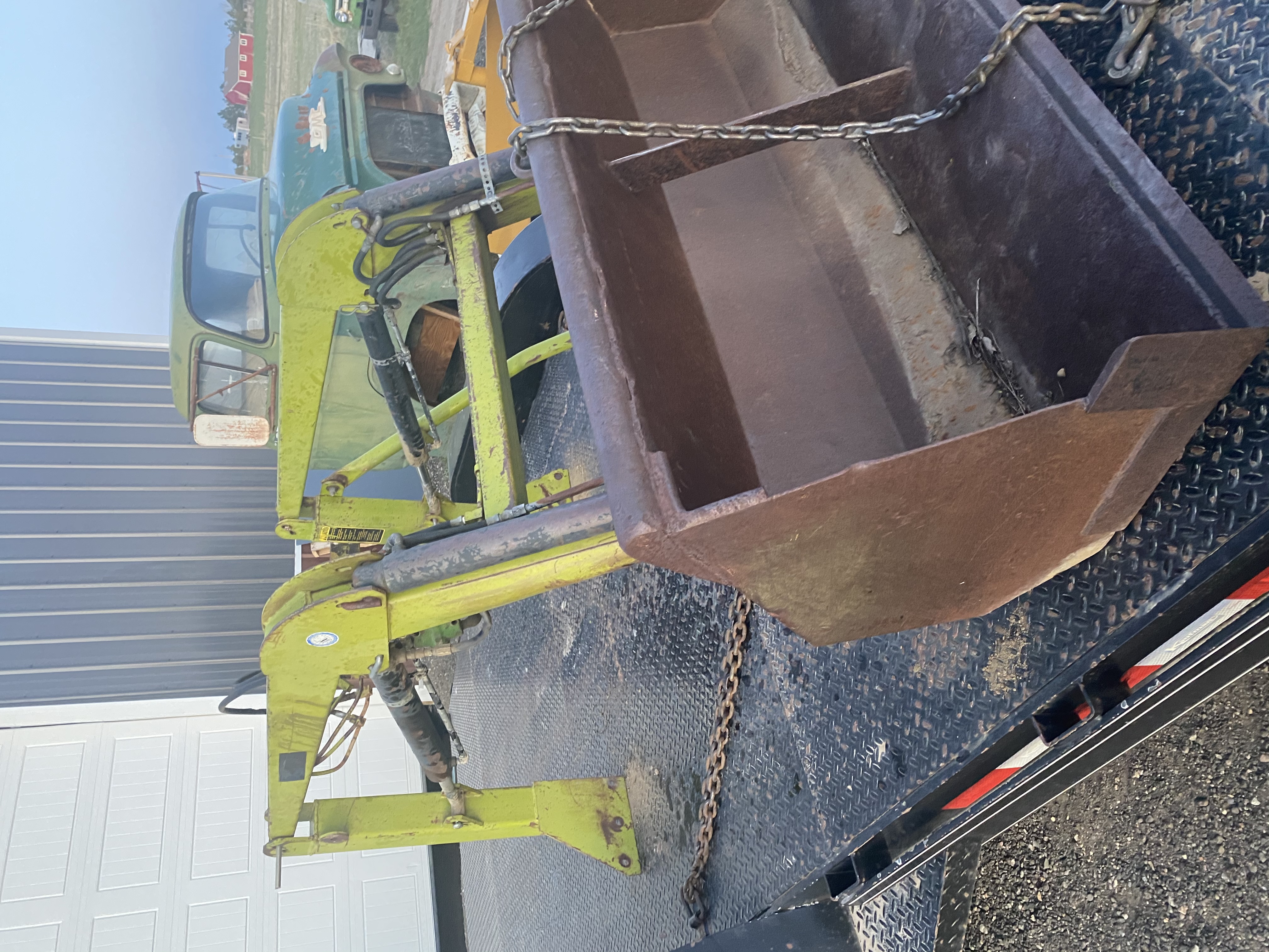

Here are some additional photos.
It looks like I知 missing the main brackets that mount to the tractor :(

I vaguely remember a 'Johnson Workhorse' loader mentioned here or in a Craigslist ad. That looks to be comparable to the Yanmar YFL loader, and to my Great Bend loader. You definitely have a heavier bucket.

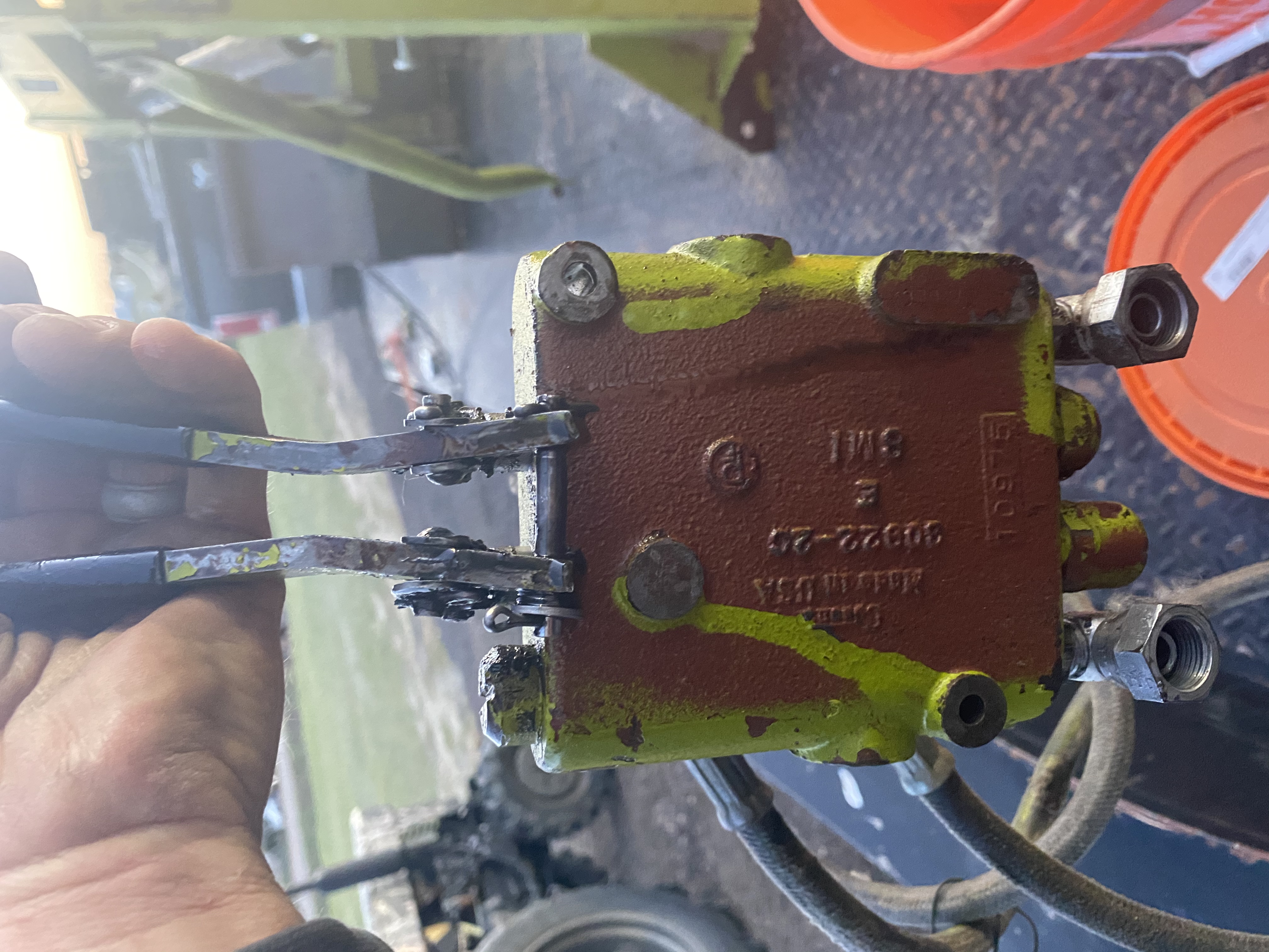

My hoses look as least as shabby as that but in near 20 years I've only had to replace a couple due to seepage, and a couple more up front after I ripped them off rasseling a downed apple tree. I wouldn't spend any money on hoses, or rebuilding cylinders, until after a few days use to appraise what needs attention. That control valve looks a lot better than what was on mine when I bought it. I eventually replaced it after I lifted a 650 lb tank and the control dribbled on my foot. Missing pins, and structure? Looks like you have some work to do for those. Incidentally that loader control might mount upside down like this replacement control I eventually installed so check this before building a mount!

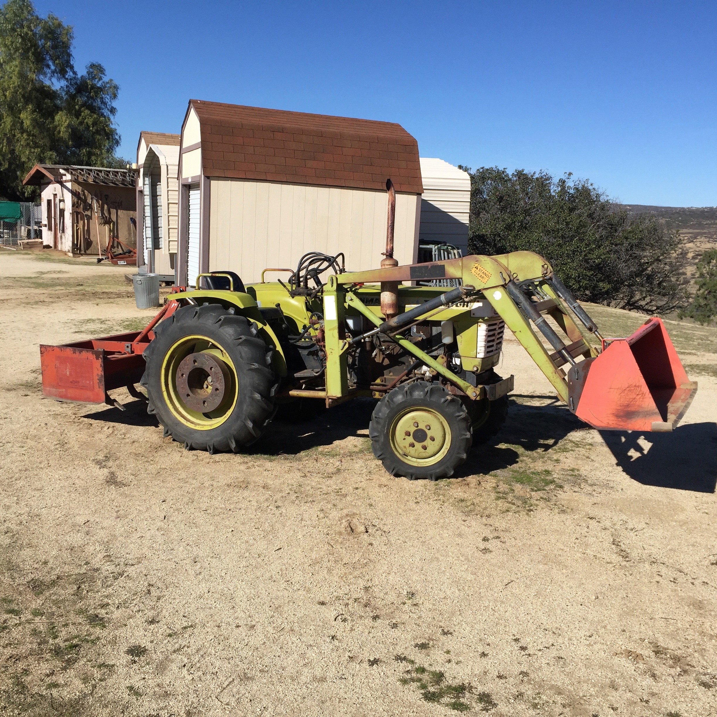

A couple of pix from an old CL ad. Might be identical to your loader?
https://www.tractorbynet.com/forums/files/yanmar/62112d1159821508-pics-my-240d-ym240d-3-jpg
https://www.tractorbynet.com/forums/files/yanmar/62111d1159821498-pics-my-240d-ym240d-2-jpg

That is the Johnson Workhorse loader, built by Arps (now Ameriquip) and marketed by Yanmar as the YFL240.
No parts are available for it. But cylinder and valve seals are pretty much standard.

Now my goal is to find photos of how the subframe is built. Looks like I’ll have to build my own since this one is missing.
I’ll need to research the control setup as well.
The actual valves for operation was provided in a bucket with a few additional hoses (pictures above) but there is a whole other block attached to the loader currently with only 2 open ports with quick connects on it.
It almost appears the previous owner added provisions for aux hydraulics.

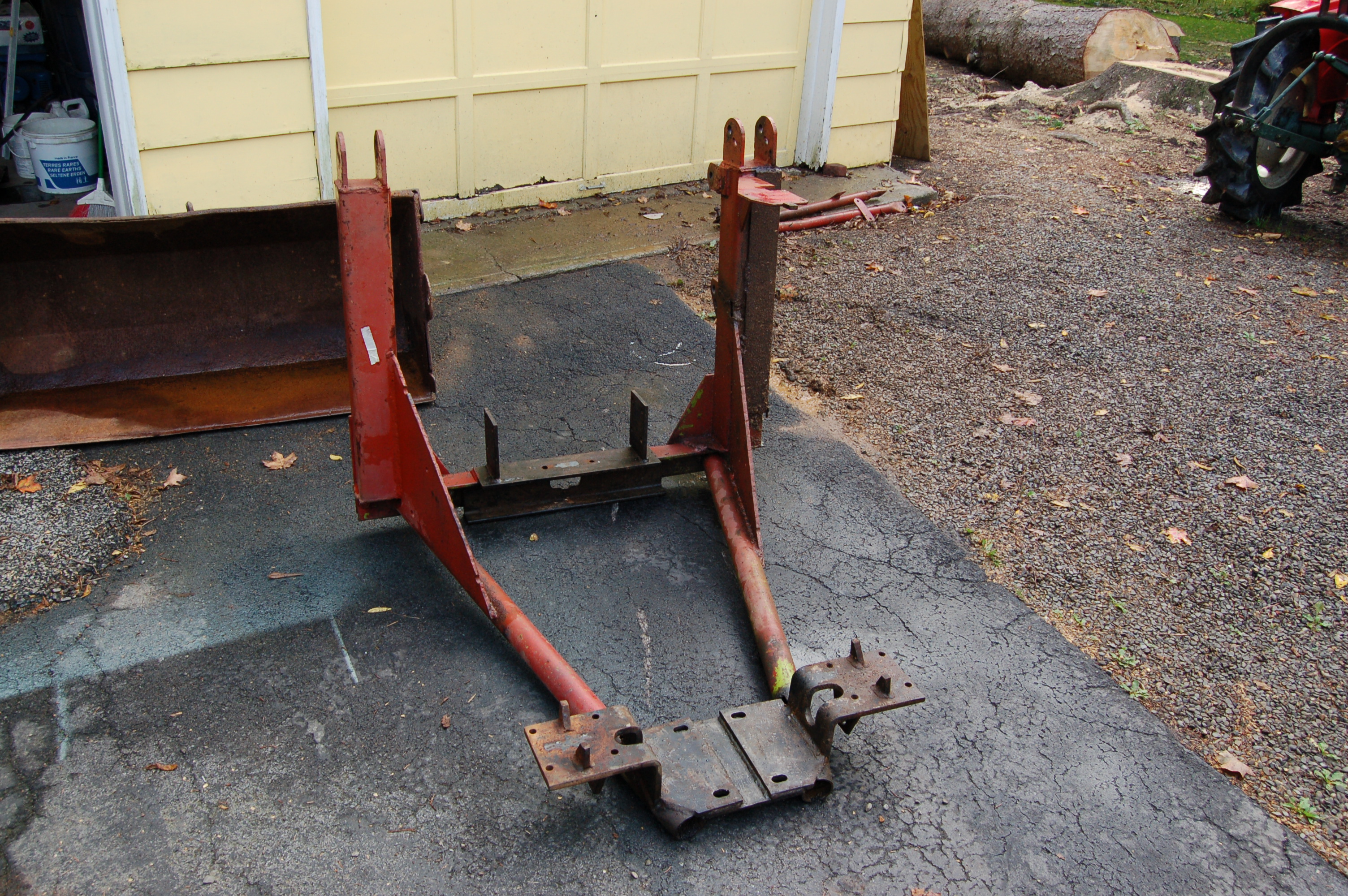

Here's what one frame would look like. The two plates between the upright tubes connect to the 4 bolt holes you posted pictures of. The rear plates bolted to the rear axles.
/ Johnson workhorse loader ID?
#12
Nice! That痴 an excellent perspective!
Looks like the rear Mount utilizes both the drag bar frame holes as well as fender mounts under the axle.
That痴 a good lead.
The center support structure is tricky. Looks like I壇 up need to remove the front driveshaft to install that. I was laying under there staring at it all trying to wrap my head around how I can utilize the empty bolt holes under the trans as well the 4 on each side I pictures, while still making it removable.
This setup looks like once it痴 on, it痴 on. Not that I知 opposed to that.

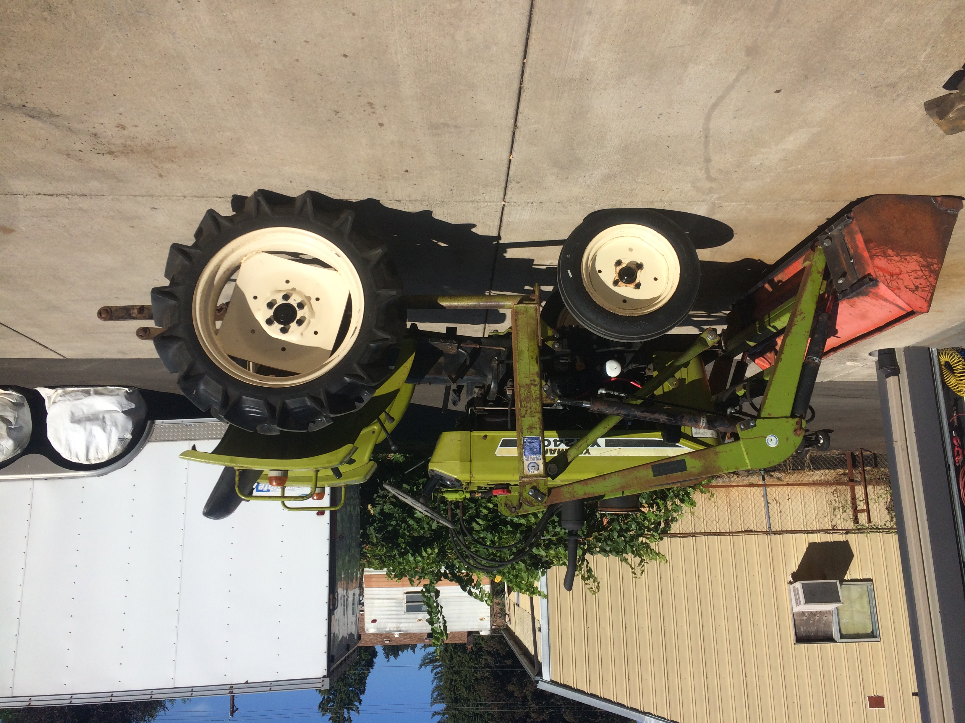

Here's the photo again that I linked to in your other thread.
20688d1078893027-building-frontend-loader-ym2000-388519-dscn4220r-jpg
And here's a photo showing the front end of those bars. (I originally posted this to illustrate the 'old man step' that I added.)

Your setup is the best I can come up with. Utilizing the draw bar mounting point.
My plan was to build a plate that goes between the dig case and draw bar bracket and through bolt it using longer bolts.
What I don稚 quite understand is why a simple 1/2 bar oriented vertical is sufficient to 1) support the loader and transferring the force to the rear axle and 2) vertically support the machine in its entirety while carrying a load at capacity in the bucket.
I知 going to step that up to either heavy gauge angle iron, or 2x4x3/16 tube.

First time I noticed this post. This is mine on my 240D. Looks like yours has a way heavier bucket.IMG_1688.jpeg

First time I noticed this post. This is mine on my 240D. Looks like yours has a way heavier bucket.View attachment 655418
This bucket has been modified. They added a different cutting edge that extends up the sides a bit, and added some tube across the top to reinforce it. They have hooks on the back so I suspect they were lifting things with it.
