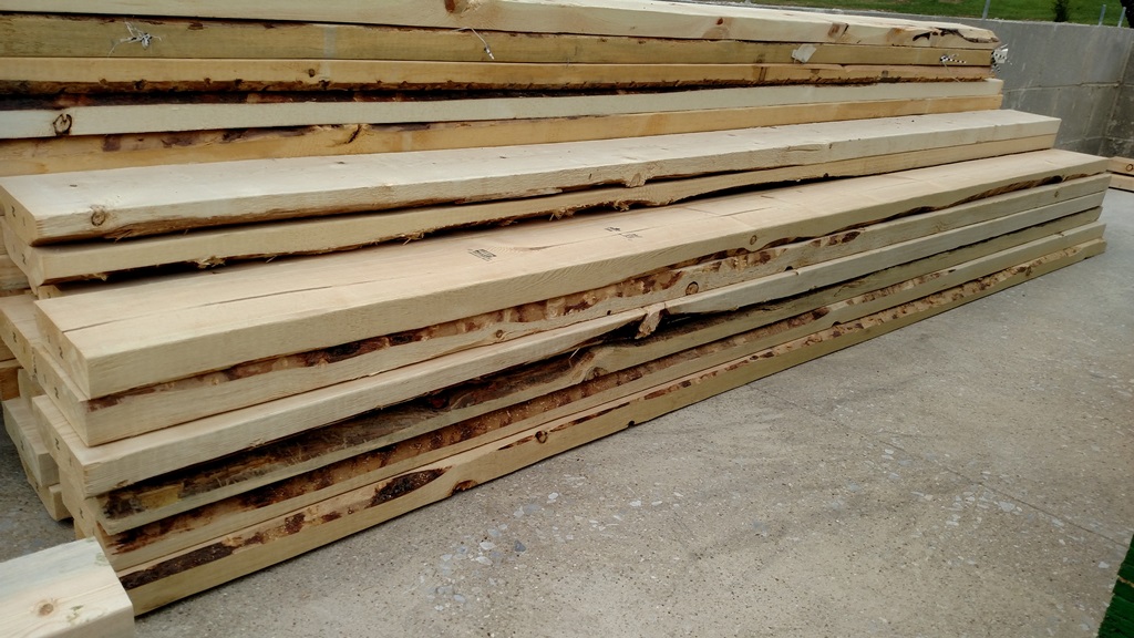

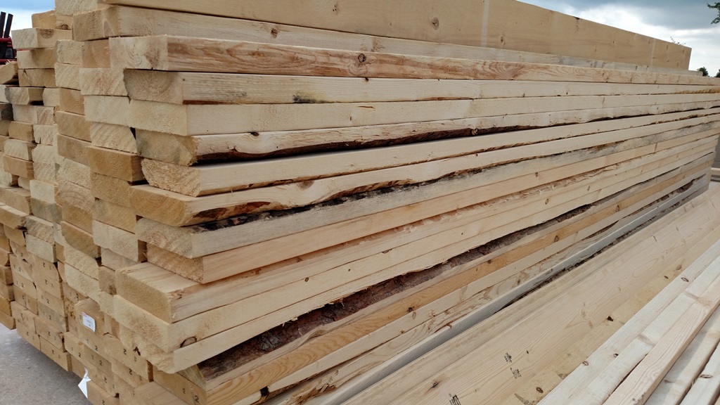

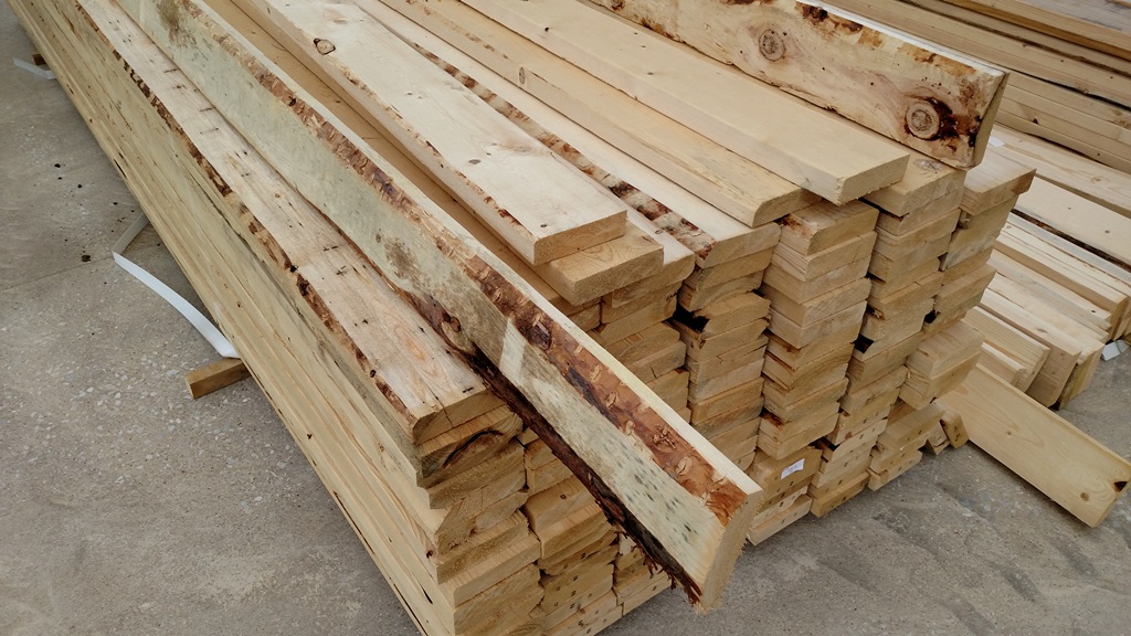

Got my delivery of lumber yesterday and wanted to get started building today. I think thats going on hold now.
Here are some pictures of the 2x6's I got. Just terrible quality.
IMG_20150530_095410897.jpgIMG_20150530_095432783.jpgIMG_20150530_095510496.jpgIMG_20150530_095709370.jpg
Out of about 200 2x6's I got, I bet I'd be lucky to find 20 that didnt have a rounded or bark edge. And probably 50% of them have less than 1/2 the width on the stud face. Dont do any favors trying to nail sheething on, especially if It happens to be a stud where there is a seam and 2 sheets need nailed to it.
I called the place back where I got them from, they were not as helpful as I would have liked. They offered to pick them back up and offer a full refund, but I still need lumber. They said all their framing lumber is going to be like that, and they will have a manager call me on monday to see if they can work something out and possibly hand pick some better boards for me.
Look at the pictures. What would you guys do? am I over-reacting? I dont want to be fighting crap lumber this whole project. When I buy a 2x6, is it too much to ask to get an actual 2x6? instead of lumber that you could hardly make a good 2x4 out of?

That all looks like low grade number 2 boards. Did you pay for the good stuff or just whatever was cheapest? I've found that of the different suppliers I have available, I'm getting the nicest boards from Lowes right now. This seems to change every couple of years, so it's always a good idea to go see what everyone has and what they are charging. For whatever reason, they seem to rotate suppliers or go up and down with what their standards are for what they will sell. The box stores only carry one grade of lumber unless you are special ordering it, but the lumber yards have the good and the bad, you have to tell them what you want and then be willing to pay for it.

Around here, #1 is just about cabinet grade, straight as an arrow, no knots, bark, etc., but every cabinet maker I know uses fir for the framing, not pine. #2 can be a bit rough for sure, I'd say all yours looks like #2. As far as I know, #1 is supposed to be knotless, no bark, mainly cut from the center of the tree, straight lumber. I've never really seen so much that looks as rough as you posted. But again, I'm spoiled for our good lumber. We ship a whole lot to Florida, but I don't think ours is shipped up your way much.

My new house and all of the out-buildings are all 2x6 construction and there is no way I would have accepted those.
You might show those pictures to a competing lumber yard and let them step up to the plate to make you a customer.

Wane: The curved edge where the bark was.
From:
Koltes Do It Best - Lumber grades
#2
Wane - 1/3 the thickness and 1/3 the width full length, or equivalent on each face, provided that wane not exceed 2/3 the thickness or 1/2 the width for up to 1/4 the length.
Looks like you got a load of wood right at the limit of #2 standards. I didn't realize that much wane was allowed.
