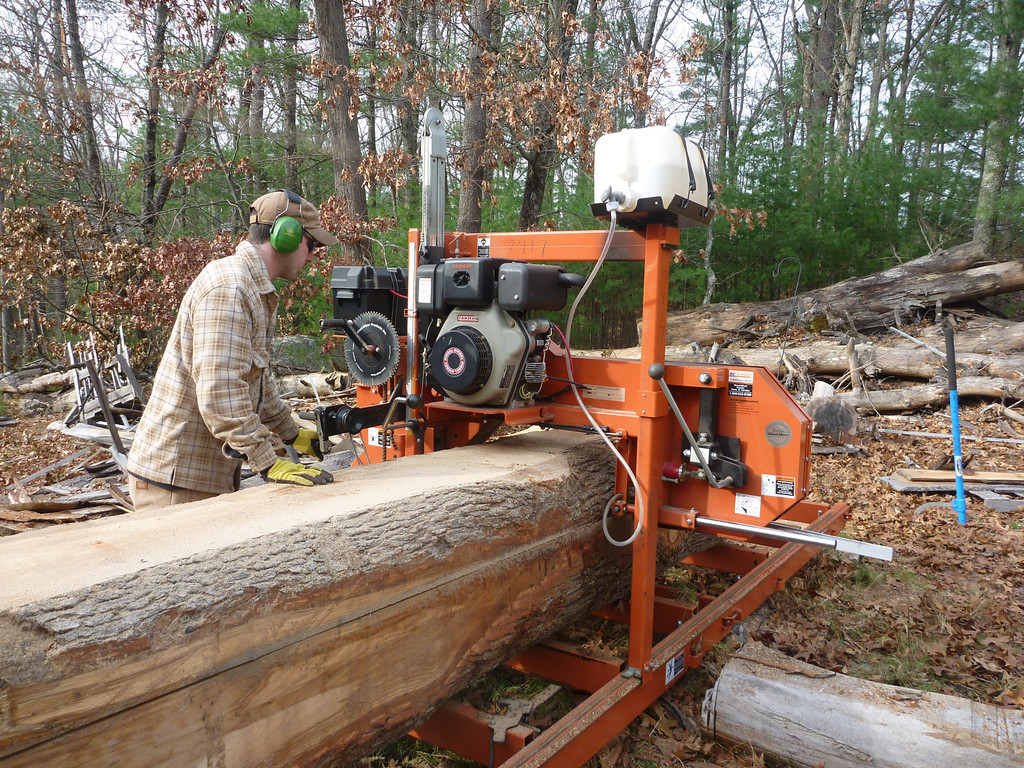

I would also send them back. There has to be someone will a mill around that could make you what you want. You could try contacting Woodmizer and Timberking as they keep a list of sawyers and will give you the contact info of local mills, usually portable.
I'm with Sawyer Rob, I make my own :D
