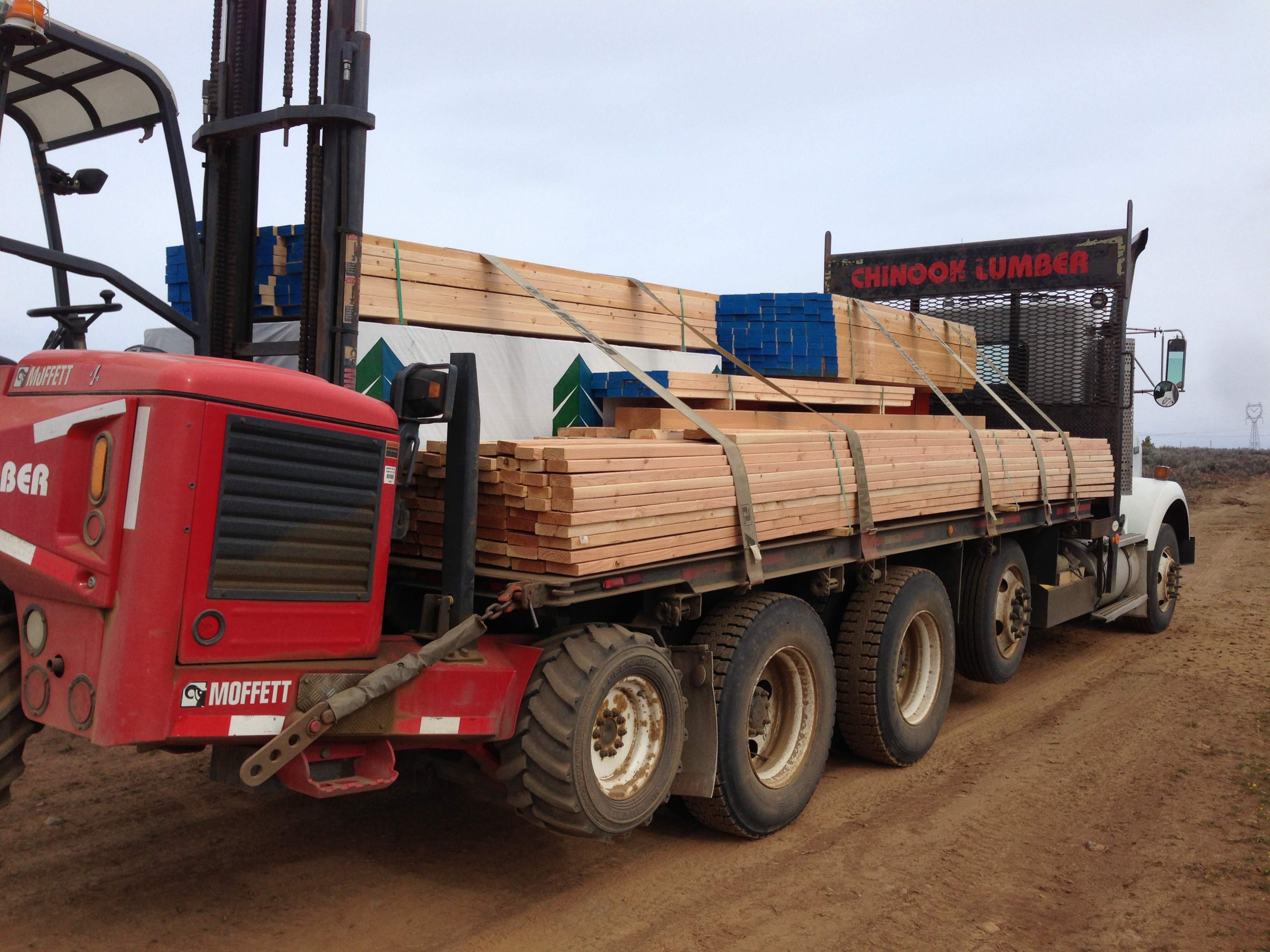

HD is the largest lumber purchaser in the US. I've been told a lot of the lumber problems with them have to do with swamp coolers and moisture when the lumber sits inside. Outdoor lumber yards are much better at letting the lumber adjust to the climate.
Other than this, the arguments are all preference most of the time. I've built 4 buildings including the house from lumber yards as well as HD, and have seen lumber yards fall short and boomerangs from HD.
For deliveries, I usually go with a lumber yard (Chinook or Pro Build), for smaller jobs, I just hand-pick lumber or call ahead and have it ready and bundled for me at HD (telling them what quality I want).
