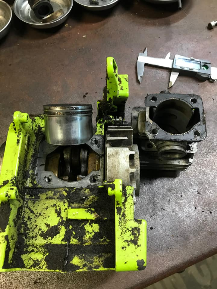

Just showing how I check bore sizes before pulling cylinder off. Makes it easier that way. So I know which to pull with right mm bores needed.
Out of 4, 2 were good 2 were score and only 1 was right mm wanted. Of the 2 good ones.

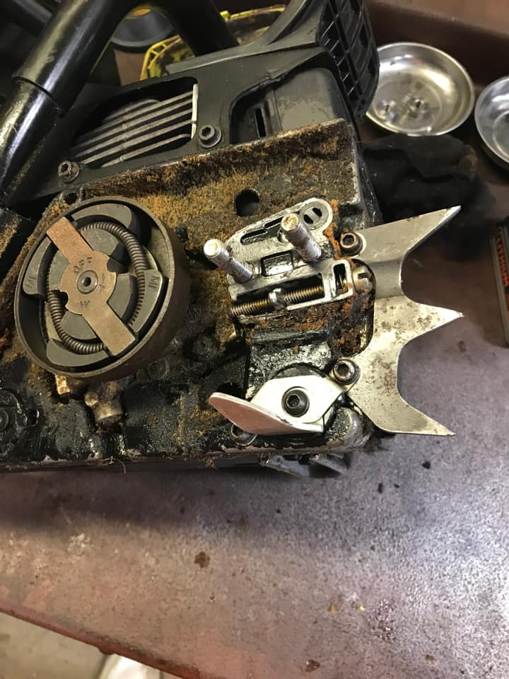

Husky 455. Not cut through, but close on spur. Also aftermarket decomp just almost cost him a saw topend.

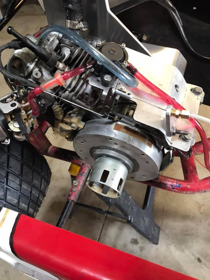

Fixing carb for sons kart.
Notice my added touch with old style 372 starter handle. Cheap oem plastic broke and then hit kill switch breaking it too.
