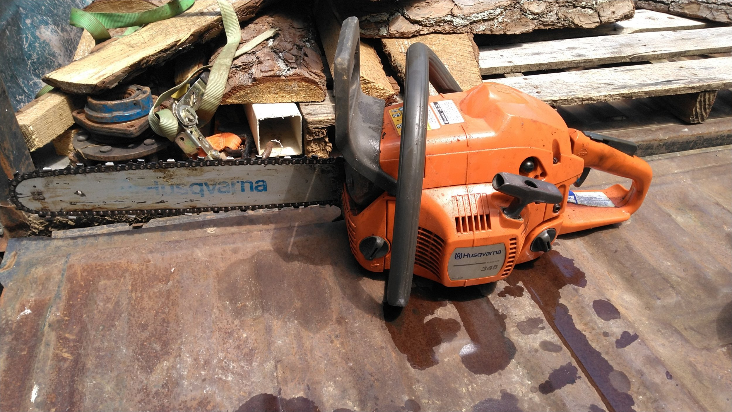

I was at our local refuse center at the beginning of the summer and just so happened to look into the metal recycling dumpster and there sat this nice looking Husky 345. I ever so subtly grabbed it out of the dumpster and took it home. To my surprise I put a little gas in it and it fired right up!! It had a gas leak so I figured I'd take it to my saw guy to give it a once over. He replaced the junky plastic intake for a metal one and a few other things, ended up costing me $100. HOW'S THAT FOR ANOTHER JUNK CHAINSAW?

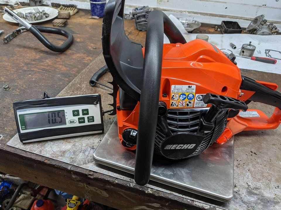

There's a brand new 490 close in box for 190. But I wont even look being I know I can get a 4910 300ish.
Super nice and light too. All of them in that size.

Checking out the 4910 and some others yesterday at the local makita echo efco dealer.
Picked up some maddog files being my saveedge no longer doing chainsaw files since cv19. They cant get blanks in to cut local.

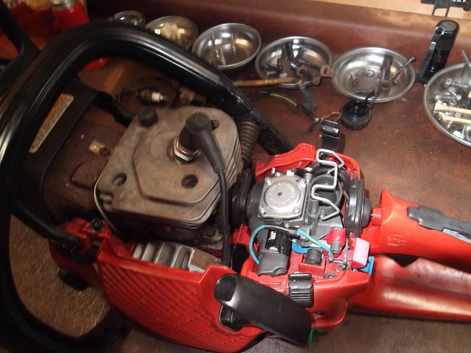

Pulling crank case halves for folks. For 3 saws. The mess at the end.
2 fly side for 3750 x 2 and 1 pto side for a 3000. Not all in pics.

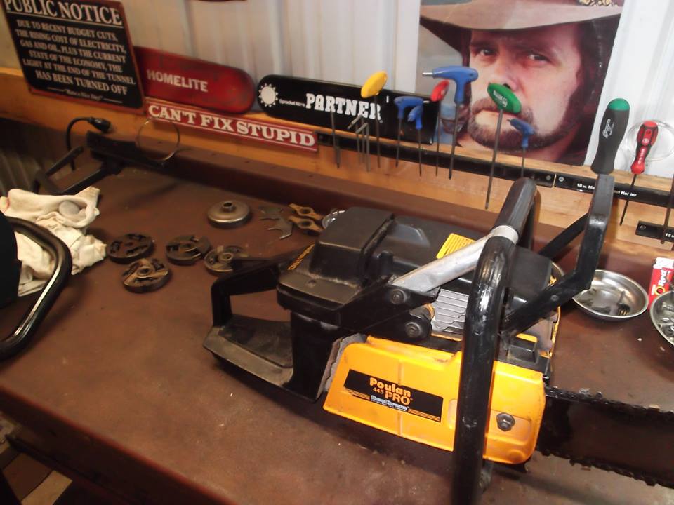

I may of finally got my first true parts saw out of all of these I been getting.
Little chrome bore poulan in 54cc that will cut with or out cut the more expensive brands. For 1/4 of the money. They are built alot like the stihl 034.
This one come to me from MI when guy grove done to by the woods ported 3120 and bunch of bars and chains.
He stated it came with a bunch of saws he got and has been setting for 2 years. So it was past onto me.
Scuffing had started on piston and cylinder which is no biggie for me. Found the cheap line for impulse had slipped off.
Lot of wrong fasteners and where muffler leaked with different bolts too.
The pro side had JB on it and appears almost like it had cut [alms at one time.
So thats where I stopped for now.

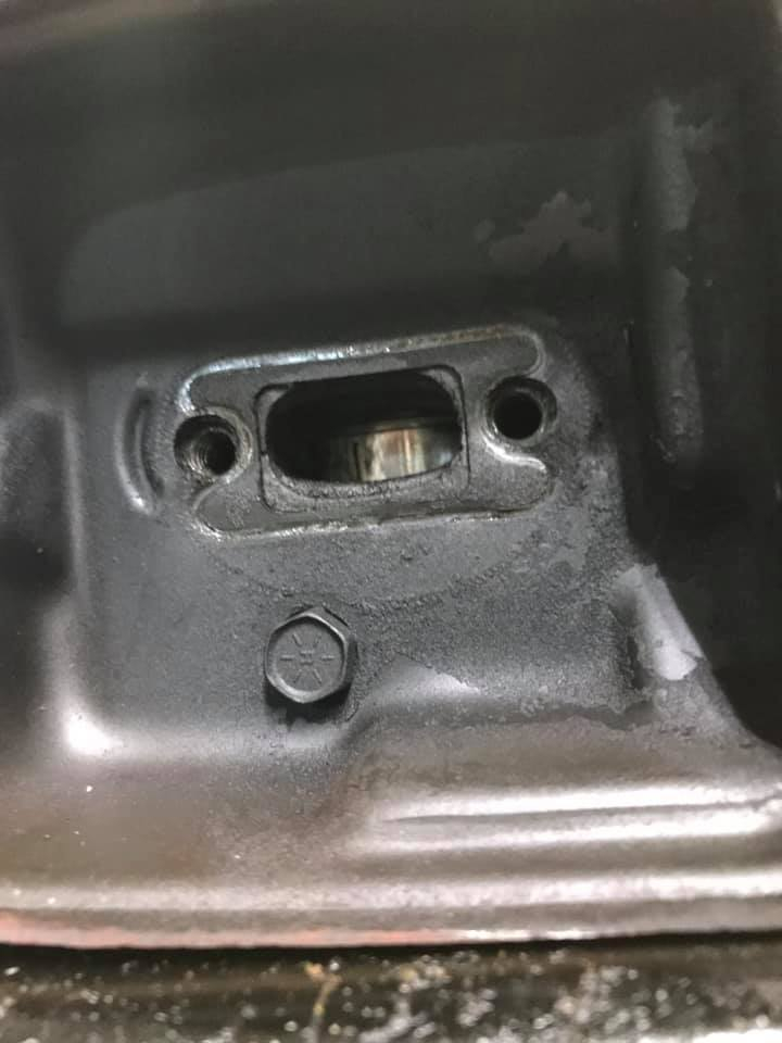

While grilling yesterday I disappeared into barn to see what was under the JB.
Curiosity how bad it was killing me to know.
Digging JB out I found 2 pin holes but none into the crankcase. Parts she is.
Someones only saw yes it could be used. But not really needed here in that shape. Cutting palms does this in the south. How it happen here no clue. Came from a guy in MI.
