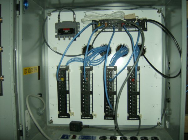

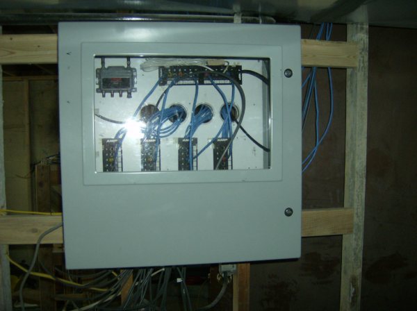

I also ran my network this weekend. I took Friday off, and my BIL came up from Utah to help out. He had some pretty good ideas and donated some materials to the cause. I have pictures of the network too that I'll post when I win the argument with my camera phone. We ran over 2,000 feet of cable between Coax and Cat. 6.
One of the better ideas, I think, was to wire the phone into a network block instead of a 110 block. I have 3 ports of the 12 port block wired together, and the other 9 are wired together. This allows me to bring the unfiltered signal into one of the 3 and out another to the DSL modem. The third port has a DSL filter attached which then plugs into one of the 9.
The Cat. 6 lines coming in from the house are all wired into four 12 port blocks on the bottom of the panel. Some are wired for phone on the other end, and some are wired for ethernet. I can run a short rj45 cable from any of the 9 connected phone ports to any of the ports on the bottom 4 blocks to send a filtered signal anywhere in the house I want. I can even send a phone signal to an ethernet port in the dining room, etc. if I want. The rj11 male phone jacks do plug into an RJ45 female ethernet jack and it works.
I'm pleased with the end result. I only have one computer right now that is wired, and everything else is wireless. The whole exercise of running the network was to create some flexibility for future expansion. The system as it is set up is definately flexible.

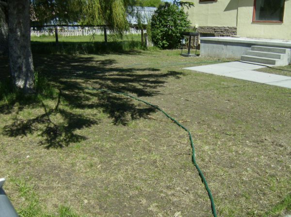

The first picture is of the grass. This is about a month post planting.
The second picture is the network box.
The third is of the inside of the network box.

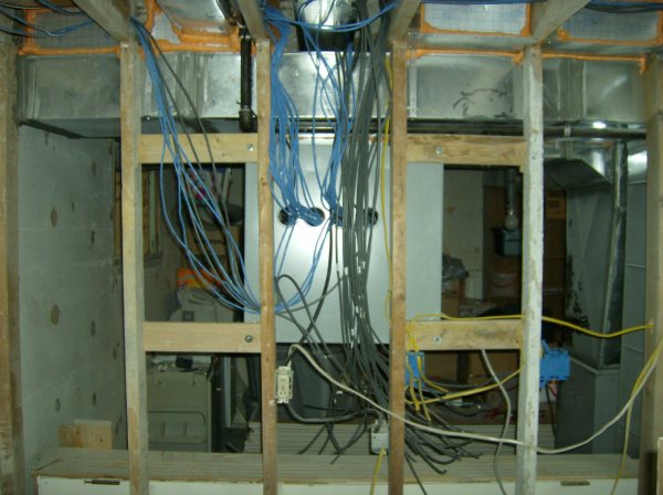

The fourth is the back of the network box showing the wires coming into it. The side of the wall visible in this picture is going to be sheetrocked, but the other side (the front of the box) will remain unfinished.

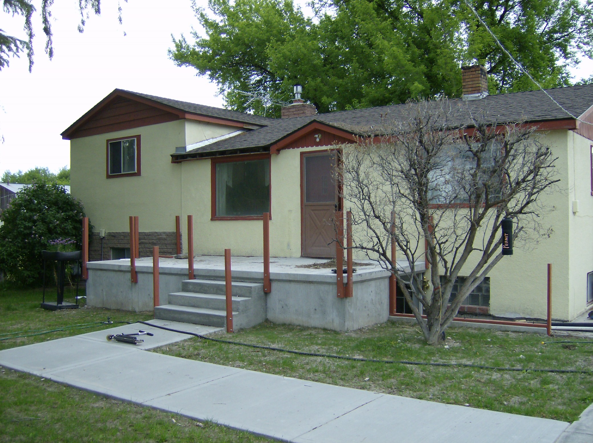

Here's a picture of the porch so far.

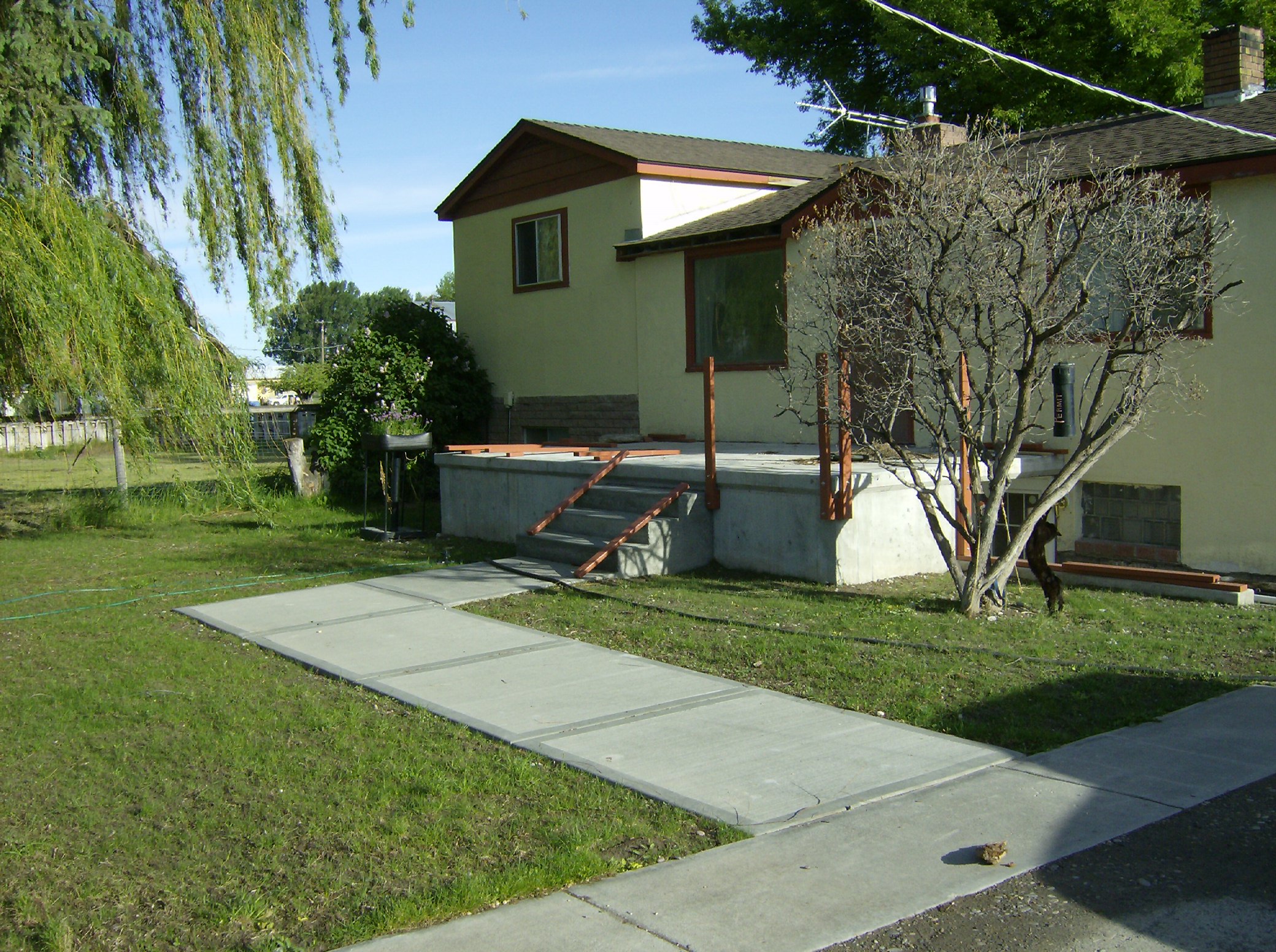

More progress on the porch. These are all of the boards that we have painted for now. Next is to measure off of what's already up and cut out rails and stiles for the rest of the railing.
It's starting to look more like the sketch...
