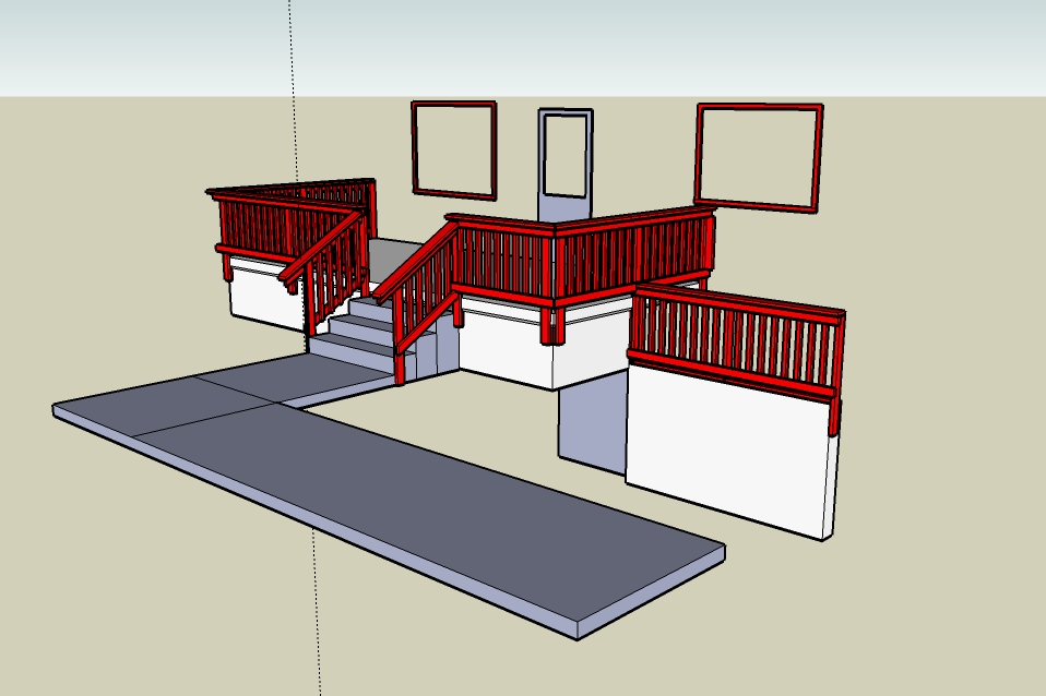

Planted grass today. I'm hoping to get the porch railing cut out this week so DW can paint it. She'll have a few weeks since I'm vacationing over Memorial Day.
Here's a conceptual drawing of the porch railing...

Should look good. Can't wait to see some pix after you get it done.

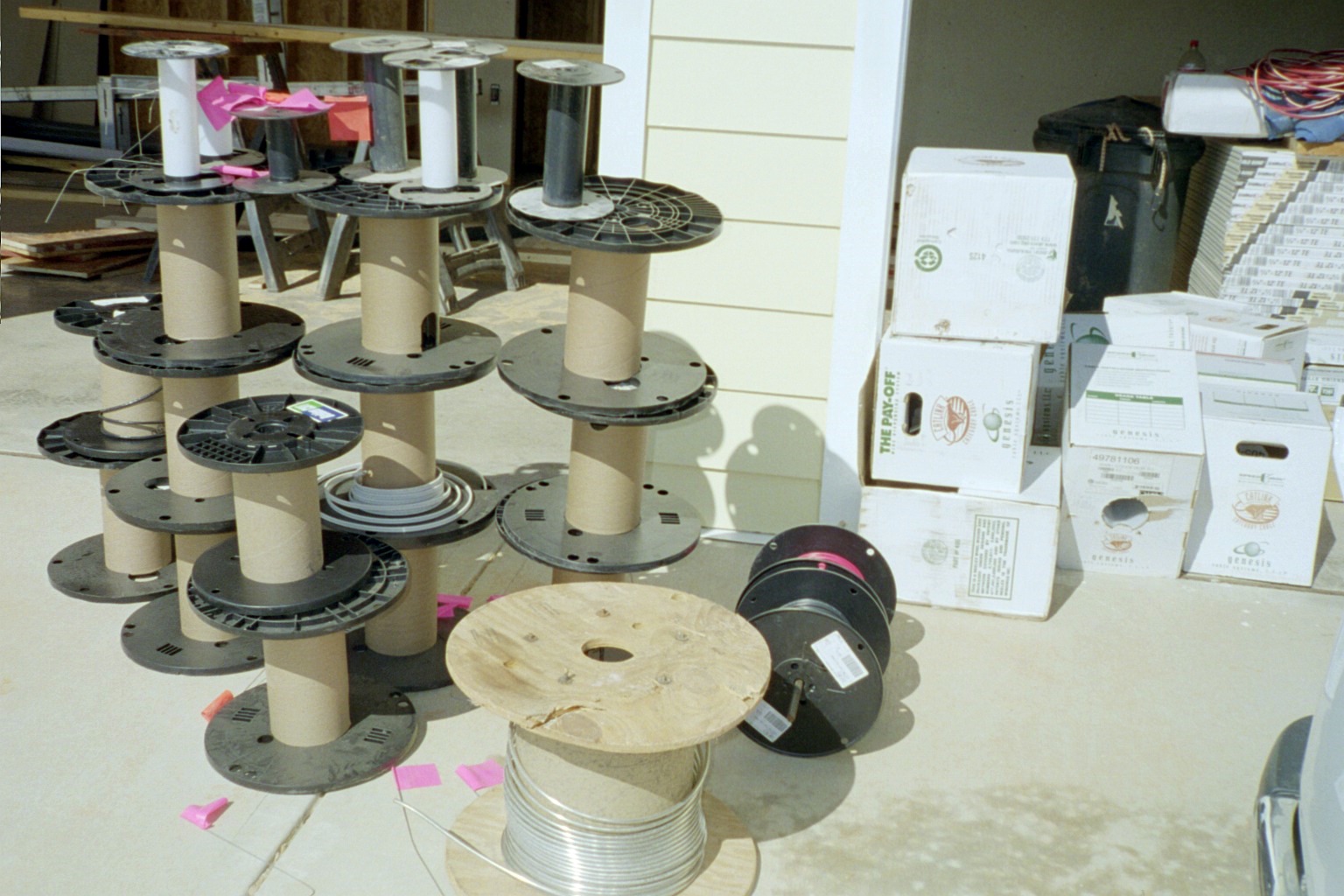

In the way to long post, I had a pix of some MT boxes. Here are the _other_ empty spools from the job :laughing:.
Pete
