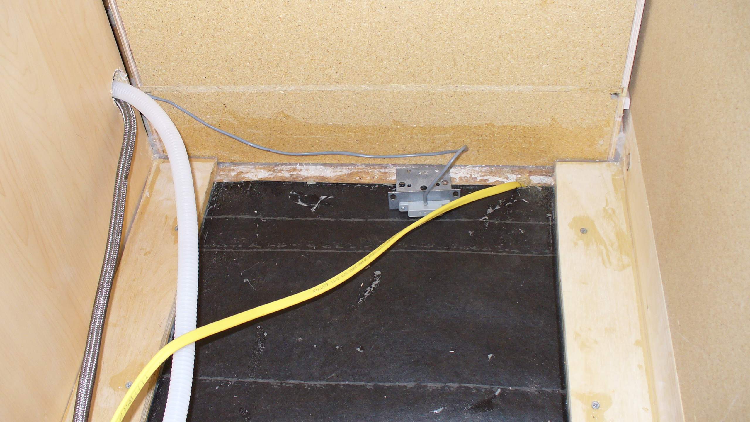

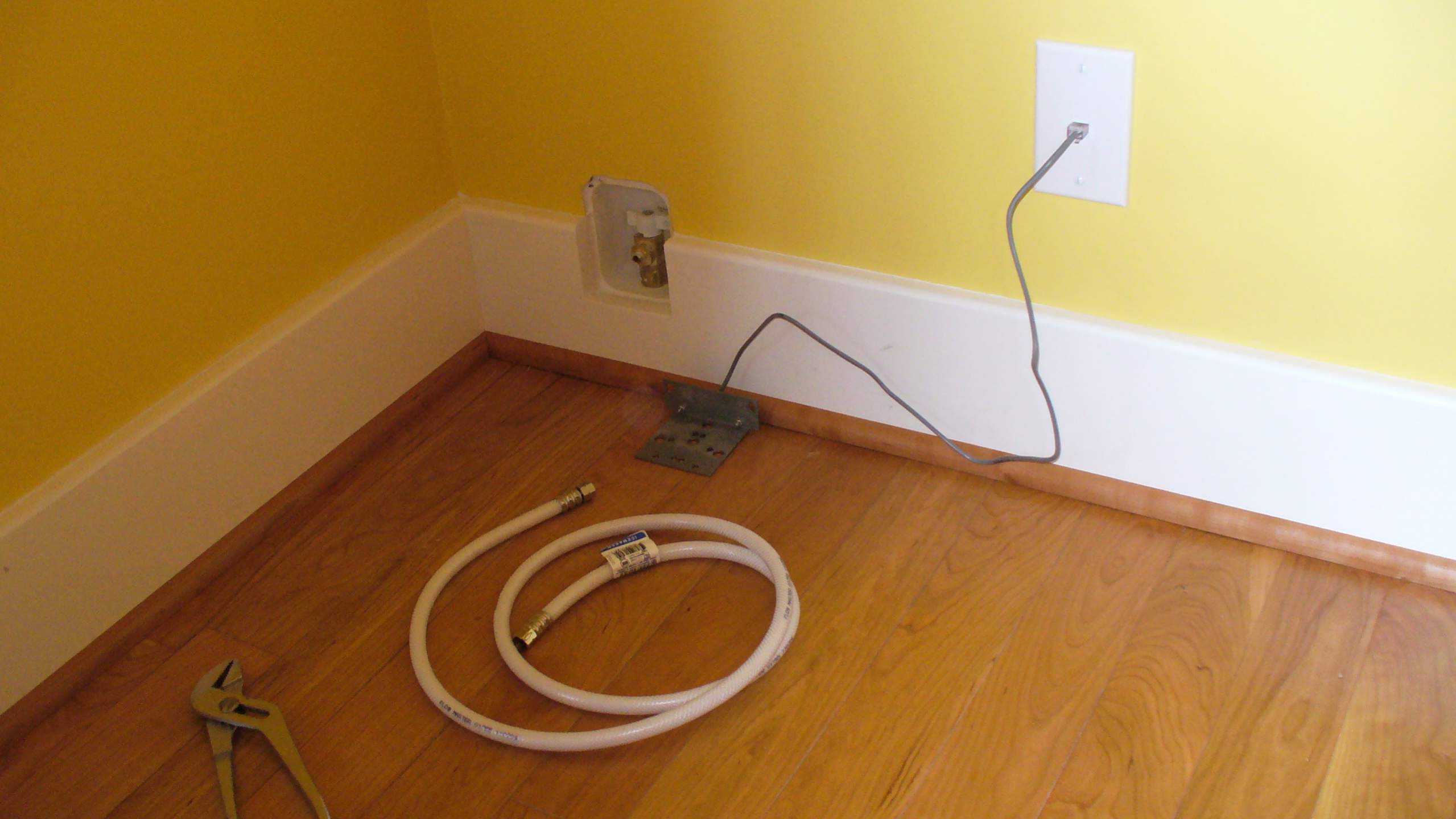

Another fun one is the water detector. Same "12V, contact closure" device. 1st pix is a detector in the hole that the dish washer will go in. If it leaks, an automation system can do something about it. The 2nd pix is the same idea behind the refrigerator. I also have RJ-45 jacks to cat5e by all toilets, the washing machines, and hot water heaters (which are in pans with drains too).
cat5e to the kitchen ceiling and garage ceiling. You can put in heat detectors for fire alarm stuff. Cat5e for control panels for an alarm system in the master bedroom and by the garage door.

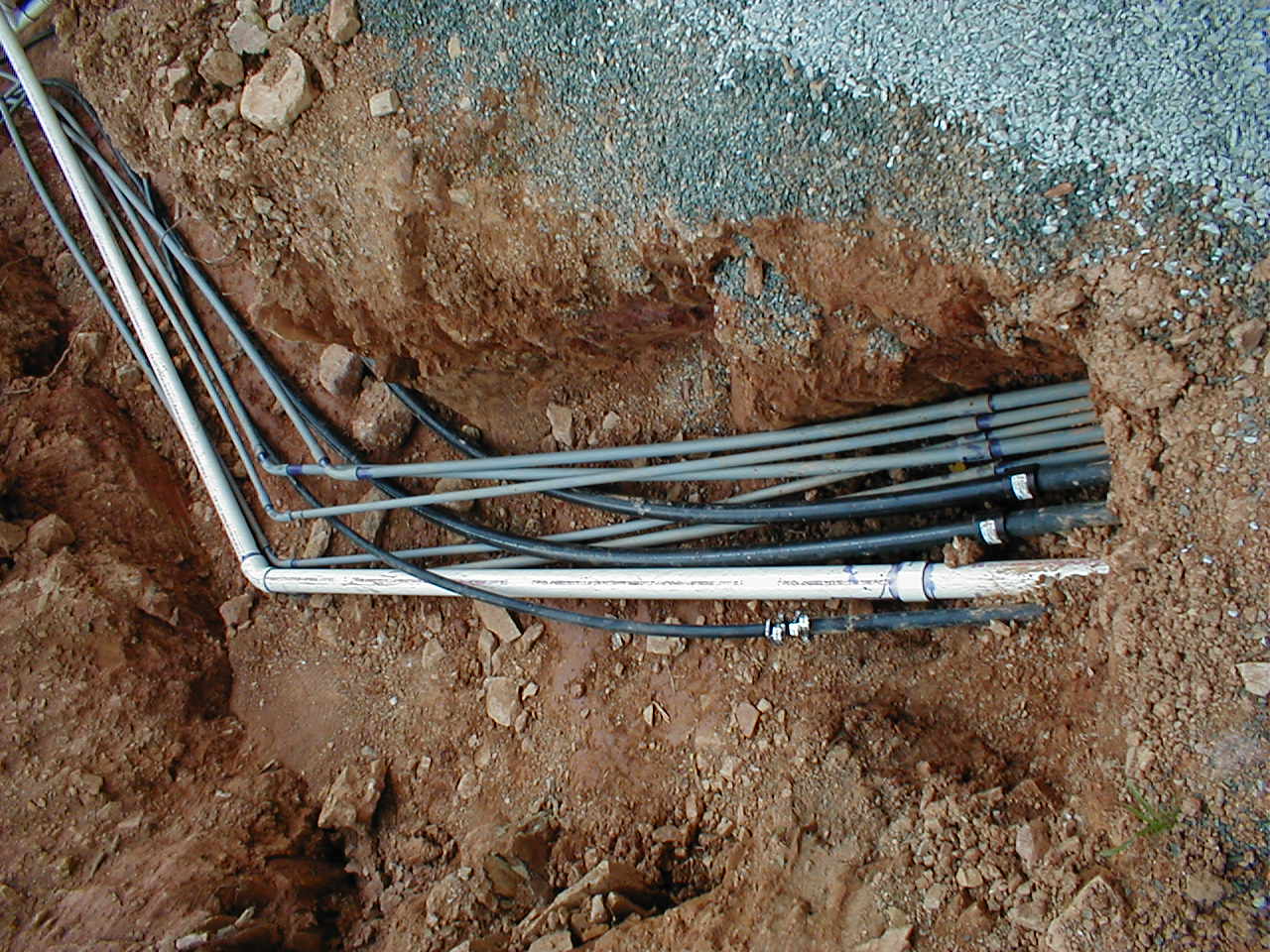

So the OP is bringing a house up to code, making some changes, etc. So much like new construction time, money and sanity are at a premium. A retrofit job on a house if often so expensive and traumatic that it doesn't happen. But if you are already tearing down drywall, it's a great time to run wires.

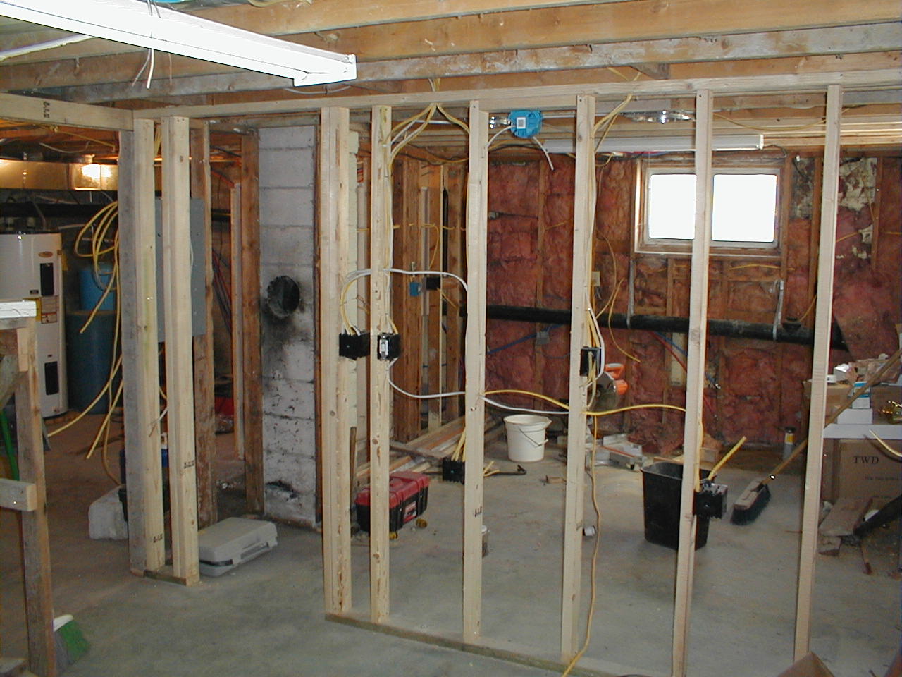

Get the 3 types of wire (cat5e, 18 gauge, quad shield coax). All the crimpers for the cat5e and coax are available in box stores and on line. Spend $600 for 6 boxes of wire and then you can pull what you want when you can. You don't have to terminate any of it until you're ready to use it or there are aesthetic problems staring at boxes with no cover plates on them. If you're hyper-frugal you can just buy a box or two and do more pulls of the same color wire.

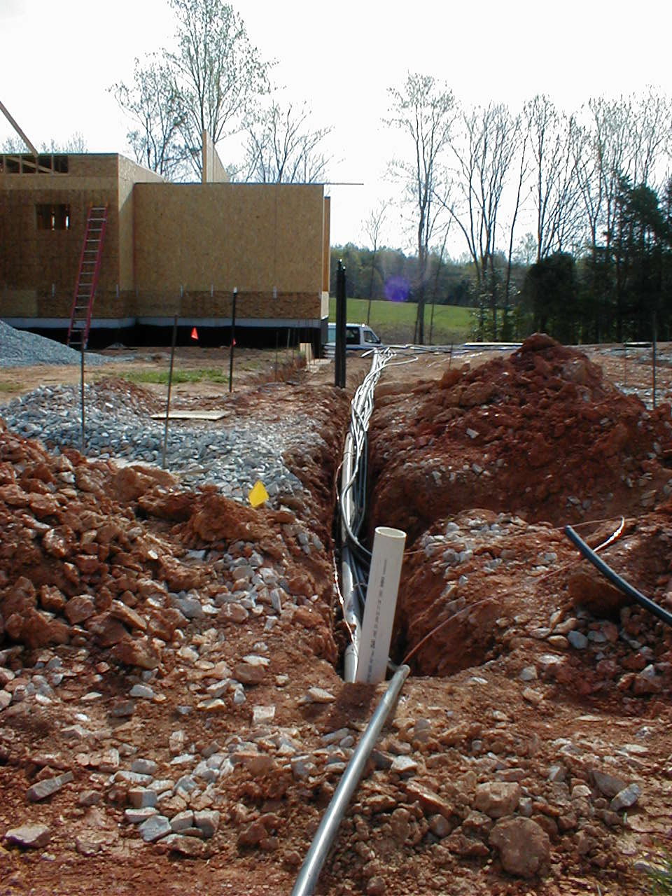

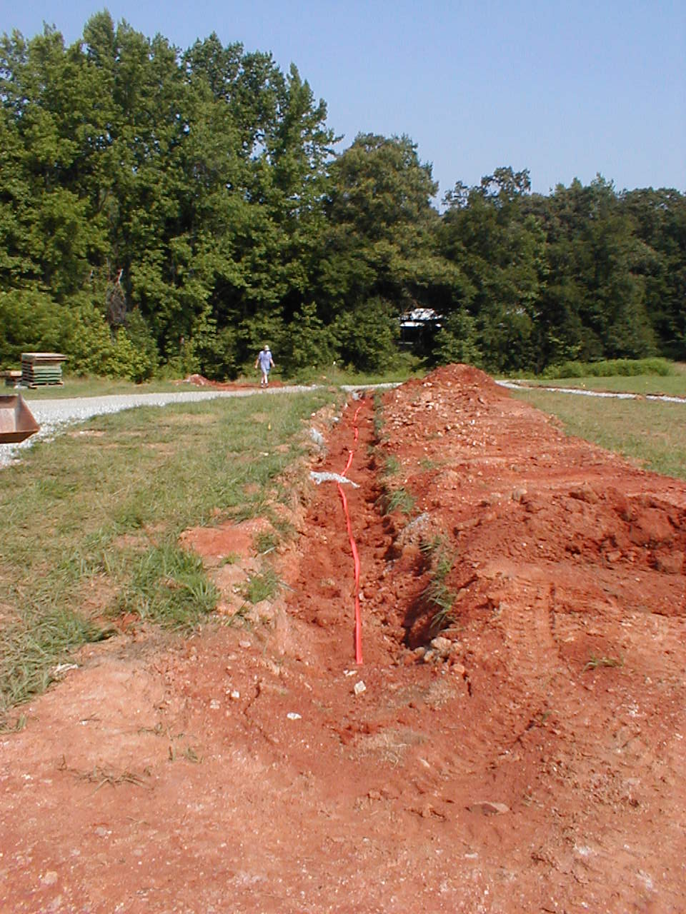

If you are doing any foundation or outside work, run conduit for buildings (power, low voltage, and water). See if you can run conduit out the driveway for that sensor. Note that you can use black PE pipe for this stuff. A 300' black PE run down the driveway is great for the driveway sensor. Every trench is an opportunity (see 1st pix). Don't forget the tape in each trench (see 2nd pix). You'd be amazed at how much stuff can end up in a trench (see 3rd pix). If you've got the outside of the house torn up, think about gutter drains too. I put in 4" smooth pvc that won't clog like the corrugated plastic stuff.
This is all good stuff. I'm really liking my soon to be done tractor garage having 100 amp service, water, house page, phone, security, lights, outlets, wifi hot spot and video surveillance.
Whenever a wire comes in from the outside, you'll need to put protection on it. Gas tube (like the telephone company uses) for low voltage, and spike protectors for AC. So where ever a conduit comes in from the outdoors, run a #6 bare copper wire for a ground point, and run that back to your breaker box. If you have the ground open, consider putting 100' or so of wire in there for a really good ground. I have 1200' of ground wire around the house and in trenches, but I also grounded my metal roof for lighting and as you may have guessed I'm no stranger to overkill.
Back to wiring. Put in what you can based on what you have access too. If you have that extra cat5e, you can use a pair on it for a speaker later. Find a spot in your basement for a 4x4 (or 4x8 if you can swing it) piece of 3.4" plywood. Bring your wires there. Put in small shelfs to hold stuff. I think there is enough here that you can find lots of wires you'll want to pull.

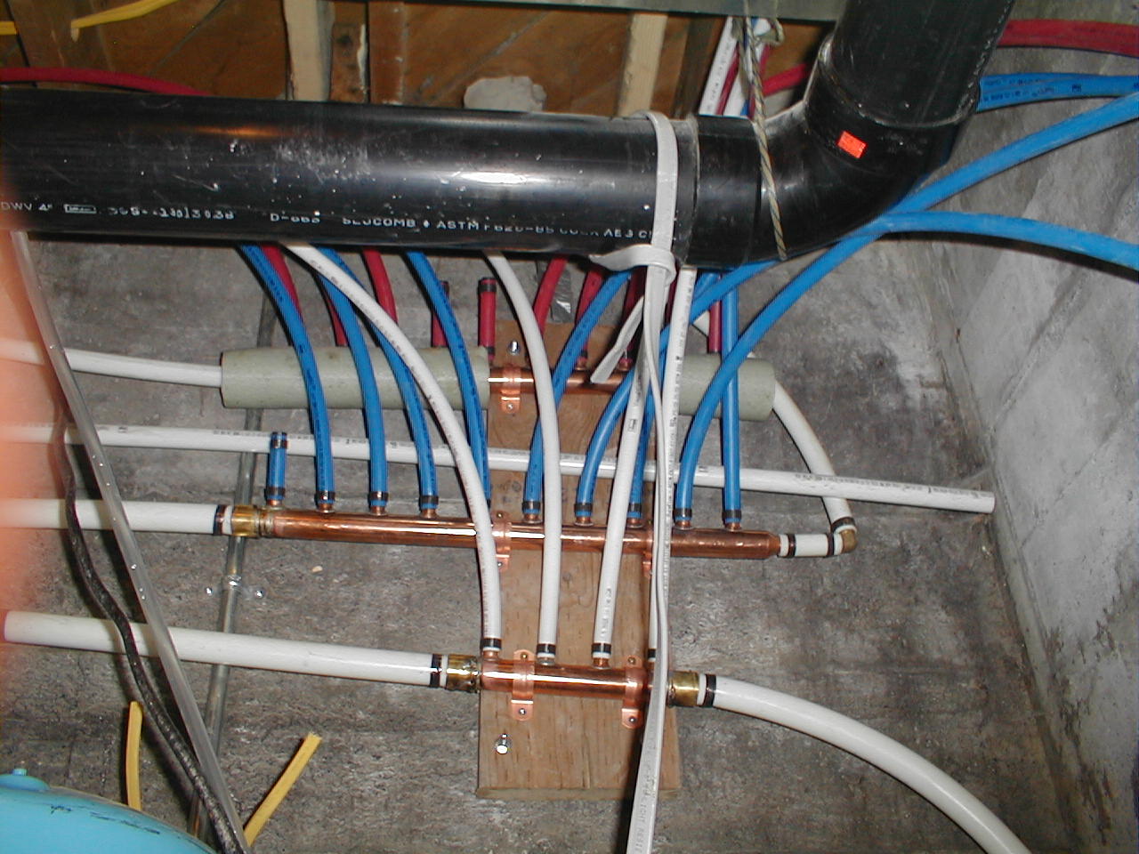

We have made some more progress.

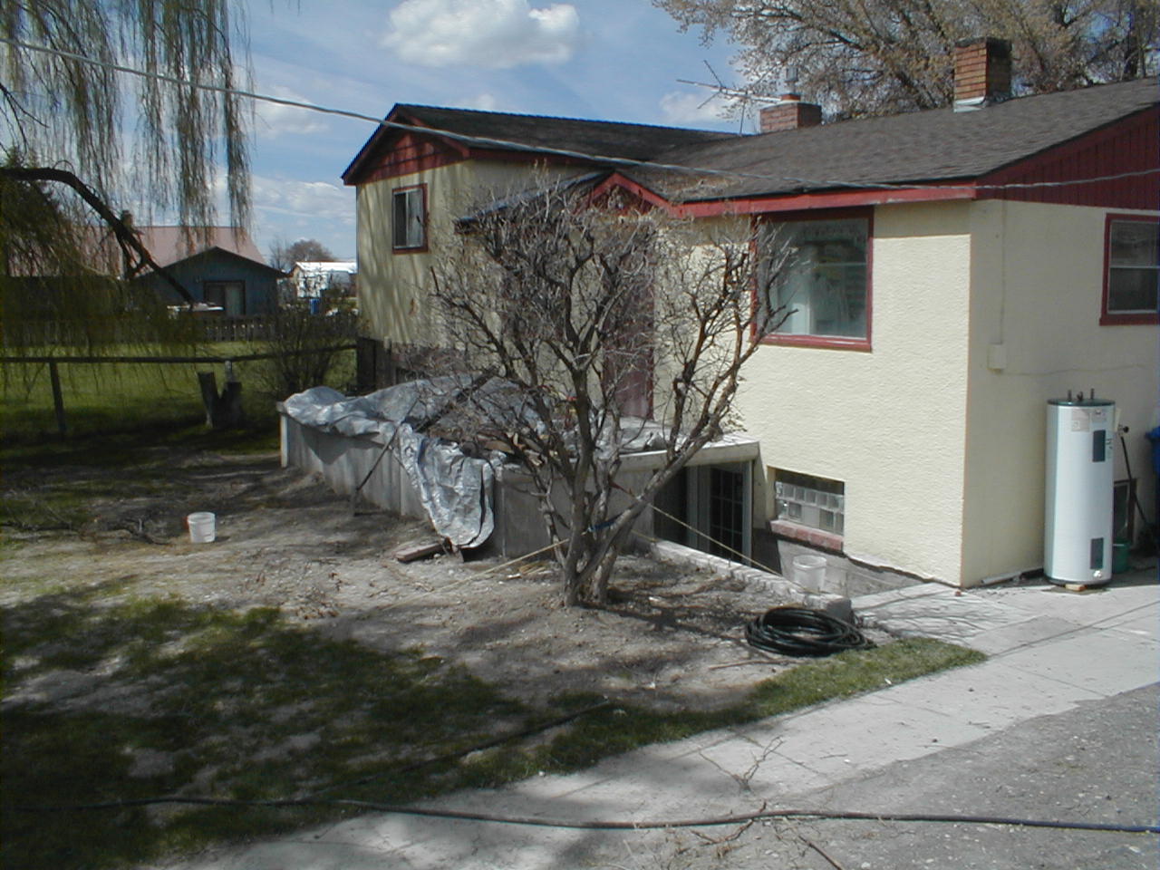

A neighboor came over with his son Friday after work. We got all of the old copper and galvanized water lines removed and new pex installed for the whole house. We worked from about 4:00 until about 10:00. I was pleased that we got it done in that amount of time. We ran new lines for two bathrooms, a kitchen, and a salon, plus the washer, dryer, two outside hydrants, and an icemaker. This also included moving the pump and pressure tank.
Saturday I took the old water heater and water lines out of the house. We also re-planted the lilac tree that they dug out when they put in the stairs. In the picture it looks like the bush is under the power line, but it's about a foot and a half to the other side of it.
The pictures below are the new home of the lilac bush, the inside of what will be the water utility closet, the Pex manifolds, and a shot of the framing and electrical from a previous post.
