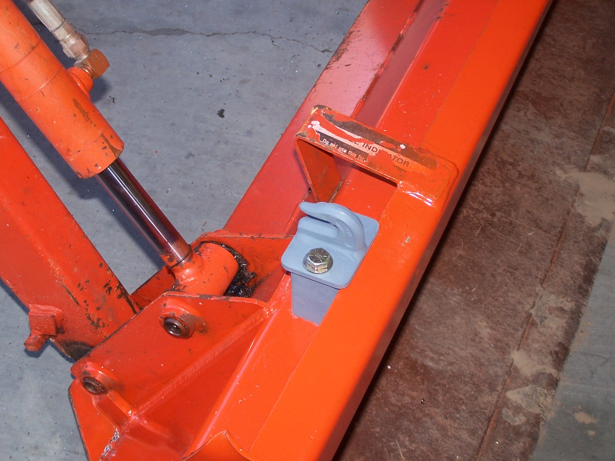

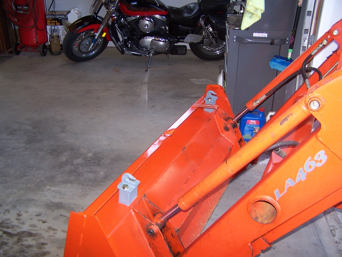

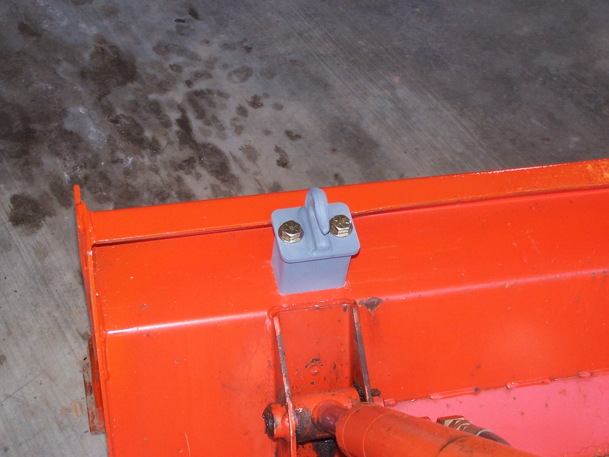

My hooks arrived today! The installation took about 1 hour. The critical step (for a Kubota installation at least) is where you use the 3/8" bit with the drill guide to mark the holes on the bucket. My first hook went on just fine, the second one took a few "field adjustments" to get it to line up properly. Pics attached, all I need to do now is wait for a warm day to paint the hooks. Thanks Ken!
View attachment 370812 View attachment 370813View attachment 370814View attachment 370815
Was that spacer height a standard length for you bucket model or did you provide the actual measurement yourself? Either way, it looks like the factory lip will support it if it becomes overloaded.

Nice setup. I ordered three of the same hooks from Ken for my B7500 which has the same style bucket as yours. Just wondering why you didn't go with the third center hook? Wondering if I should put the third hook on the center of my BX24 for some good reason. By the way, thanks for posting the photos. Reassuring to me that I made the right choice.
I gave Ken the measurements when I placed the order.

I thought about one in the center, but that is the weakest point of the bucket and, knowing me, I would try lifting something too heavy! 19 motorcycles! Wow, I'm jealous. I love spending time on my bike, rode to Key West with some friends a few years ago. I want to ride out west some day before I'm too old!

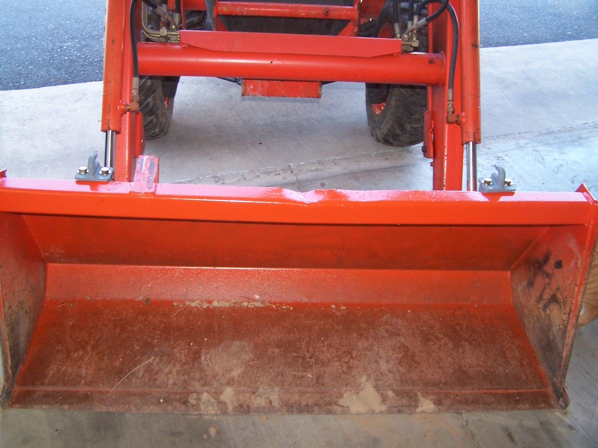

Here are my Ken's Bolt On Hooks...freshly, mounted and ready to work!
The shackles still interfere with the nuts slightly, even though I cut the bolts off flush...I imagine they'll wear in and develop their own groove with a little time and work.
If not, maybe I'll get a slightly, smaller shackle...
I know....my bucket's too clean...gimme a break...all I've moved is snow so far!:D

Thanks for the photos. Helpful to see what they really look like. I have three sets on order and can't decide whether to go with my BX24 or my B7500. Leaning toward one on the BX24 because the center is well supported and two on the B7500.

I mounted mine with the nuts on top, using standard nuts and loctite (red) instead of the nylon lock nuts Ken included. That puts the bolt head on the inside of the bucket, with less protrusion.
/ Just ordered bolt-on hooks #38
That's another way of doing it!
