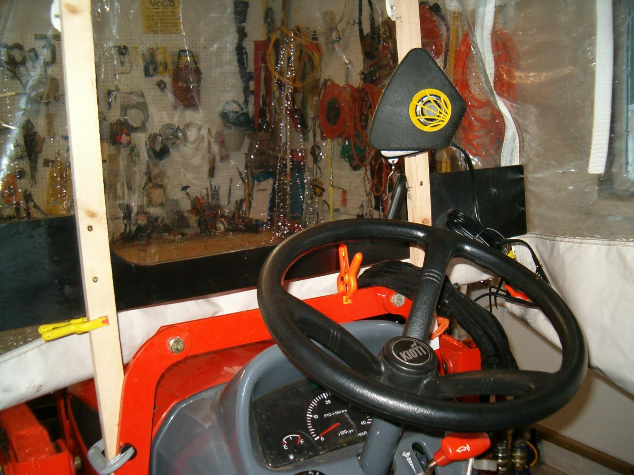

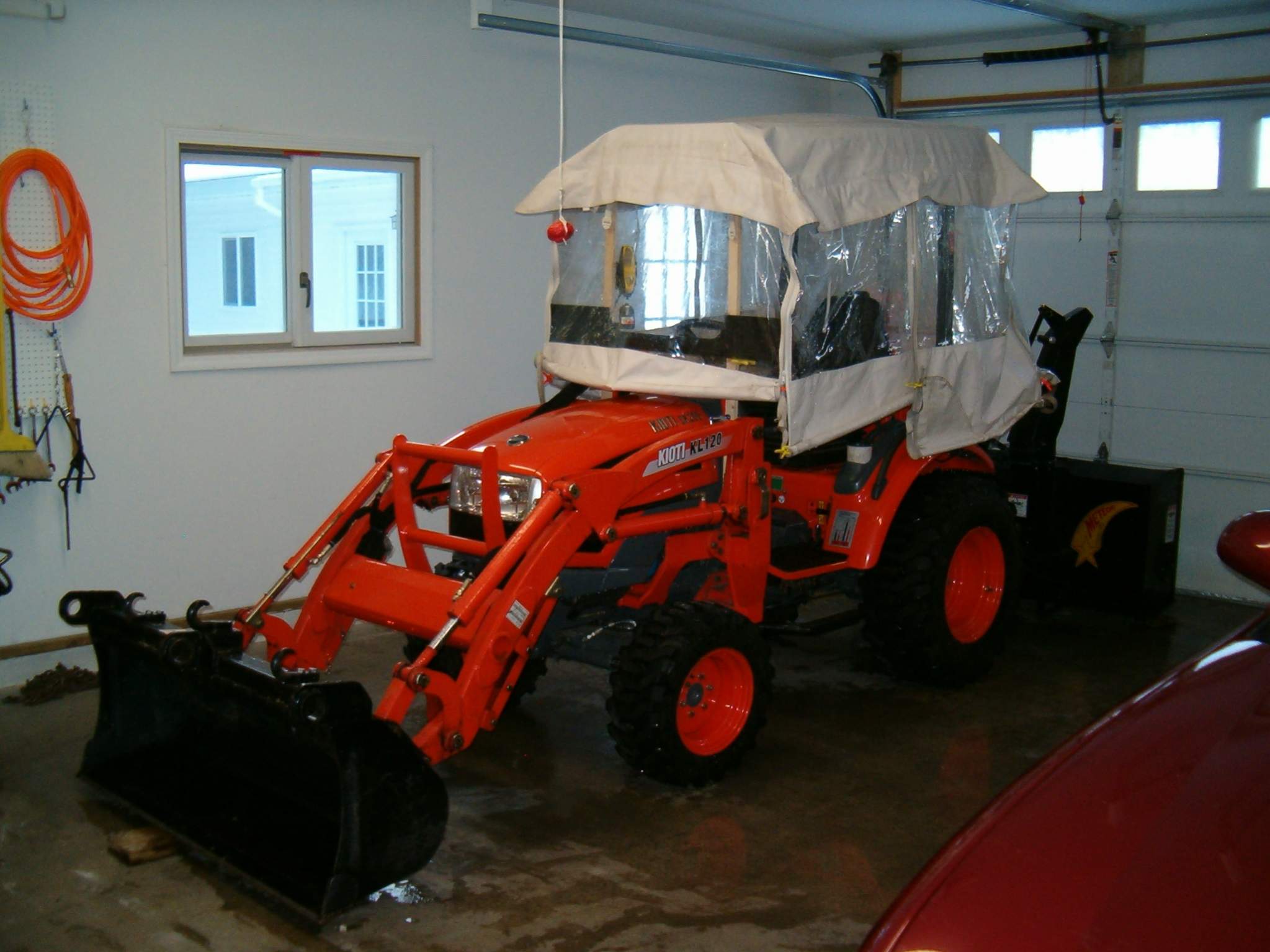

If it's going to be ugly than it has to at least work. This is my cab and this will be the third year I will be using it. It works for me keeping all the blasts of blown snow off my face. I am equipped with a rear snowblower and all I have to do is reach beneath the rear window panel and turn the crank to change snow chute direction. A quick bachhand from the inside of the cab knocks the wet snows off with out a doubt. Dryer colder snows don't stick.
I have a top lid on the Rops. I stuck a couple pieces of aluminum angle bar ujp and down to catch the front of the tractor lid. Then I simply attached a couple of screws to the FEL frame to hold the front supports and top sturdy. Across that I have placed a 1 X 6 with the sharp edges rounded off so as not to cut through the vinyl. That 1 X 6 serves me well to keep the shape of this golf cart encosure serving double duty as a snow blower cab.
I get a little heat back in cab from engine and my feet are always tucked in warm boots so the air conditioned floor of tractor operating area comes with no extra charges.
You can buy these golf cart covers when they are on sale from Northern Tool for $79.00. Use them on the golf course all Summer and for a tractor cab in the Winter. ($99 regular price) When the thing gets dirty, you fork over less than a hundred bucks and buy a new one.
