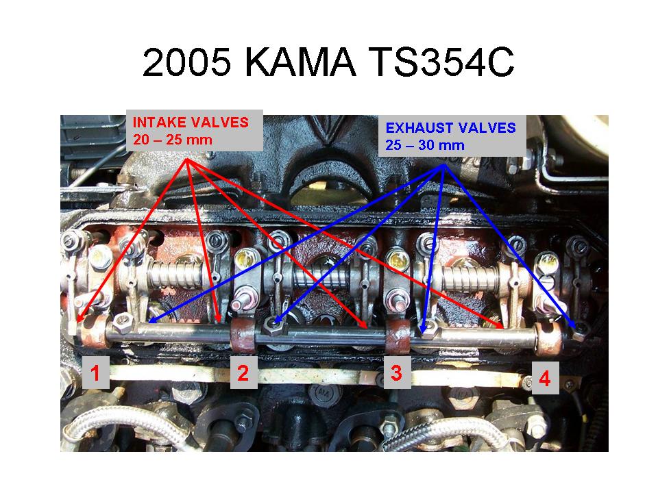

Kama TS354C & Ferguson TO20
Special thanks to Chip from ARTRAC for all the info...
TIRE PRESSURE:
Front (With Front End Loader) – 35 psi
Rear (With Backhoe) – 20 psi
ENGINE FIRING ORDER
1 – 3 – 4 – 2
50 HOUR SERVICE
Adjust Valve Clearance
• Intake (Cold) .20 – .25 mm
• Exhaust (Cold) .25 – .30 mm
Re-Torque Head Bolts
• 150 – 170 NM (Be sure to loosen, lubricate and then re-tighten head bolts)
Replace Oil, Oil Filter & Fuel Filter
• Oil Filter – NAPA # 1516
• Fuel Filter – NAPA # 3195
Check Air Filter
• Air Filter – NAPA # 2276
See attached .JPG for engine layout

   / KAMA TS354C HELPFUL INFO #7
So on the re-torque of the head bolts you completely remove one at a time and lightly oil it and torque it before moving to the next? I would be afraid of breaking the head gasket seal but if you do one at a time in sequence I guess you should be ok. Im approaching 50hrs on my ts354c and am going to do this as well.
   / KAMA TS354C HELPFUL INFO #8
That is the way I did mine and it did not break the gasket seal.
   / KAMA TS354C HELPFUL INFO #9
In the past I have been trained not to loosen first, just be sure they are tight, but I have read very convincing arguments to do as you suggest and remove, lube and retorque. I would only do this one at a time and I would do it in two or three stages, in other words, remove and oil and torqu to 80 or 90 percent of final torque, then use the pattern in the book (stagger starting near center of the head and work out) to the final toruqe. Mainly you are trying to find bolts that have streached under use before they allow the head to warp enough to blow the head gasket. You cant get an accurate torque without cleaning and oiling, but you could find a loose head bolt. Most important is that the head bolts are all done/checked the same way.
