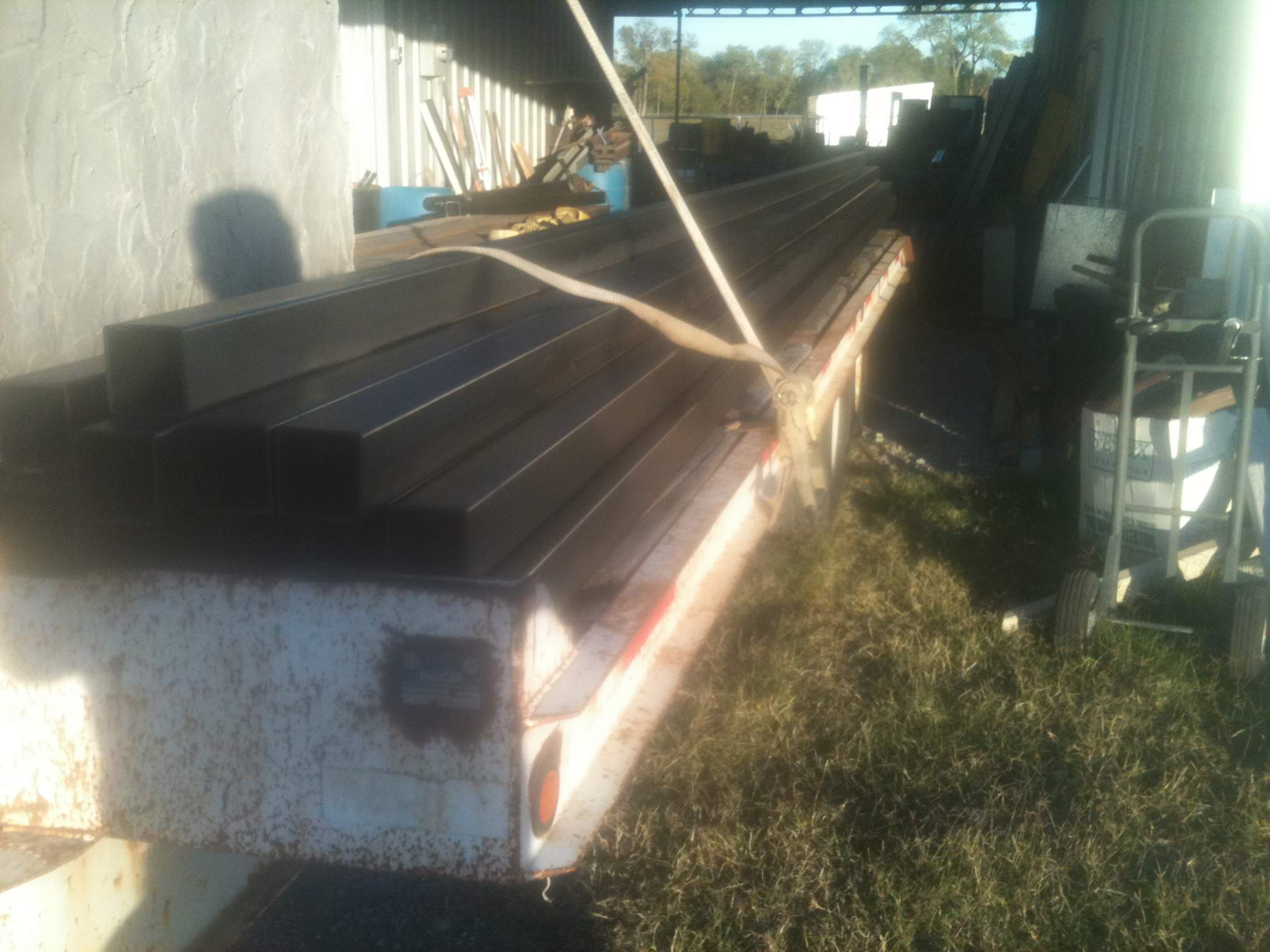

It's a ton of work. This afternoon I went to the steel supplier and picked up the material for the posts, 3" X 3" x 24' X 11 gauge. It's black with oily grease, much better than rust. But it will be a mess to work with. I will cut this into 6' lengths, weld a plate on one end so it will look like solid piece. I will drill two quarter inch holes in one side, one at each end. I will weld a 16" piece of two seven eighths eleven gauge pipe onto the open end. The post is now ready for the galvanizer. After it has been galvanized it will be powder coated with a conventional solid base coat. The two quarter inch holes are for the hanging of the post for this process. Once it has the basecoat then it will go to a clean room where a propriety process will apply the mat finish wood grain color coat. Every piece of the fence goes through this same process. Everything has to be a bolt up because each piece has to be done individually. Even the gate will be built where it is disassembled for powder coating and then reassembled on site. There can be no welding, cutting, or drilling on site after powder coating.
This fence will be spectacular when it is completed. But it is probably the most expensive simple rail ranch fence ever.

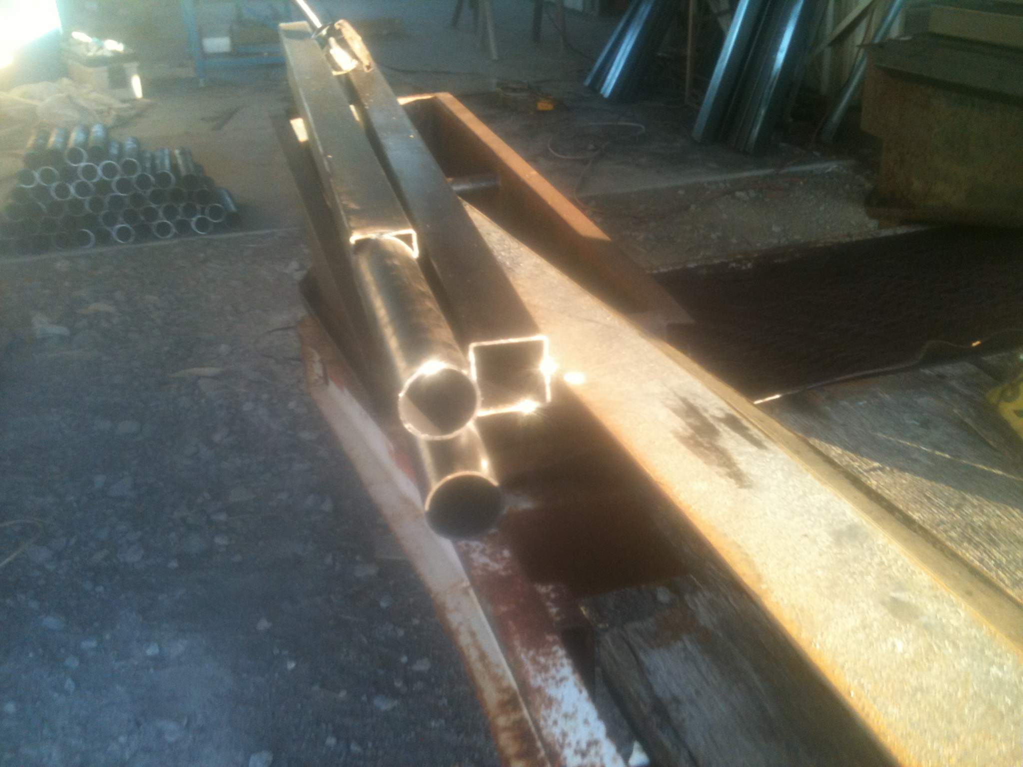

#629
The 3 inch 11 gauge tubing is nasty oily. I think I washed my hands a dozen times today. Doggone grease would cake up and the hands would be black. My wife loves cleaning my work clothes on jobs like this.
The fence is going to be a nominal 52" high. The 3 inch tubing comes in 20 and 24 foot lengths. 20 footers would give me three each 6'8" post out of each length. 24 footers would give me either three 8's or four 6's. What I need is 7'-4" posts. So I'm cutting the four 6's and then welding on a 16" piece of 2 7/8" fence pipe. The extension will be in concrete and we are only powder coating the top five feet of the post. The whole post will be hot dipped galvanized.
I know. I should have others to this part of the job. But there's something about the work that I just like, can't explain it, but there's a satisfaction, almost a joy that comes with finishing a post and it's like family. Besides that there's a bonding that goes on with the job when I look at a nasty looking piece of heavy metal and know that someday it is going to be a beautiful post that will look like the best dark walnut for many many years.
