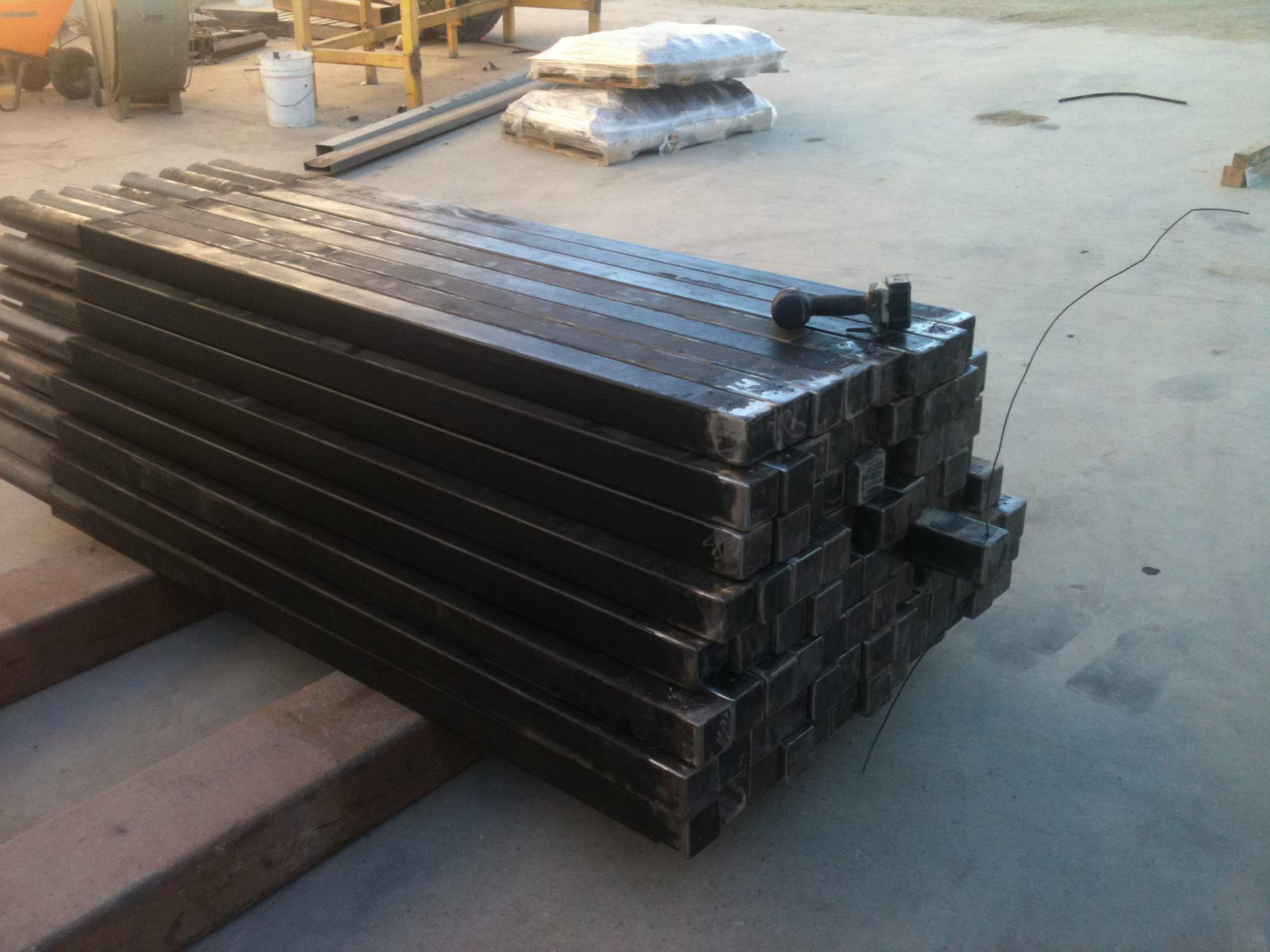

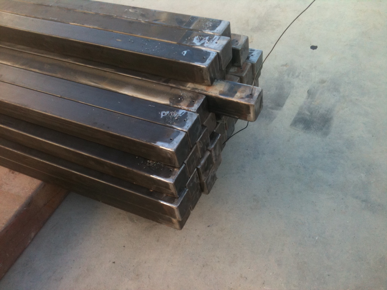

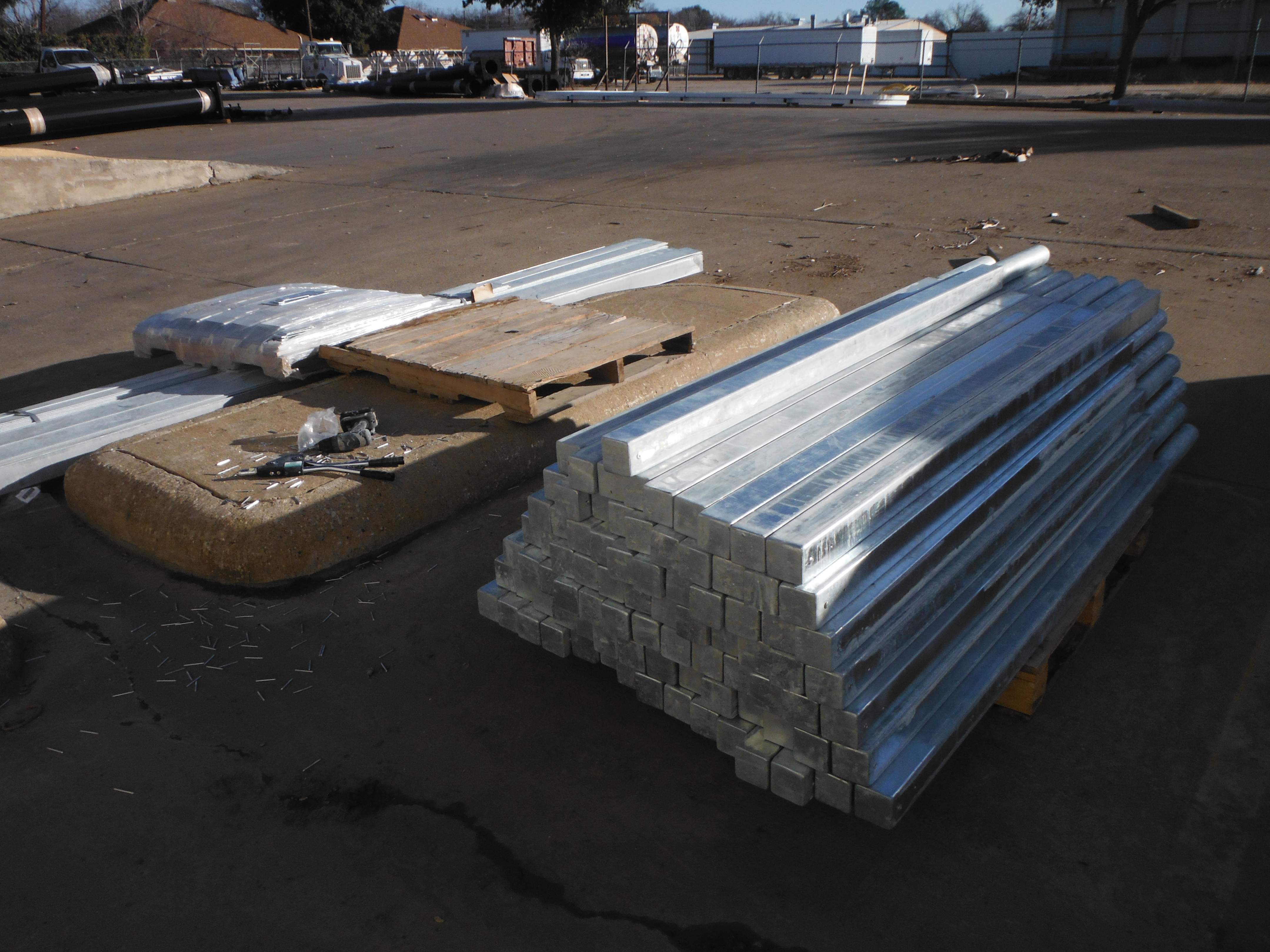

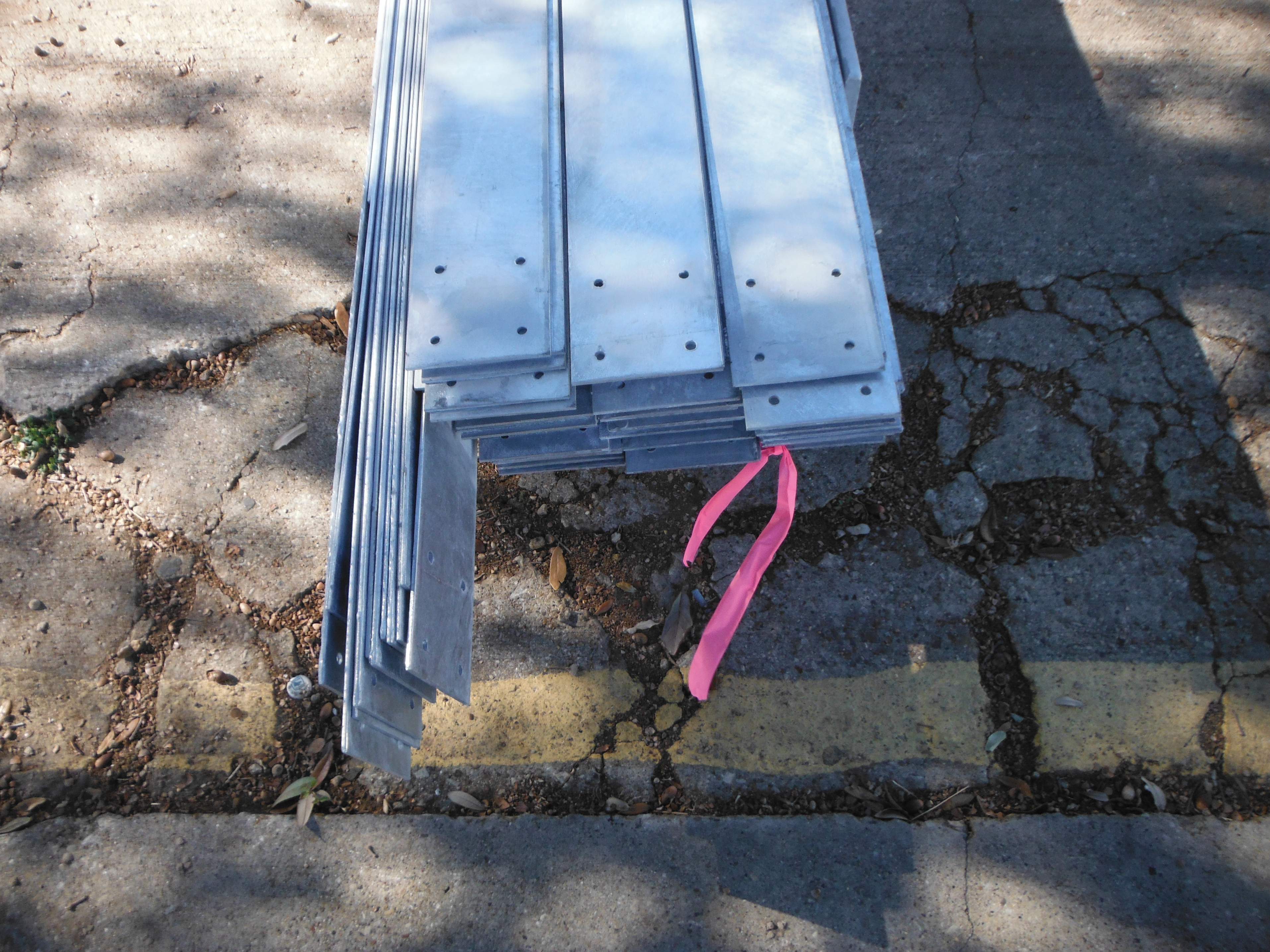

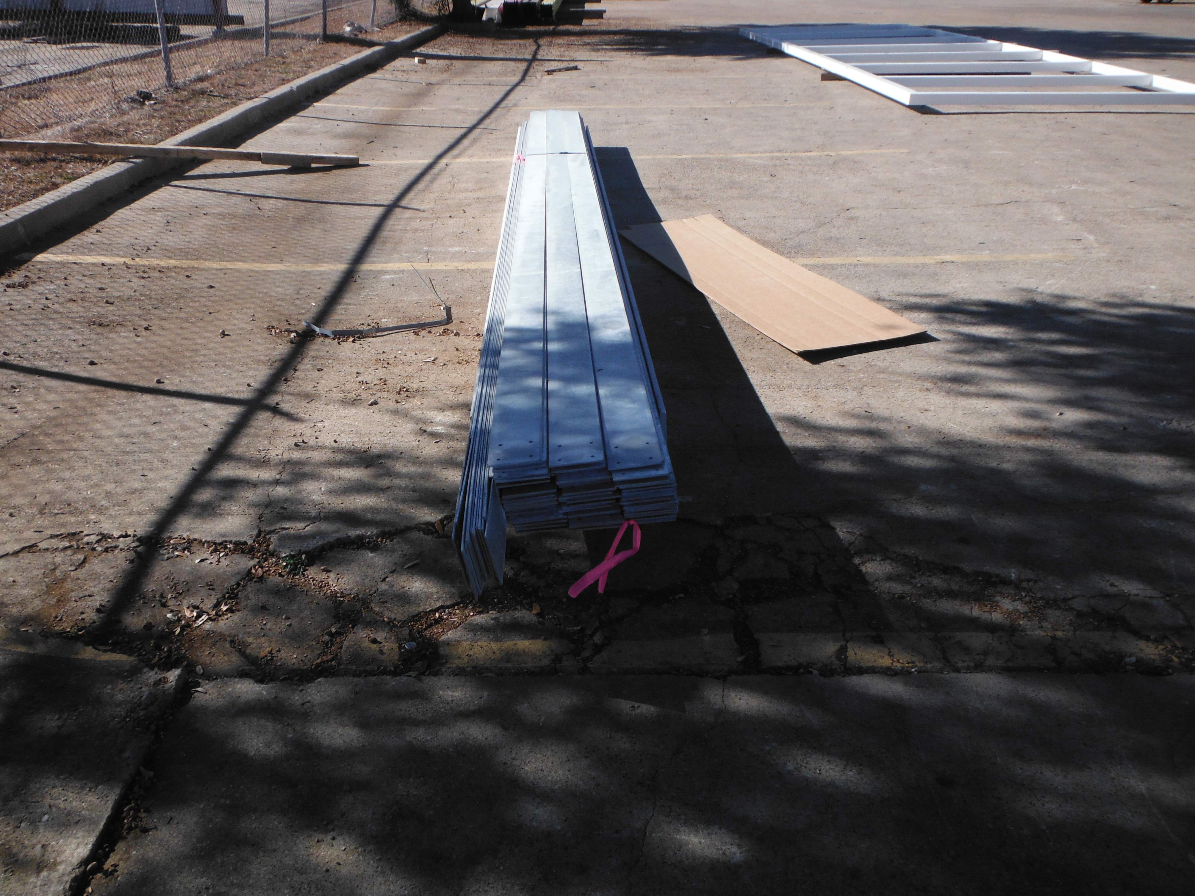

I apologize for the lack of updates, there hasn't been much happening while there has been a lot happening. All of the material for the fence is at the powder coater. It arrived yesterday.

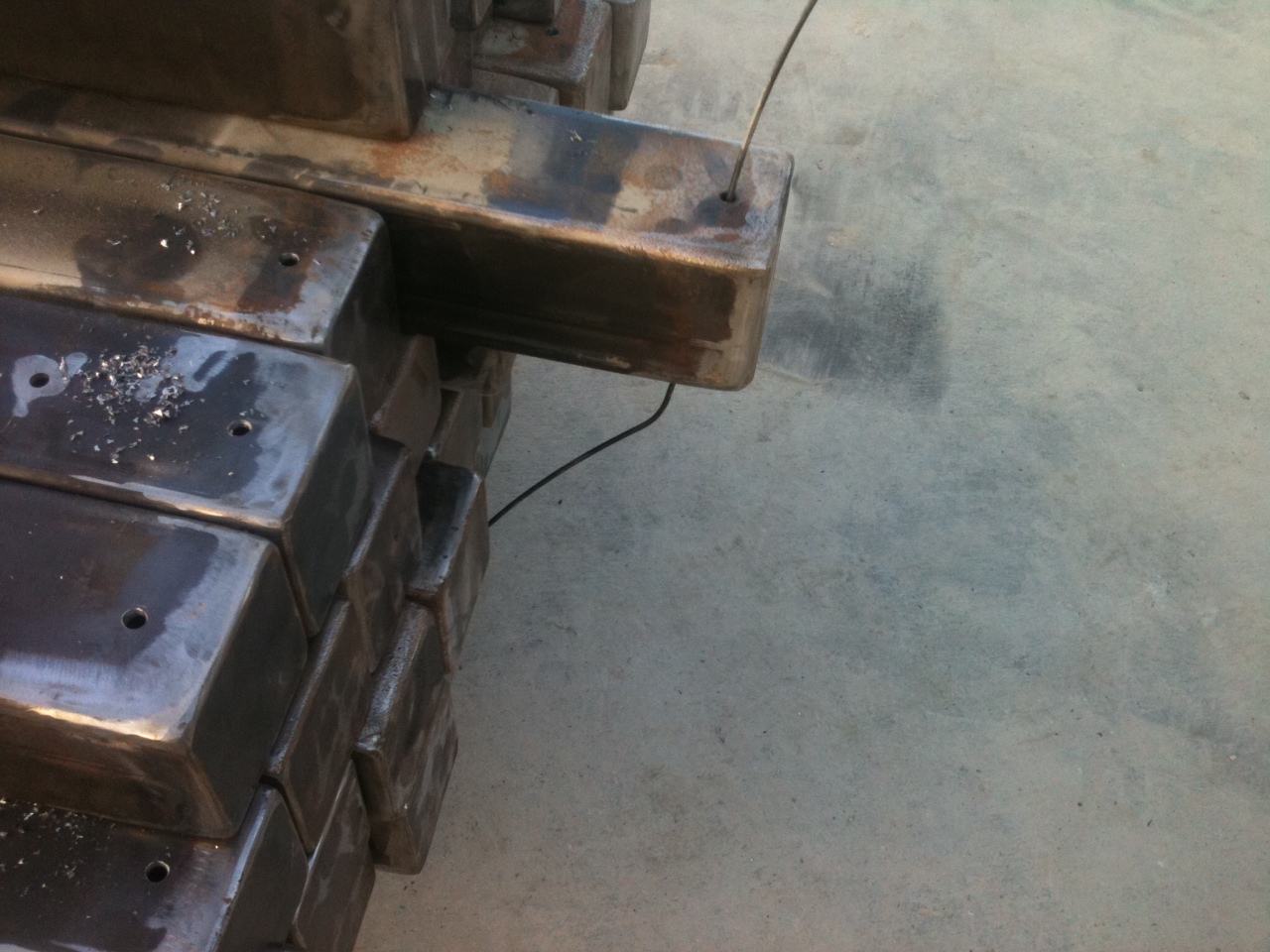

One of the things that happened was last week I got a call from the galvanizer that they wanted to drill two more holes in every one of my posts. I explained to them that no one but no one drilled holes in my posts but me. It was a two hour drive each way and it was in our cold snap but I did it.
What had happened was I drilled one hole in each post for the galvanizer and powder coater to use for processing. I placed the hole where it would be covered by a bracket during installation. I knew the galvanizer needed to dip the post in vertically but I figured a 1/4" hole would be enough for them to install a still wire that would hold the weight of the post during the process. They thought not. So I drilled two holes so they could run a wire through the post for their purposes.

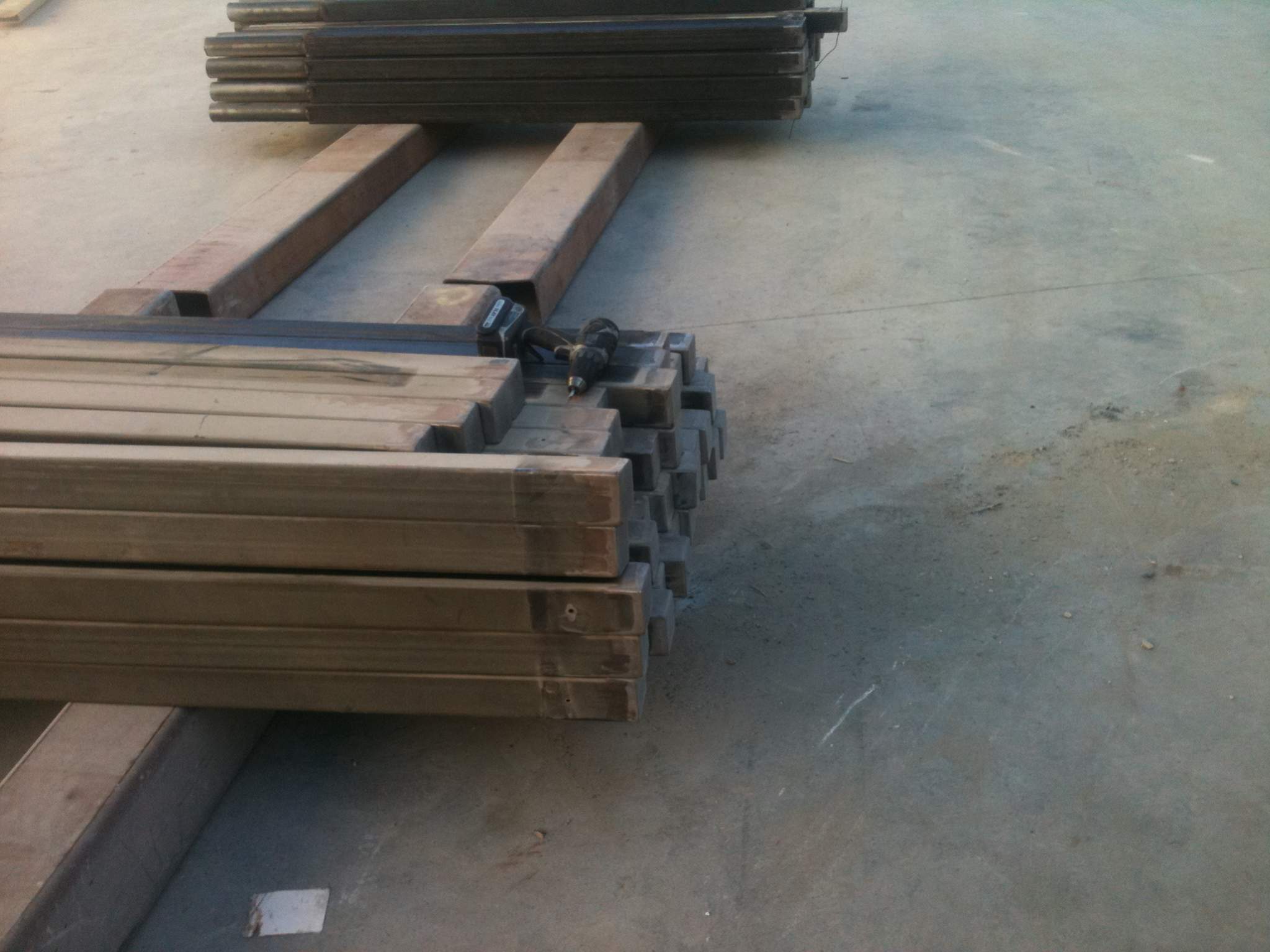

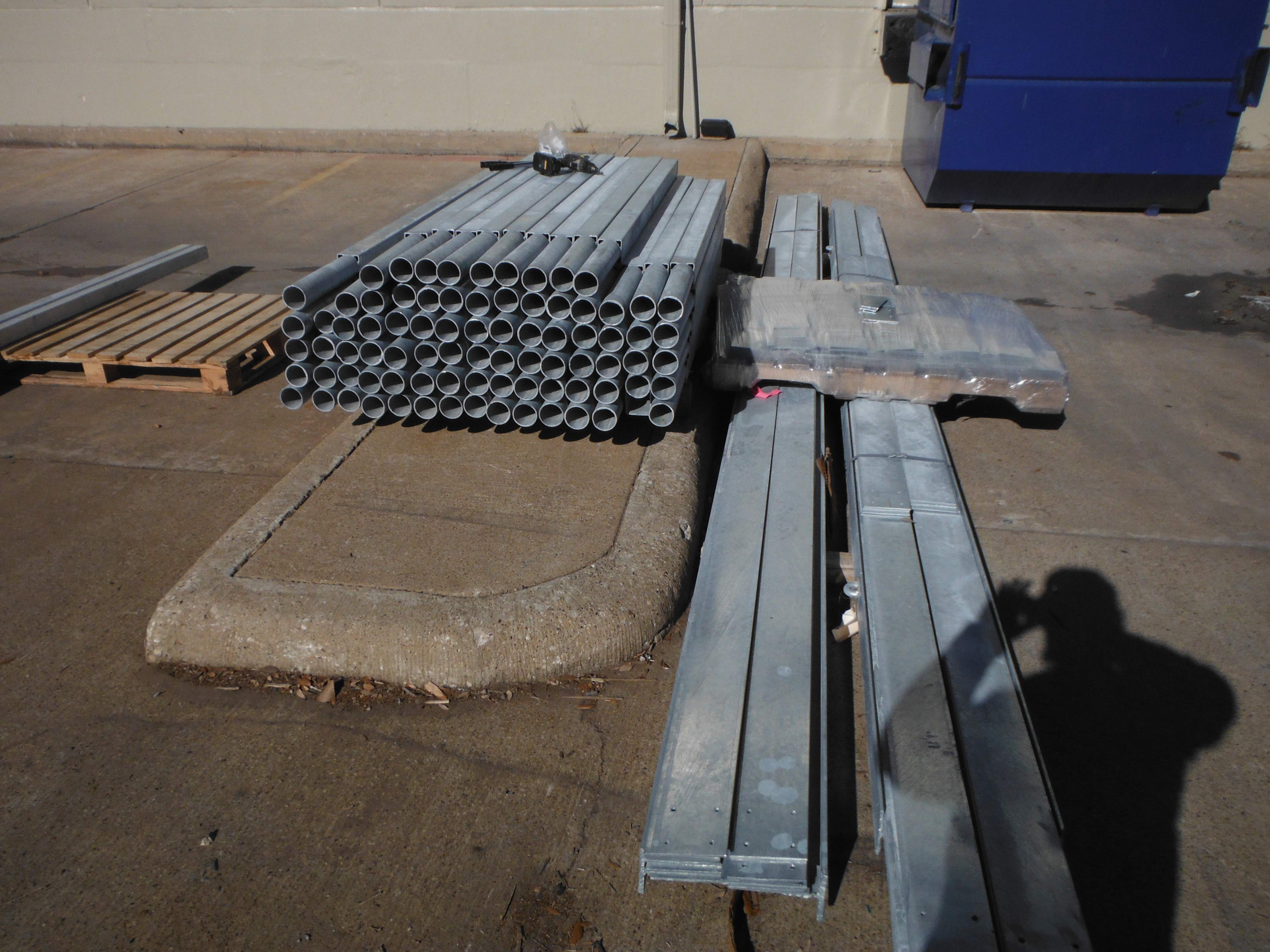

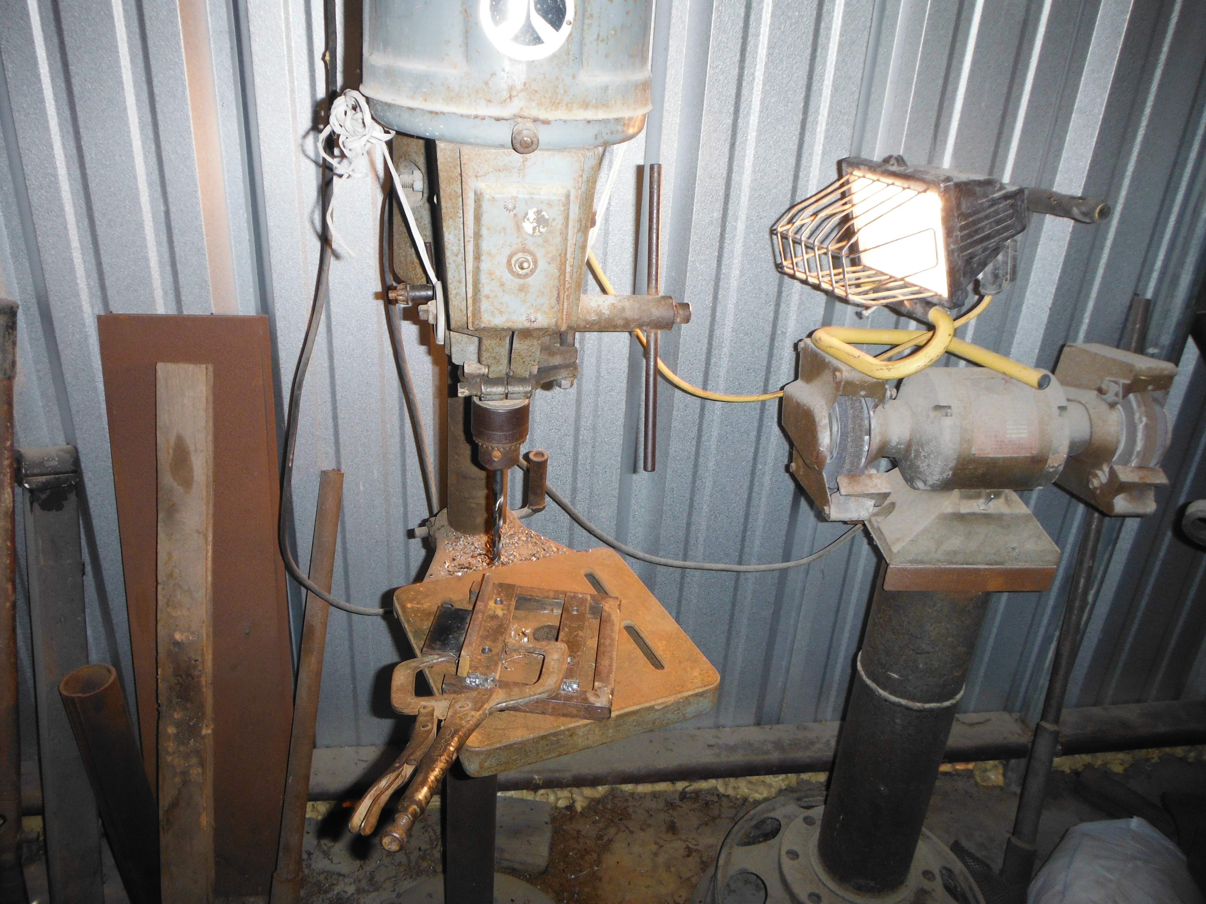

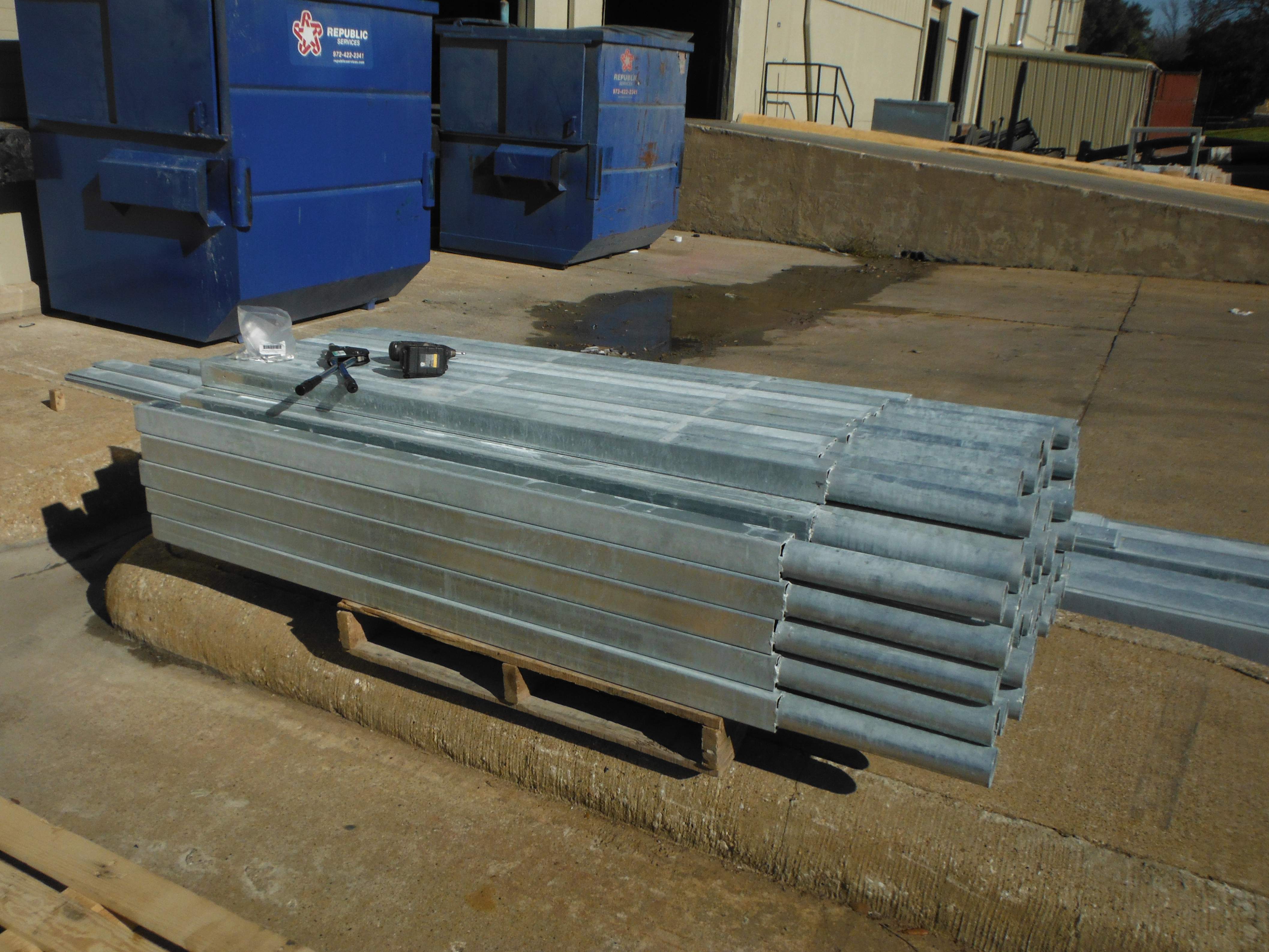

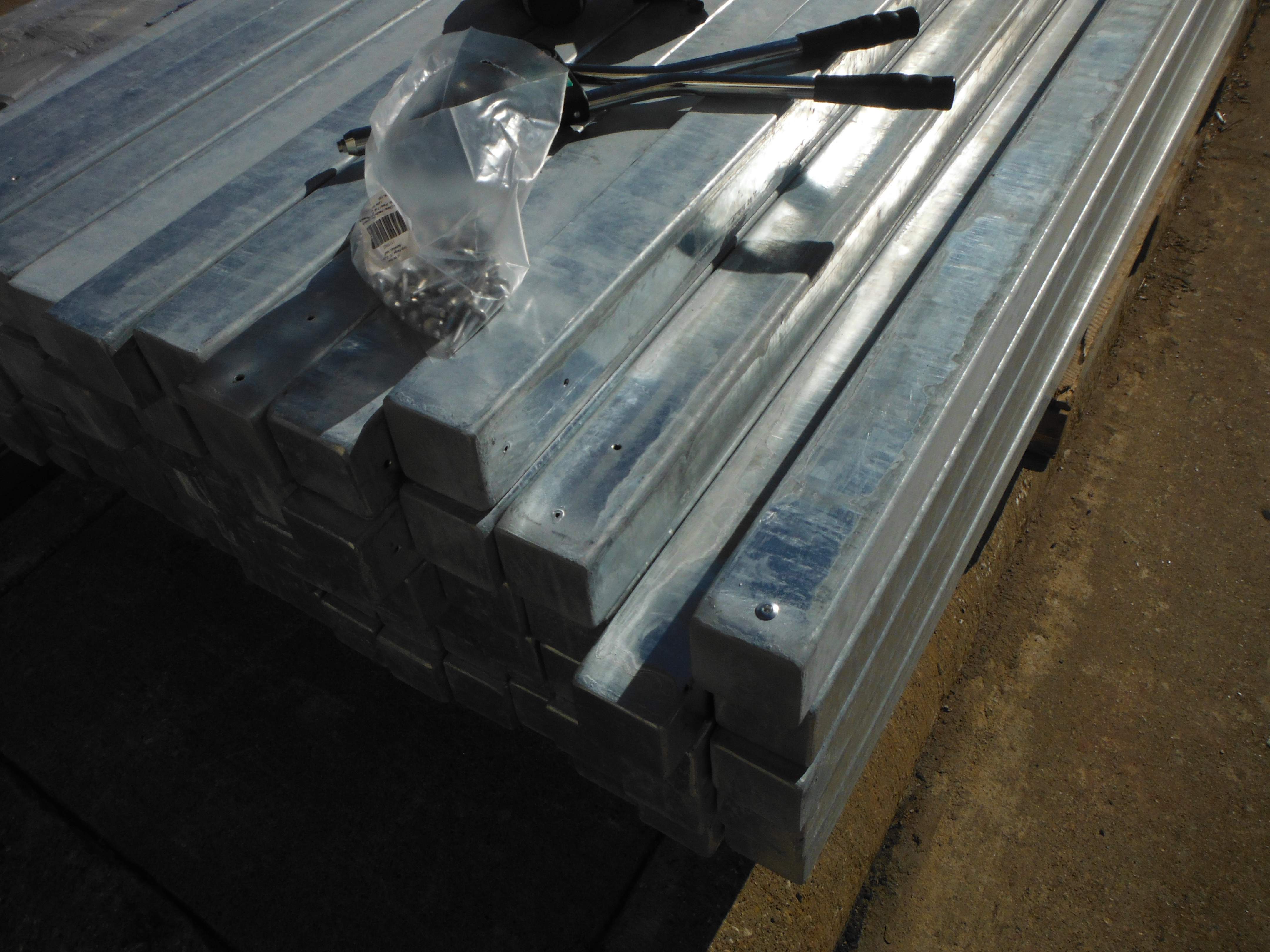

Yesterday afternoon the material was delivered to the powder coater. Today I picked up some quarter inch blind end pop rivets from Grainger to use to plug the holes I had drilled last week. One huge hiccup. I had picked those rivets because they had the smallest bulge after installation of all my easily available options. Drive in rivets left a big bulge, welding defeated the purpose of the galvanizing, so I went with the 1/4 inch pop rivets. Hiccup was the only riveter I could use for those rivets was a really neat $150.00 tool. Gulp! I now have the coolest rivet gun ever if this ever comes up again. It was two hours steady work to clean out the holes and install the rivets.

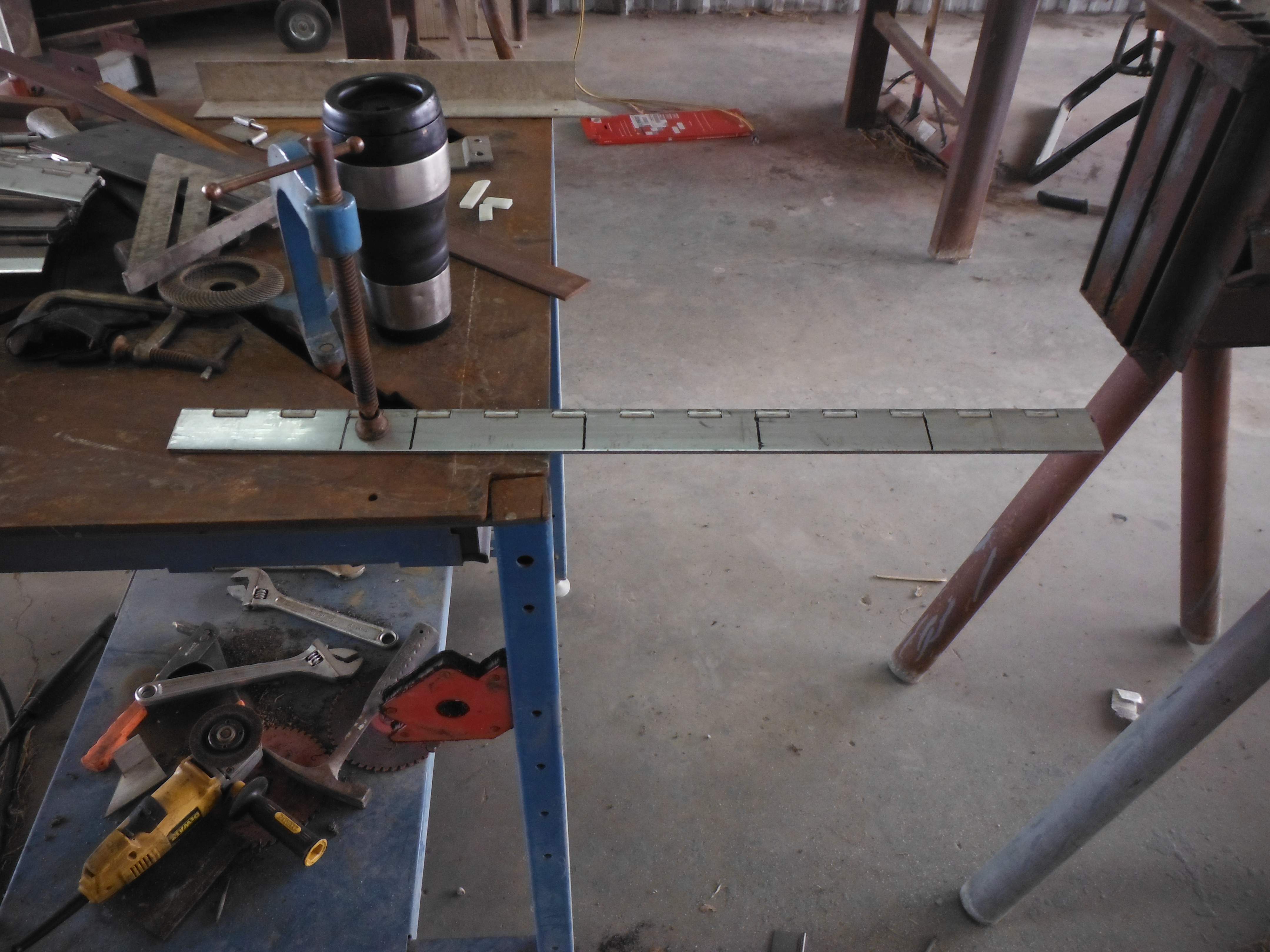

One of the issues with the fence was corners and radius's. That would be determined in the field and putting fins or tabs on posts would drive the powder coater crazy, he told me so. I picked up some 14 gauge stainless piano hinge 3" flat. It came in six foot sections so I cut it into five inch pieces. The idea is to have one half of the hinge coated to match the post and the other half to match the rail. This allows us to make any radius work and to go off at any angle from a corner. I went with stainless because I wanted the rust protection it provides and it would be almost impossible to do it with galvanizing.

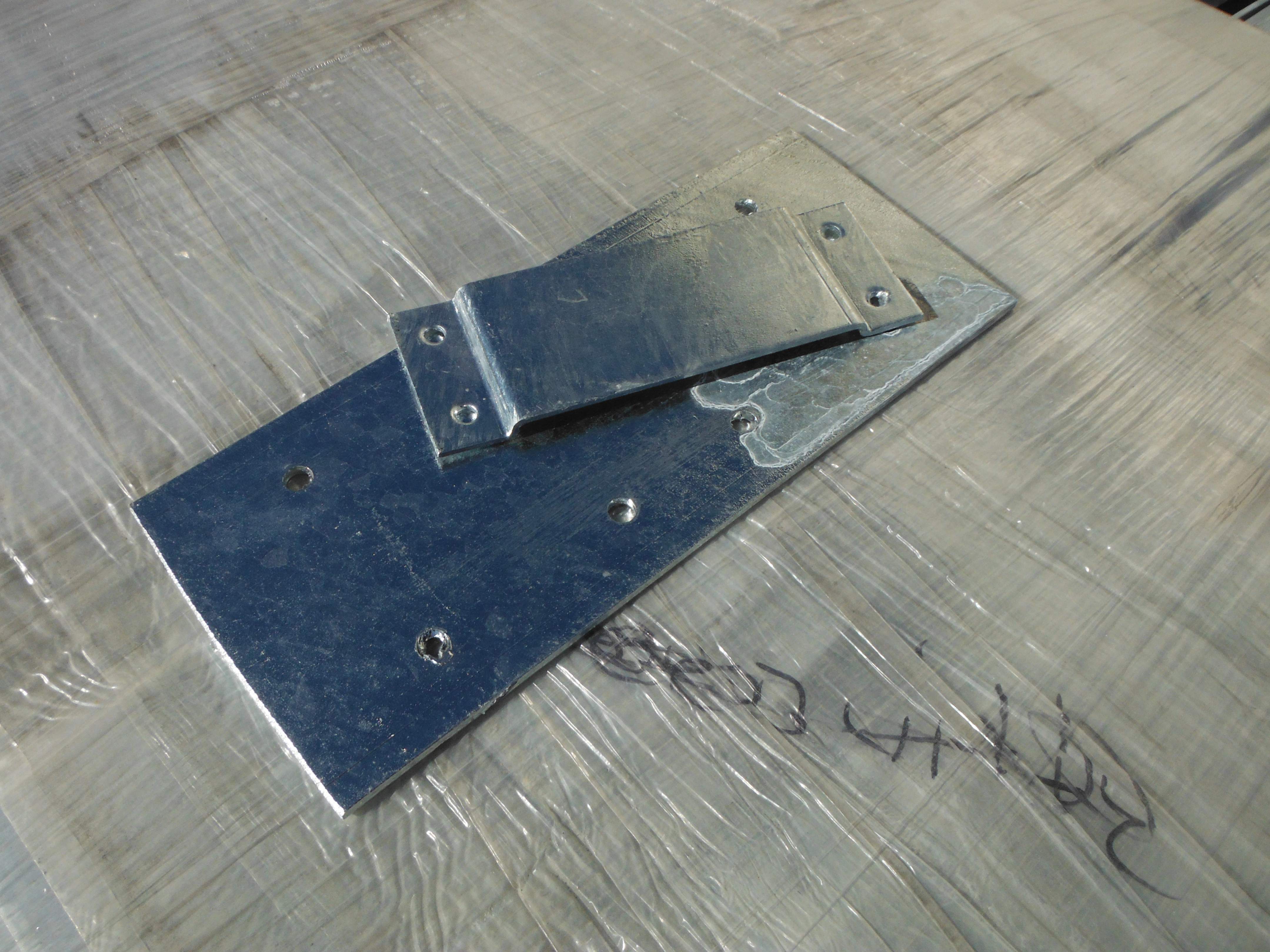

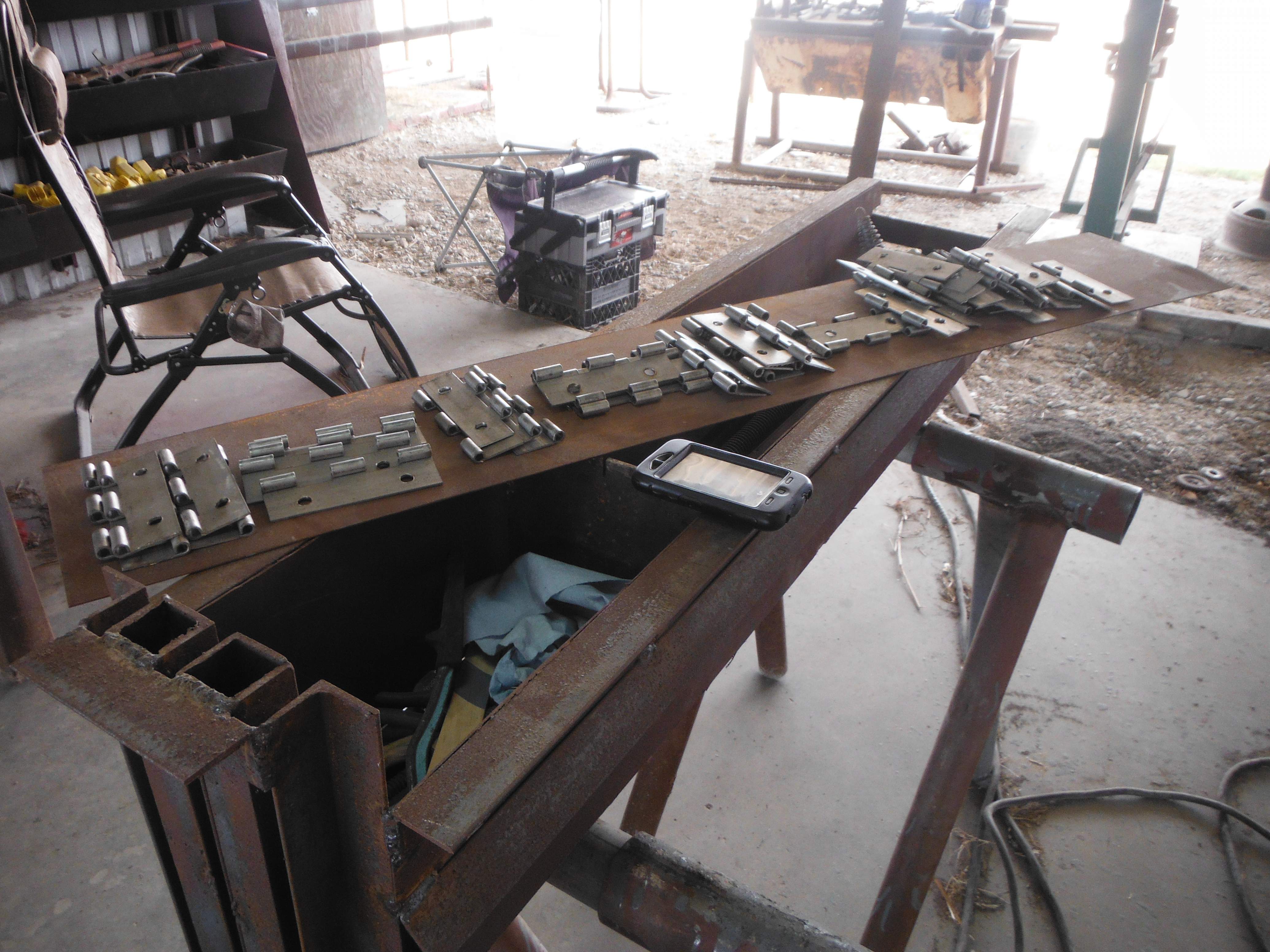

Smith's fence job 009.jpgSmith's fence job 002.jpgA fun thing about this is making sure everything is coated the right color. The two pieces in the one picture have to be done different colors. The big piece is a splicer for the rails so it will be the light rail color. The smaller bracket will be holding the rail to the post so it will be done the darker color to match the post.
The hinge material will have the three ring pieces done light to match the rails and the two ring pieces will be done dark to match the post.
