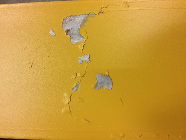

Yesterday at 7:00 a.m. I got the call no one ever wants to get. "Harvey the galvanizing is coming apart in the oven, it's a mess."
We are talking about a major issue with 12,000 lbs of steel that I have a ton of money invested in not doing what it should be doing in the powder coating process. Needless to say I was across town at the powder coaters as soon as possible.
What happened was the workers had grabbed three pieces to be coated as a sample out of a rack I hadn't inspected close. Some of the pieces in that rack are really crappy, they will have to have sections ground down and then the whole piece re-dipped. The workers luckily grabbed three of the worst pieces.
Prior to applying the wood grain they noticed bubbles on the pieces. They picked at the bubbles with a knife and the bubble chipped off, galvanizing left on the original piece and the powder coat too. So it is the galvanizing that is failing.
However, this appears to be just a small sample of the material. The rest of the stuff looks great.
Next week we will cull the bad stuff out and the galvanizer will take it back to make it right. This is one of those "WE have a problem" that isn't as hard on the system "I have a problem".

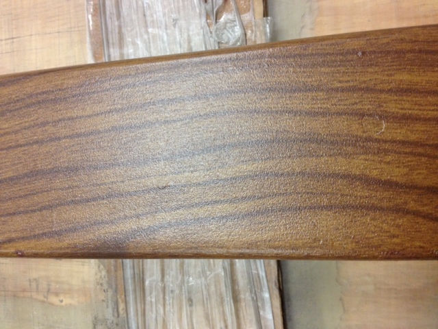

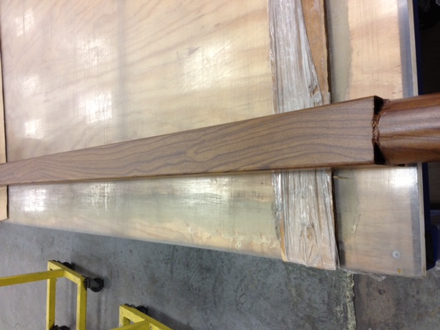

The powder coater had a post ready to wood grain but didn't put it in the oven because, this is the stuff I love, they were processing some thin material and it takes a shorter length of time and lower heat than the thicker post would require. So the last thing they did was coat the post and then send me these photos.

Wood peckers and termites are in for a big surprise. Looks good, no maintenance, will outlast all of us, Wow.
