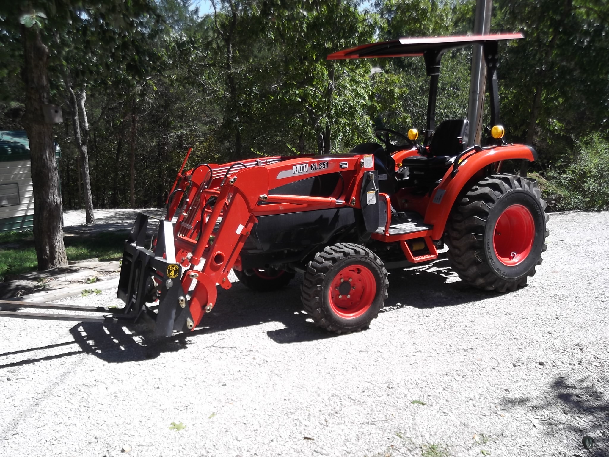

If you want a slightly smaller Kioti than the DK40se (a real beast of a tractor) and if you can find a used one a DK35se like the one in my avatar is a good machine. It is about 4 inches shorter than the DK40, lifts slightly less on the 3pt and only lifts 1430 to full height on the loader but otherwise has all of the deluxe features of the DK40se. This machine is a cut above either the 3901 or the CK35 or CK3510. I paid $19,300 for mine new in 2012. Of course they don't sell new ones, but maybe you could fine a good used one somewhere.
