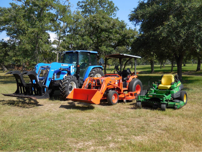

I was more speaking to the Kubota BX2360's I've seen with ROPS that are much lower. 70.4" in fact. Now while 18" is a ton and would solve my problem with hitting low hanging branches, I feel that 70.4" ROPS are *too* low on these size tractors. That being said, I'm sure there is some happy medium between the ungainly looking ROPS on my machine, and the lower ROPS on a BX2360.
Picture;
Now surely, there is a happy medium between my rops that are TOO TALL, and these rops that are too low to be used safely IMO. I suppose if that were to happen, I'd still be using the wrong machine for the job as you say.
As far as the zero turn, I never produced any numbers, I said "nearly". Frankly, in some of my areas 10" would still make a difference in hitting a limb and not hitting a limb. This will be solved shortly as I'm trimming up what I can around the property. In the meantime, I suppose I should be using goats for the areas around my pasture I'm trying to bush hog with my machine, instead of stating the ROPS are too tall (since I'm using the wrong machine for the job and all). Obviously that request is way to far out in left field to be considered valid.
