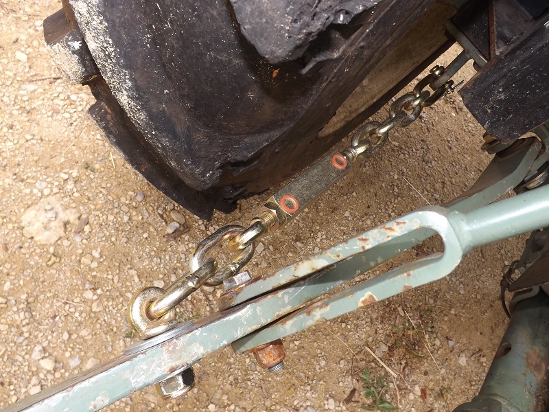

I'm not looking for anything huge. I have a compact tractor. A rear bucket the size and space of my rear box blade is my intent. This way, I can manage navigating any bucket loads with ease.
Additionally, I have the better stay chains on the tractor arms from Hoye. I've even added a few extra items to ensure the durability with them. In my implement listing, the rear disc-harrow and the brush mower are huge vs. the box blade or a hopefully the rear bucket. :cool: Thus, if I had any swing action, I would have noticed it by now.
Another option I did was to replace the pivot bolts where the lower arms attache to the tractor. With the better bolts, huge nyloks, thick and large fender washers, the sway is greatly eliminated to zero. It took some engineering to figure out how to stabilize the lower arms as my old JD-261 finish mower was awful with sway on them.

Here's a quick pix of the lower arm with the washers and nylok in place. This has helped a good deal to prevent swaying outwards towards the rear wheels.
635840d1578366346-koyker-140-loader-ym2610-maybe-dscf6445md-jpg
This next image is with the added Hoye stabilizer chains with added hardware
635841d1578366490-koyker-140-loader-ym2610-maybe-dscf7063md-jpg
635842d1578366521-koyker-140-loader-ym2610-maybe-dscf7065md-jpg
