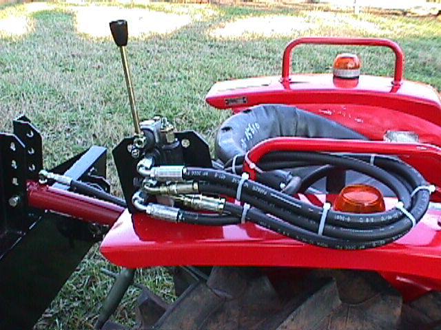

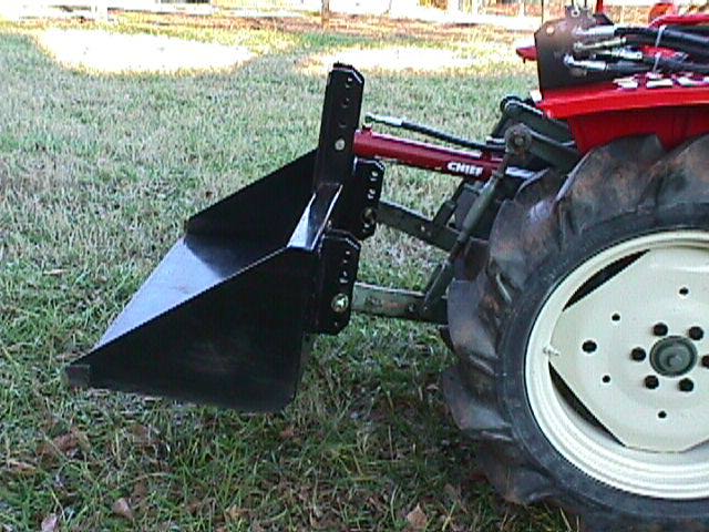

I built rear forks out of bedframe angle iron plus some scrap. Matching it to the q-hitch meant I didn't have to buy 3-point pins. Then I added a platform, and later reinforced the platform using another bedframe. I use this all the time for hauling stuff around. Hitching it on takes only an instant, just back into it and lift.
If you have a welder, fabricating something like this might meet some of your needs immediately at near zero cost.
Photo 1
Photo 2
Nope, no welder here. :(
I'm good at carriage bolts and brackets. :thumbsup:

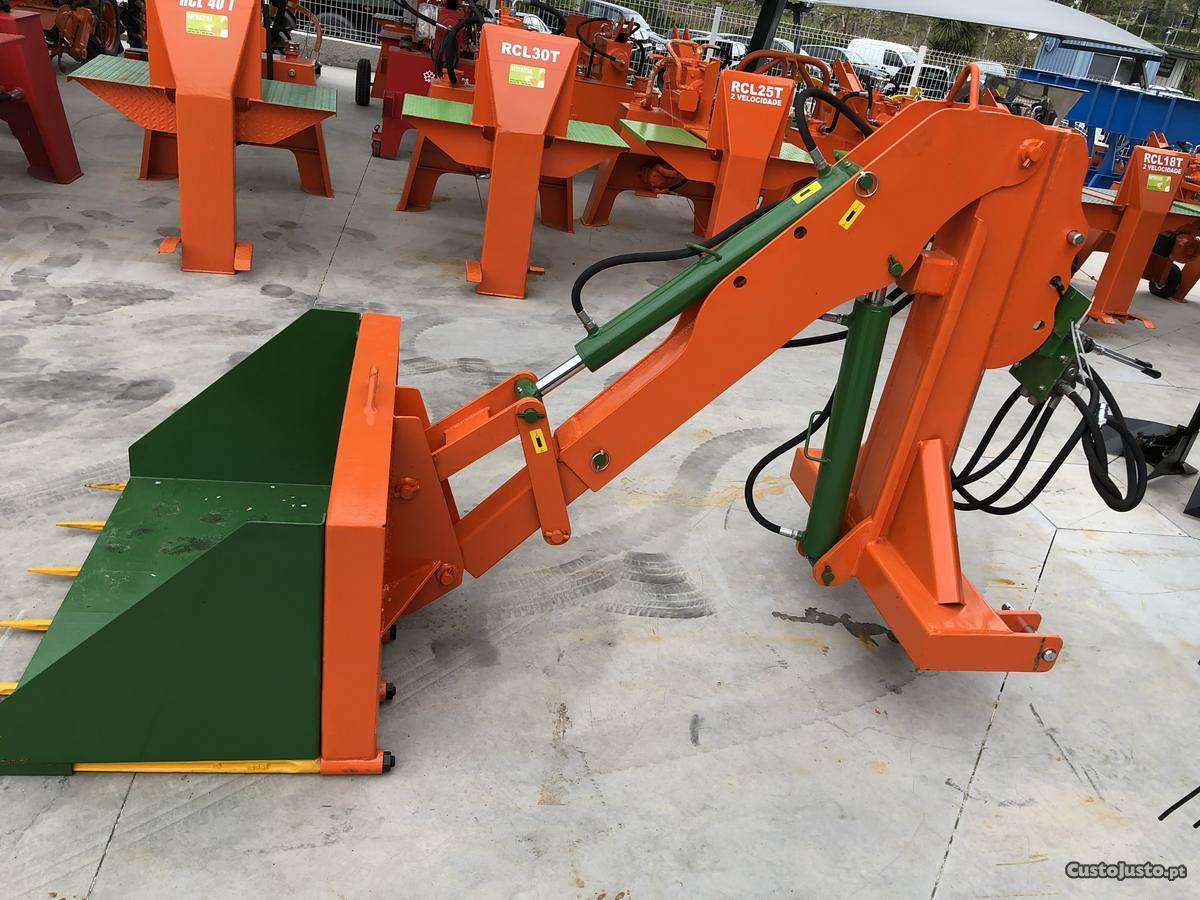

We have these 3 pt loaders over here, that do have some decent lift height and weight. They have a telescopic arm that you can the length by simply pulling a pin.
You can also get buckets, spikes for manure or bales, grapple, forks and a hook to use it as a crane. Since it's a single arm design vs the two arm on a front loader, the attachments are usually narrower (40" wide) than what you are used to.

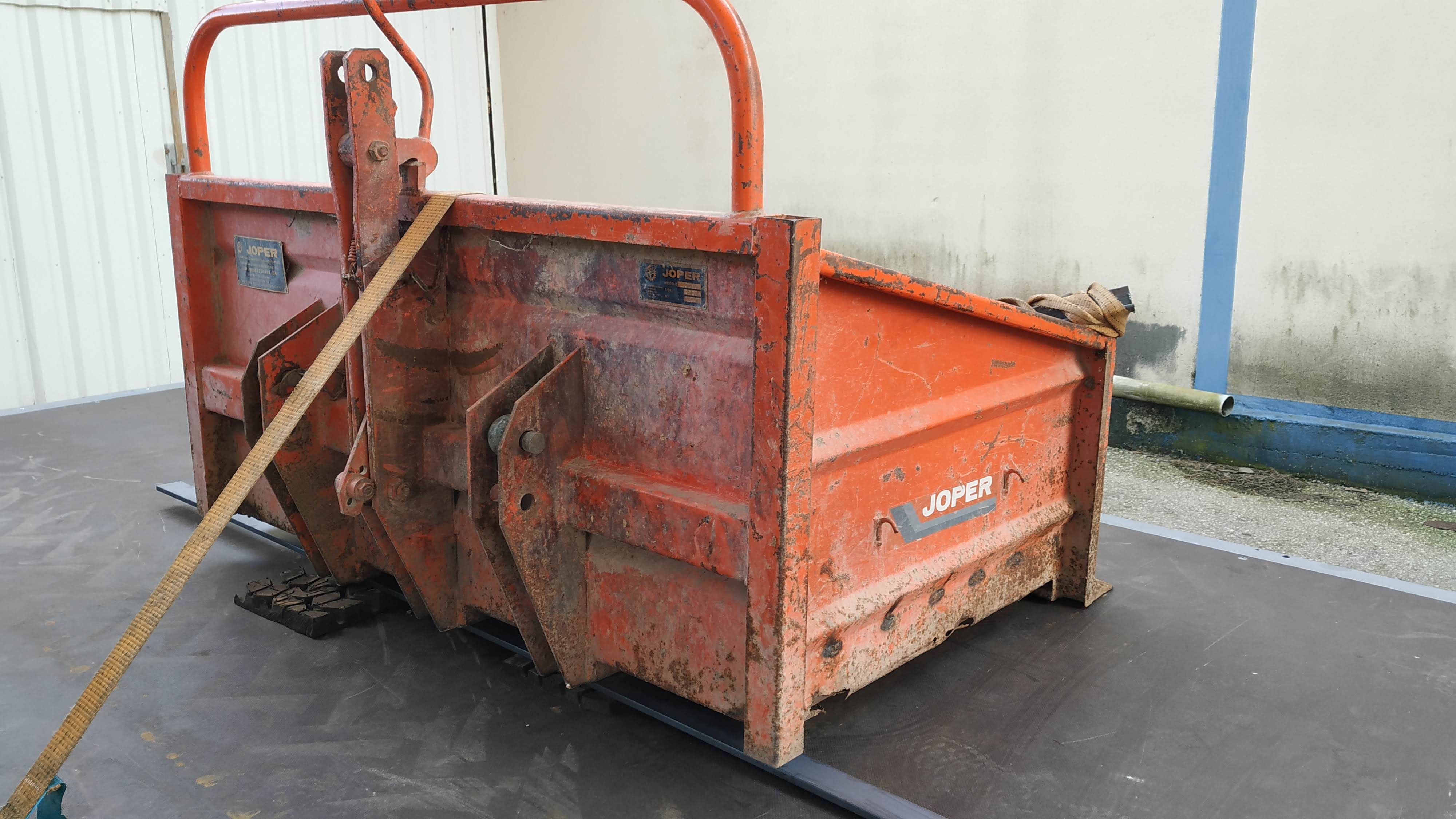

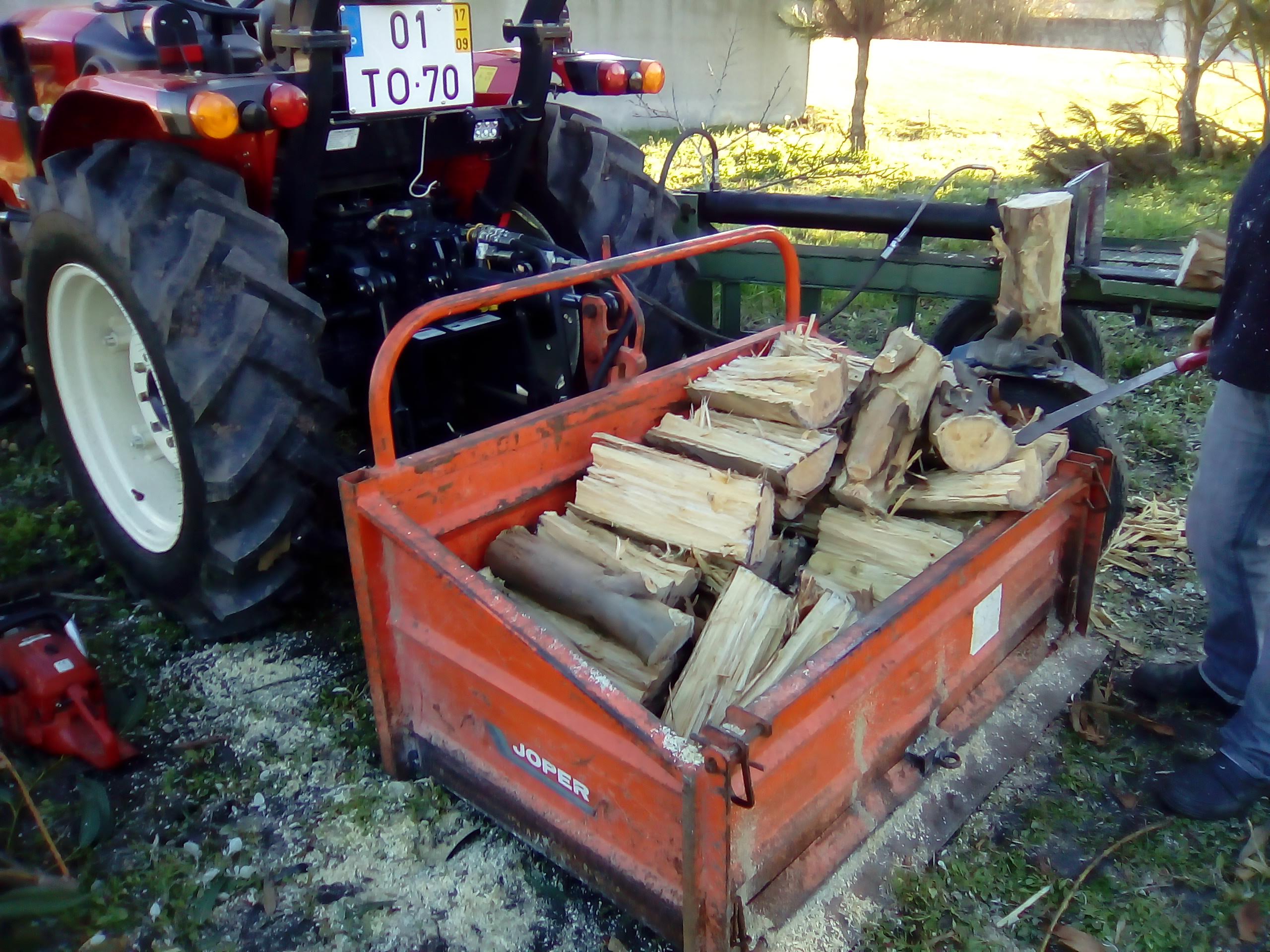

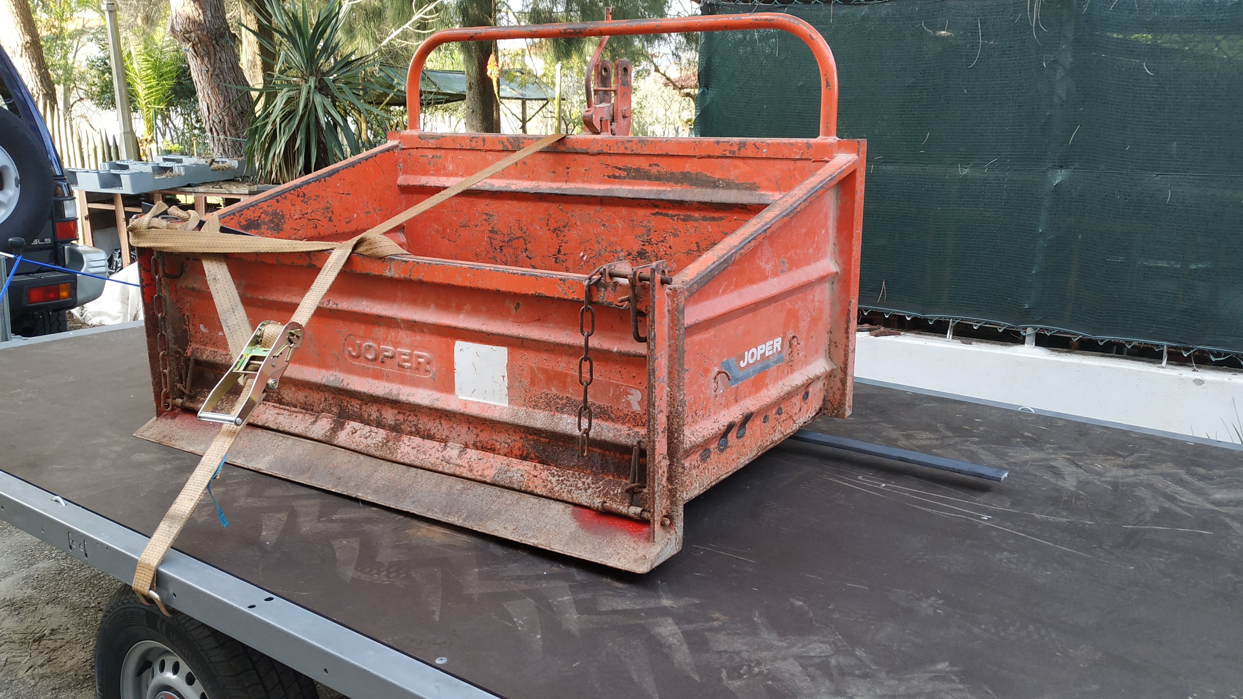

Here in Portugal those are not very common. What we use a lot is those 3 Pt loaders I showed before and probably the most sold implement here, a Carry all box.
This carry all box comes with lots features, let's see if I remember everything:
- It can dump by pushing a simple lever to unlatch the hook.
- It has a cutting edge on the rear so you can load and scrape materials
- Removable tailgate that can also flip down to extend the length or just flip up and out of the way to dump stuff.
- These things are build to take a beating. Usually lasts a lifetime if not stored under the weather to rust away.
One of these about 1.25 m (4ft) wide costs new about 300€ (340$). I bought mine used for 100€ with the corners completely rotten but I've replace those with a thicker gauge sheet metal and it's now waiting patiently for a fresh coat of paint.
If you search "3 point tipping box", you'll see some similar stuff but not quite like mine.
