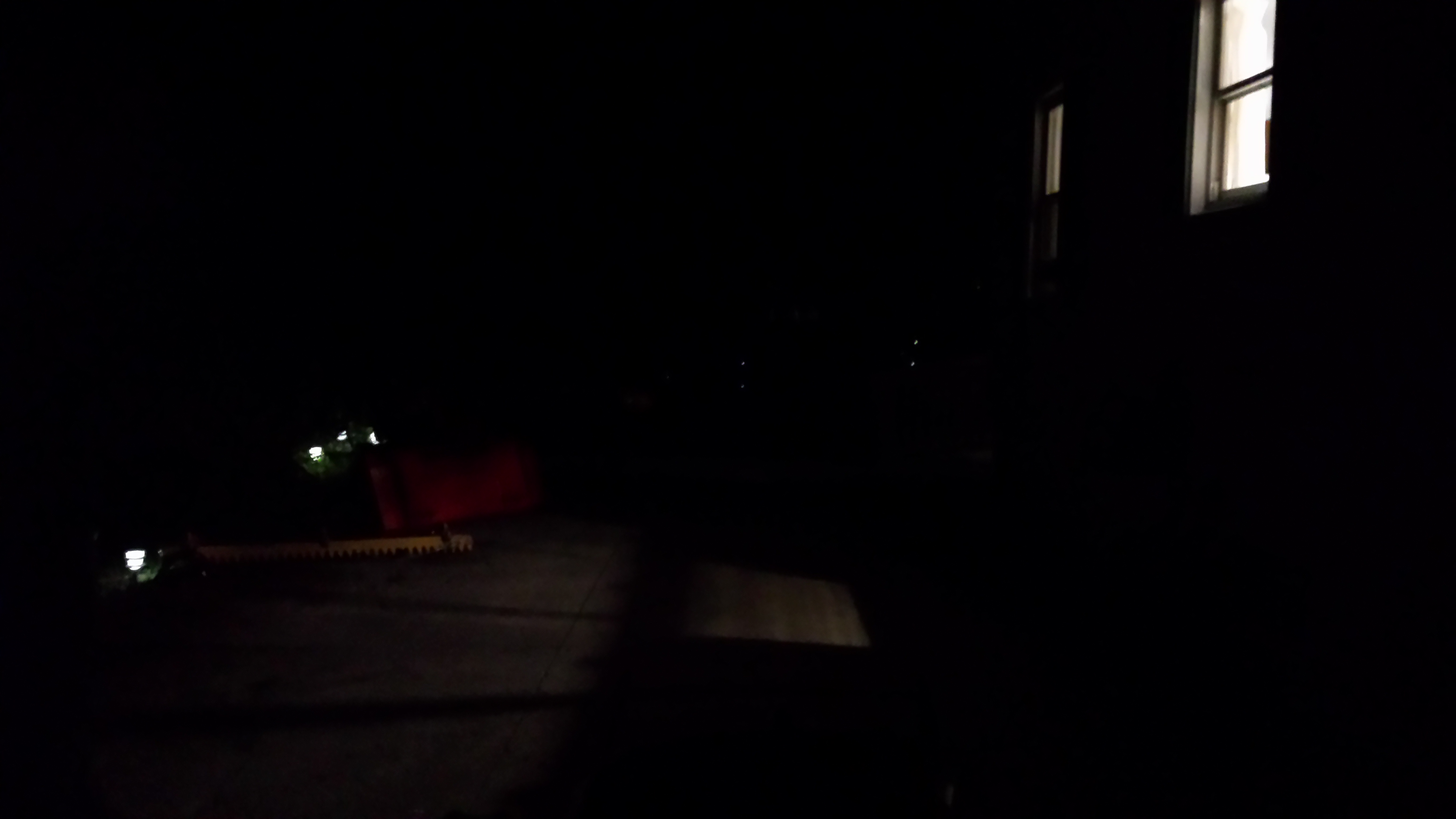

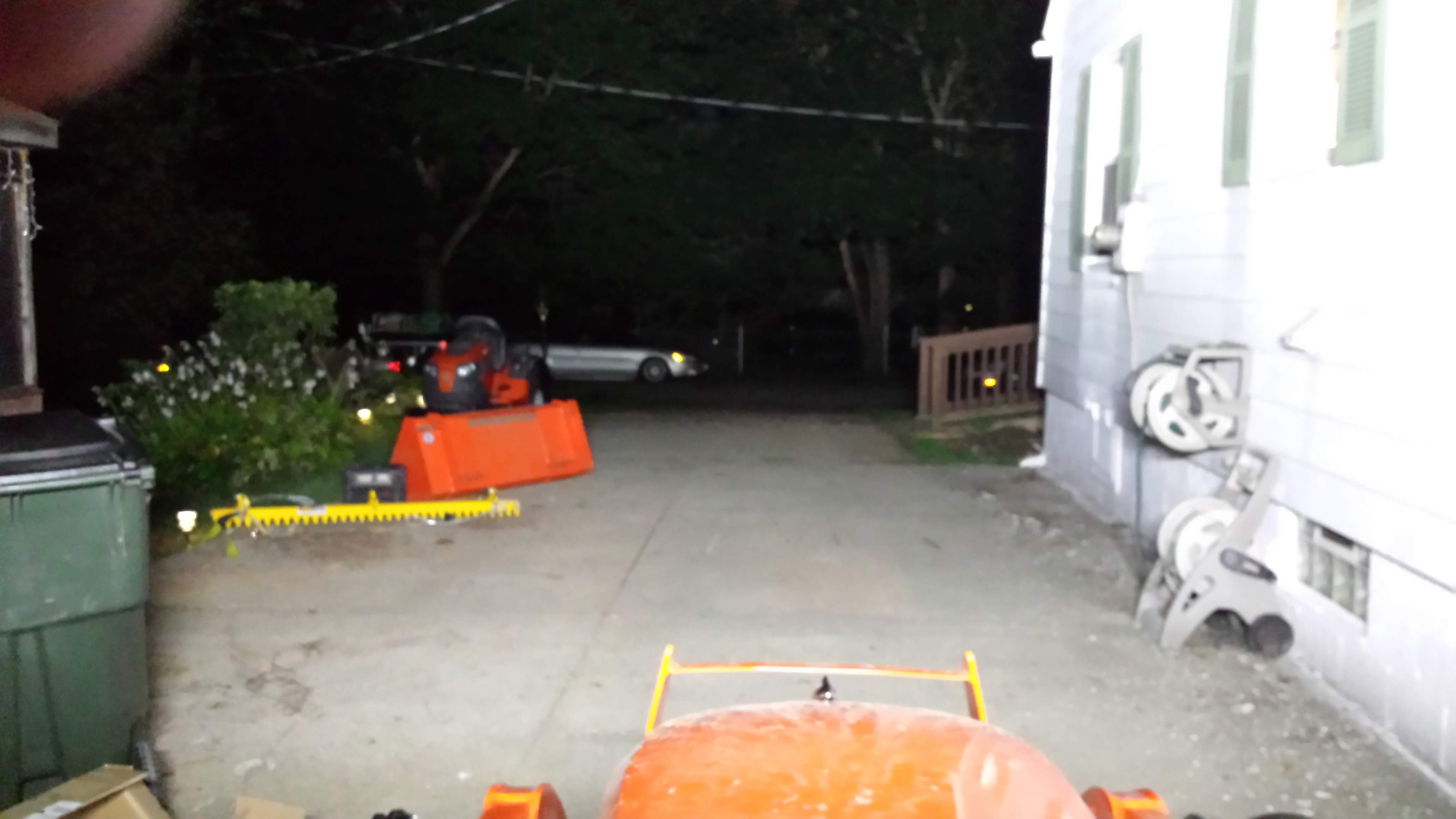

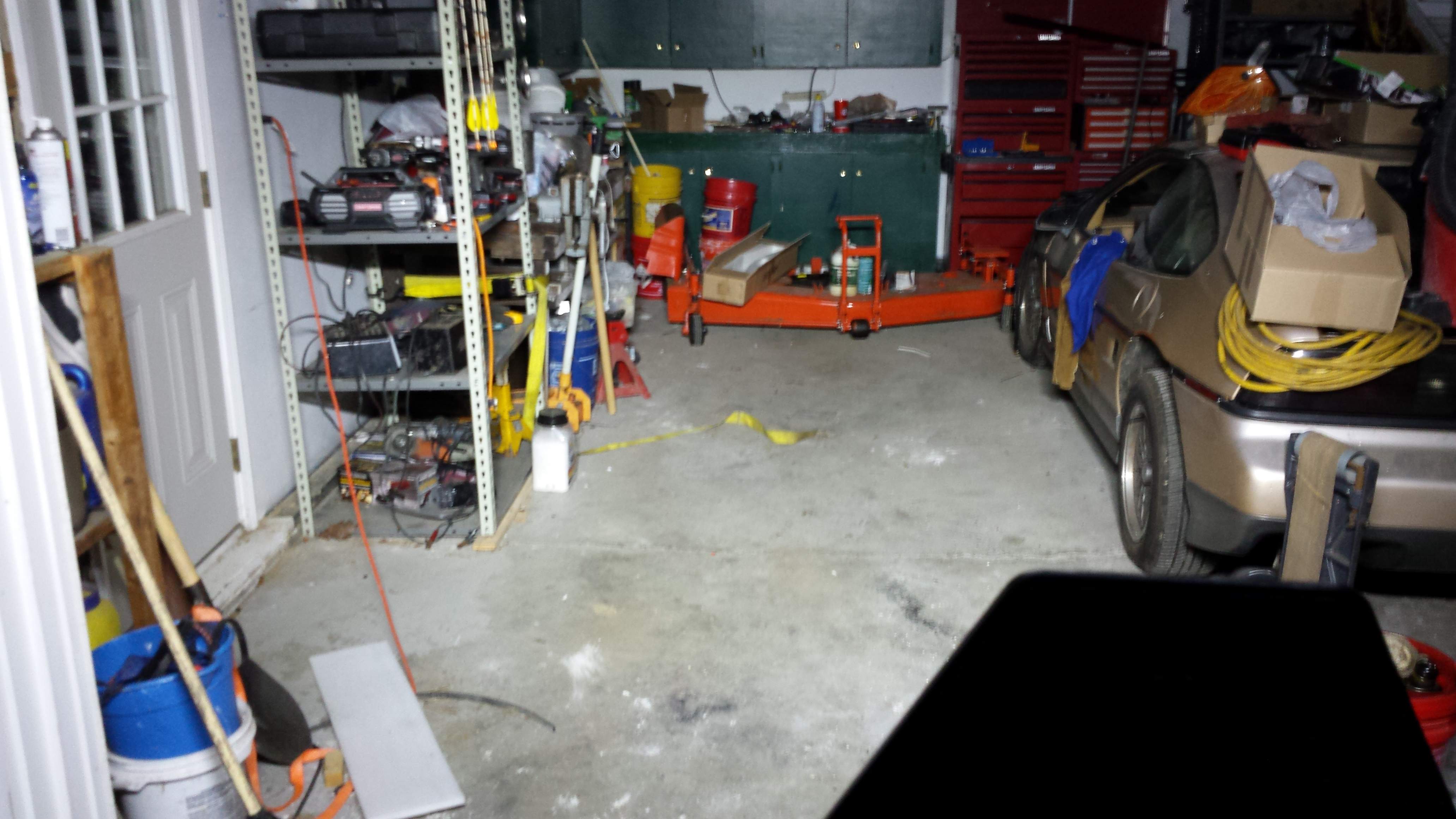

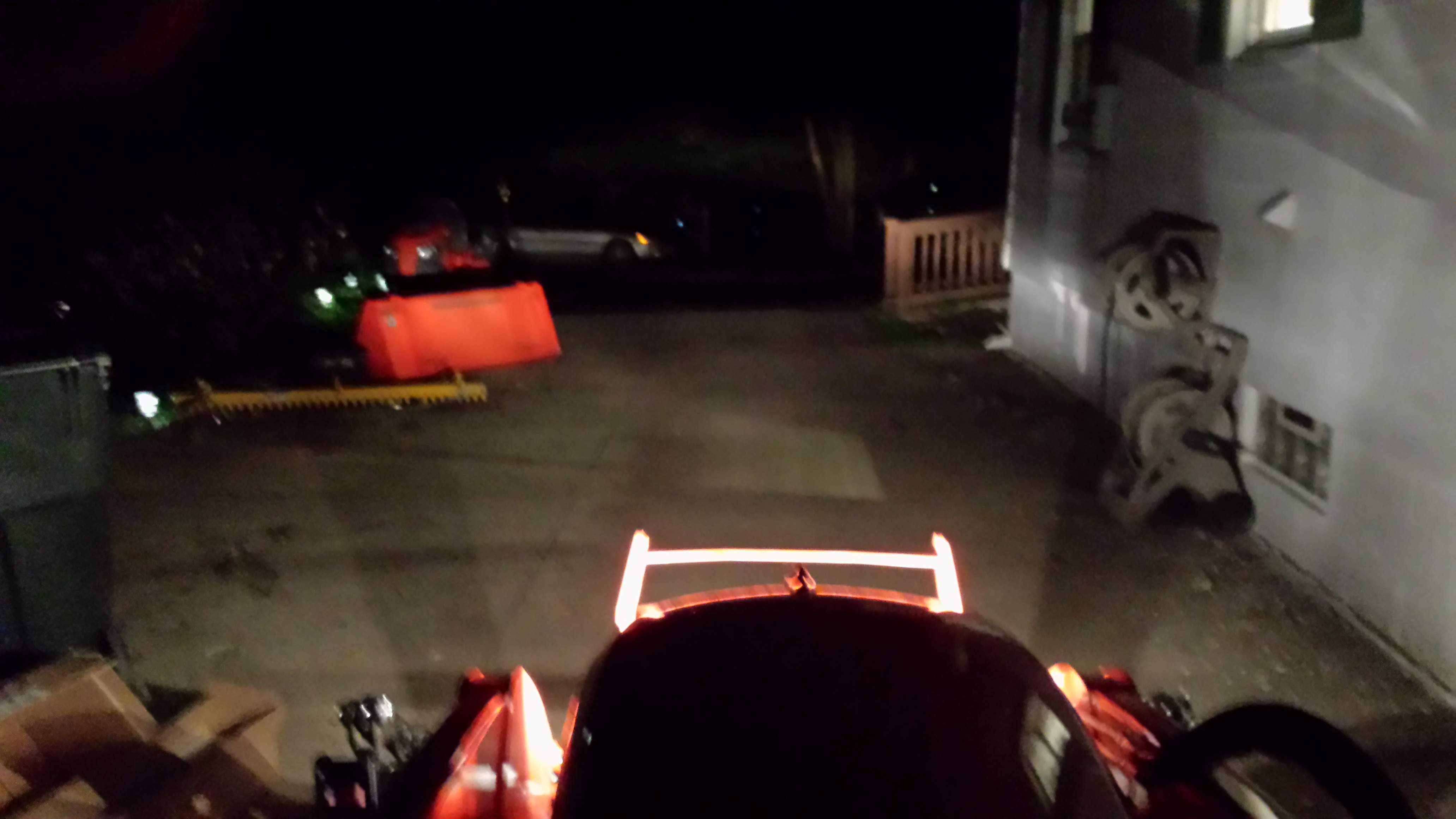

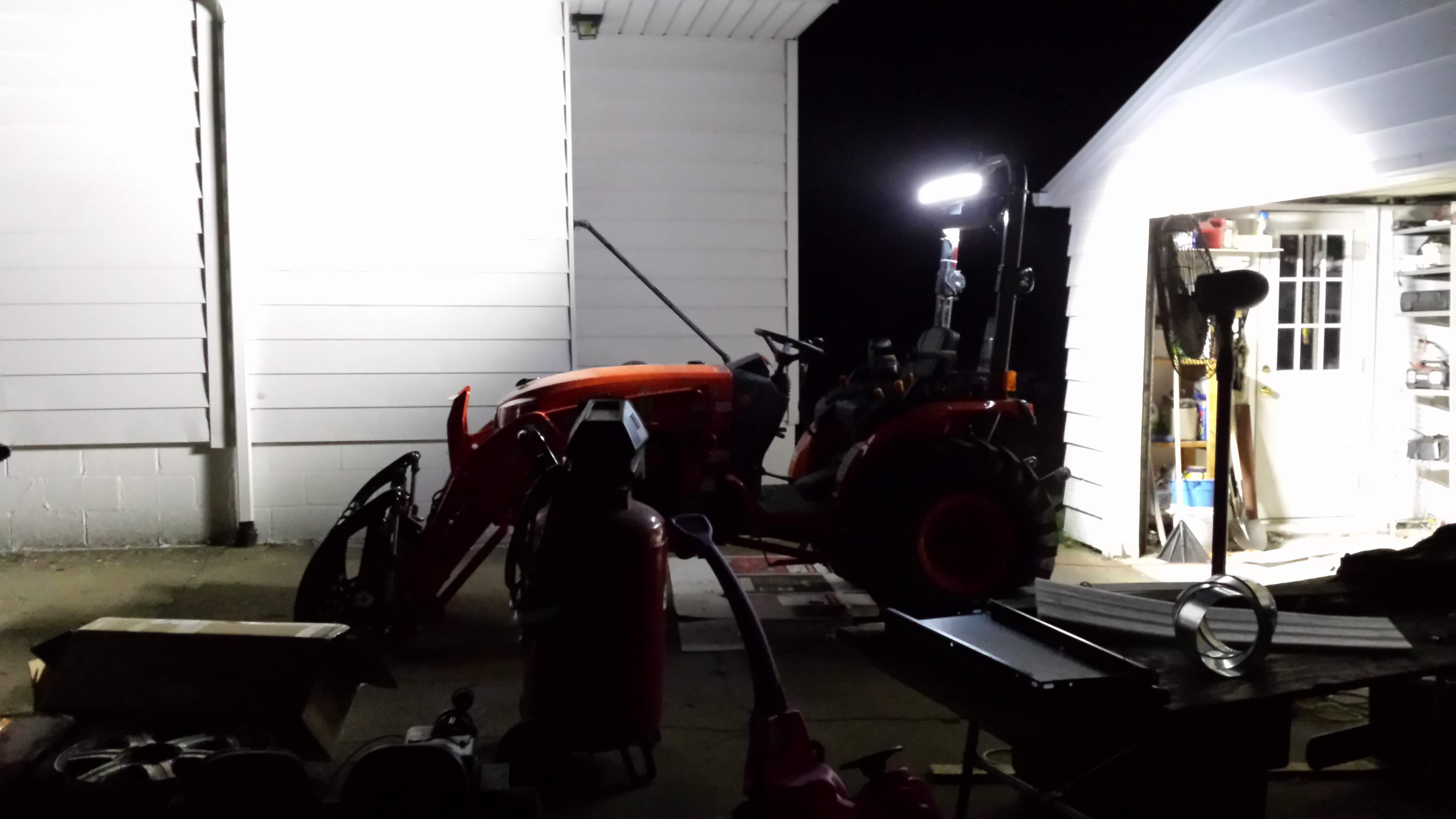

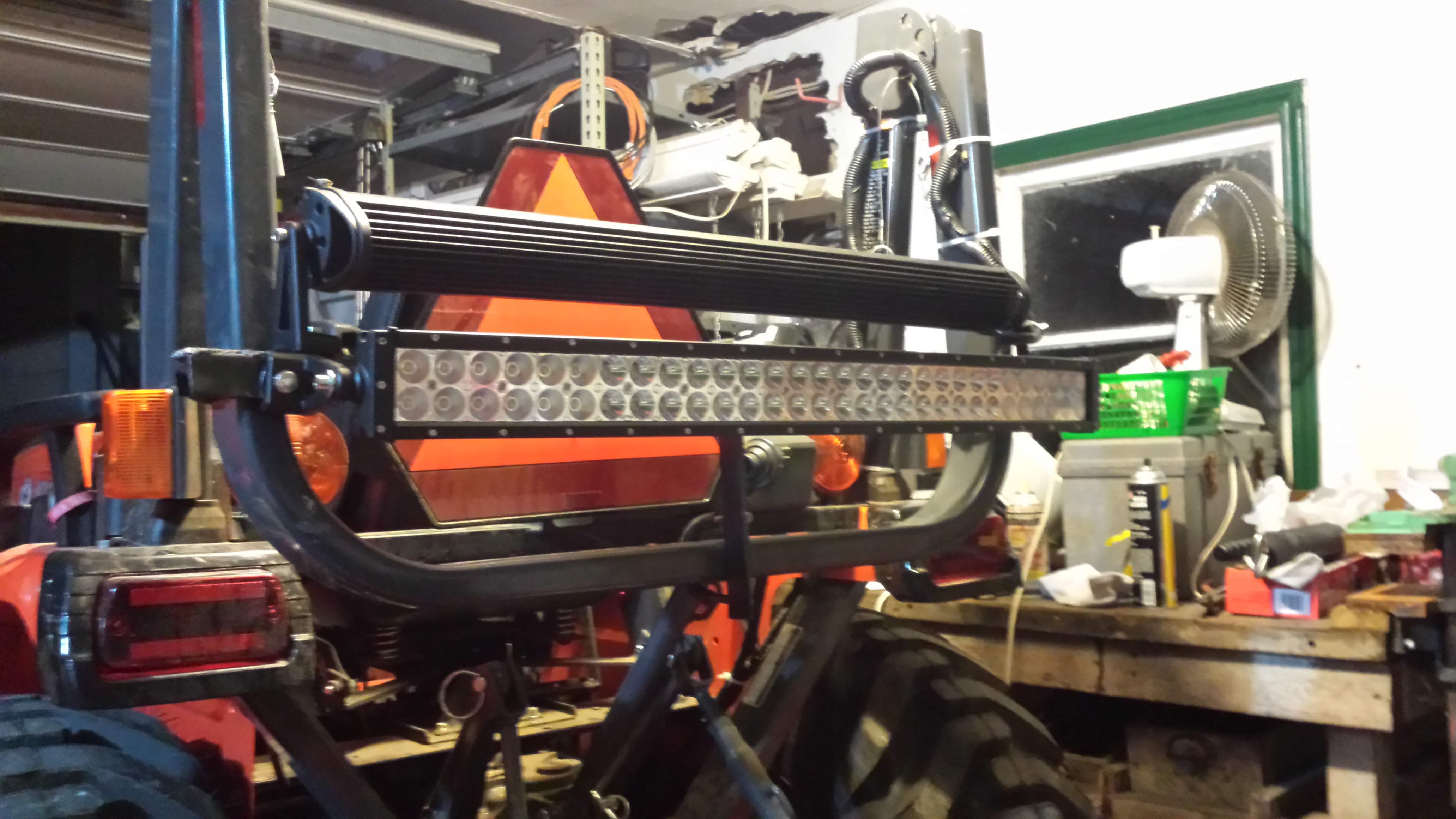

Attached thumbnail is no lights, last pic is front light bar on. Third is of rear light bar. Will have plenty of light as the days keep getting shorter
