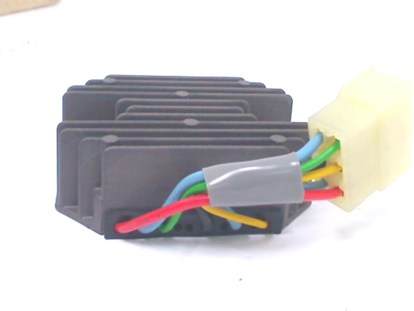

Did you say that your BATTERY light is now on all the time when it's running? When mine did that, the voltage regulator was fried. In fact, it got hot and started smoking while I was using it. I wonder if you've shorted it out while swapping wiring around.
I bought a cheap one off of Amazon and installed it. It worked but got hot and went up in smoke within a couple days. Then I bought the official KUBOTA part and replaced it and it's been fine for a few years now. (The cheap knockoff looked IDENTICAL right down to the markings in the heat-sink casting metal.)

Kubota B2910HSD (Hydrostatic Transmission, 4wd) Parts Diagrams
It’s the “regulator”. Pretty easy install. Goes behind the dash panel. There are diagnostics recommended but I never could get a definite result. In my case it got hot and smoked and nearly caught fire.
I just pulled this up quick. Verify that this fits your serial number etc. in case there’s a serial number break.
I’d suggest getting the kubota part. I wasted time and money with the cheaper part. It looked identical but it also started smoking after a couple days.

It’s the “regulator”. Pretty easy install. Goes behind the dash panel. There are diagnostics recommended but I never could get a definite result. In my case it got hot and smoked and neatly caught fire.
Good luck.
I thought that link would take you to the exact page. Look under “electrical” and then under “switch”. There are two pages and both show the “regulator”.
