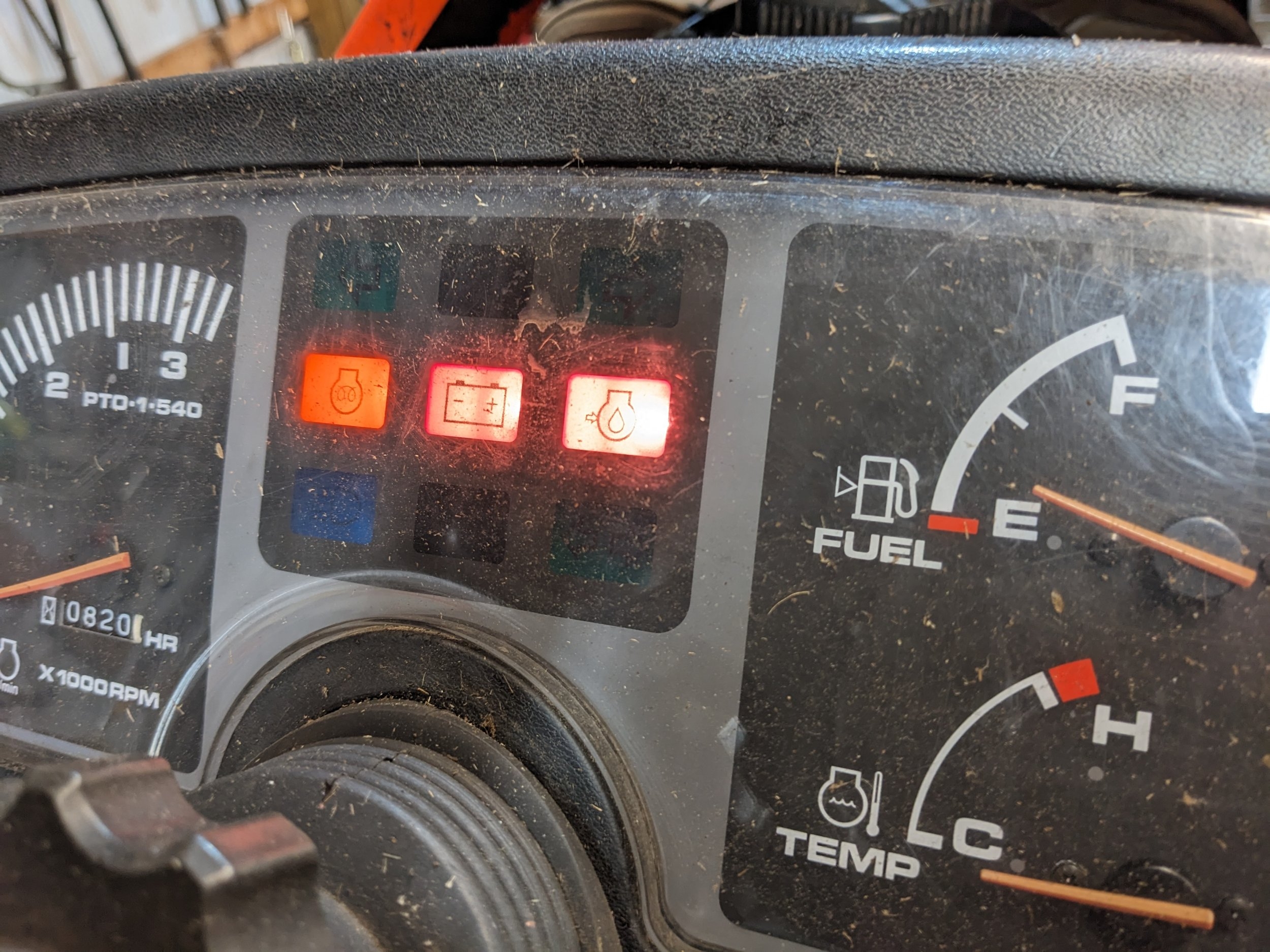

Now it is my turn. Long time lurker in these forums and now I have the problem.
I have a B2100 and a B2910. The B2910 is HST and acts like there is a safety switch problem. I push in the clutch, move the two PTOs to neutral, turn the key, I get all three lights, but no starter engagement.
Here's what I was doing before the failure. I was mowing, using the orange knob handle to the right of the seat for forward speed. I normally just push the rocker pedal. I remarked to myself that the handle gets more speed than the rocker pedal does, and even pushed the rocker pedal down harder than normal. So... I naturally suspected the rocker pedal safety switch.
But I tried the easy things first. I cleaned up the battery terminals, and even tried jumper cables. I would suspect bad battery or connections if when the key is turned to start, the dash lights dim. But here, the dash lights remain steady, which I interpret to mean no starter current draw. I put an ohm meter on the 5A fuse and it is fine. I tried the spare 5A and it is fine too. I swapped them for fun. No change.
I visually inspected the three safety switches.

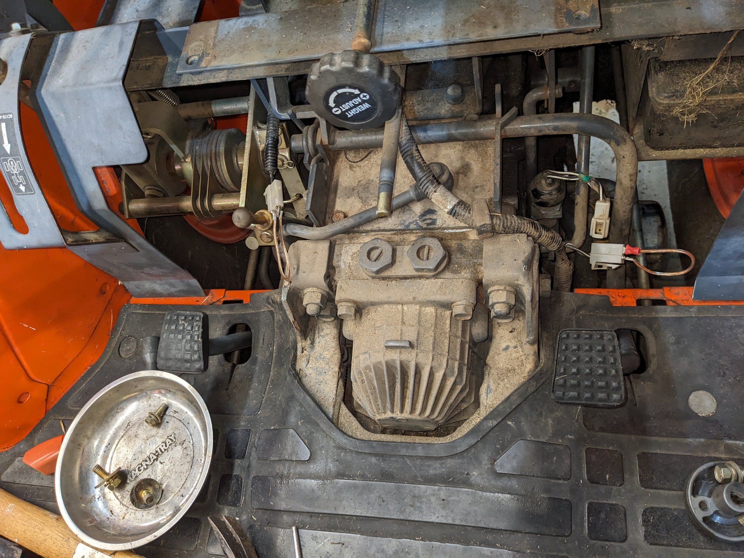

I started with the rocker pedal switch, as the last thing I was doing was pushing the rocker beyond where I normally put it. The rocker pedal depresses the plunger when it has no pressure. I put an ohm meter on the wiring harness connector and got continuity as the pedal sits, and I lose continuity when pressing forward or backwards.
Next I did the same to the PTO safety switch. With both PTO levers in neutral the switch plunger is depressed, and I have continuity at the ohm meter. Moving either PTO lever breaks the continuity.

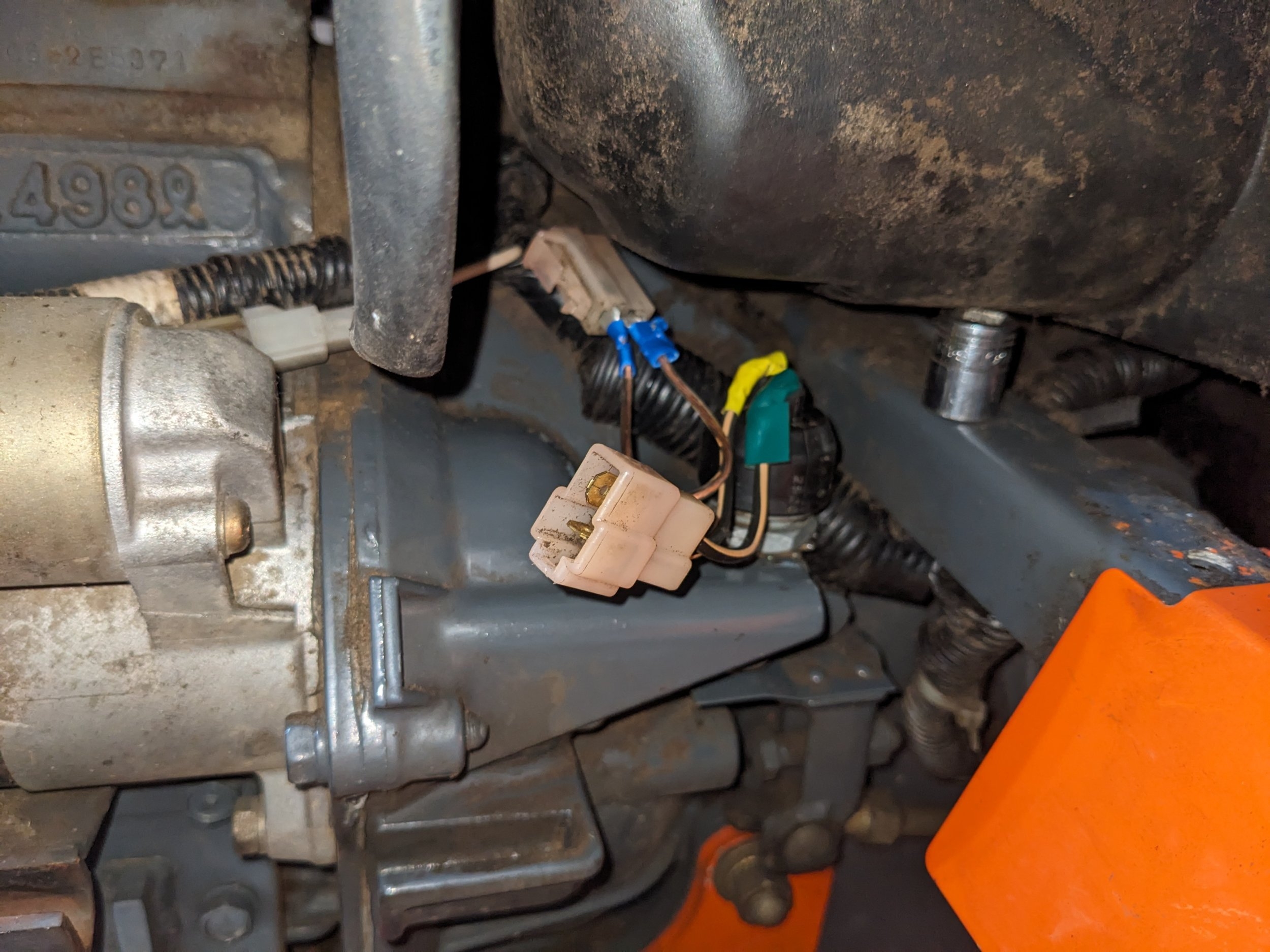

The clutch safety switch had the gas tank leaning on it, and the wires were missing some insulation. I fixed the wires, but that did not solve the no crank problem. I put an ohm meter on the wiring harness connector I have no continuity as the clutch sits, and I get continuity when I depress the clutch. To me that means that all three switches work and are in adjustment.
I next pulled the wiring harnesses from the three safety switches, and one by one jumped them, tried to start, until all three were jumped. Still no starter engagement. I am stumped. What am I missing? Thanks in advance for your guidance.
PS: I did earlier in the year have a mouse nest behind the gauges, with chewed insulation, which blew the 10A fuse. That has all been cleared up. Yes, that is a 12mm socket holding the fuel tank up to give me working space.

I had not considered the speed control lever, as I have never used it and don't even think it is connected to the rocker pedal. So I took a look. There are two levers under the gauges: left for speed control, right for parking brake. The speed control lever is down. I can push it up, but a spring brings it back down.
AIL4fc9t5VNs5-UoXvgqnJE32-ofY_-yfuyv3pX7Kq1j3MXCixdMHwn_-EhnKdjx02nMn2FvXH1rSeepReaa-FAH4up223UQ8A1idKy_U46RTrtjWQI34lutvDyCKLvFYaQO4TDW6_ZT7sXflbZSUuGY25CyOhbg6x8ejBnc34BrxCKvBMzoy-kHtsYx48LhdtX-bVy8Q480Q3rpmAKD1L-hEh_JYMvFrXtGI_gDTQvic7RynJ7fs4yDiCIY-14aSuskxeWvY2QzVaQhNGCKc5p-vRA4q2cv4T6FFrXj5I5-DF5fuhhSUdewE_mY9RX-wej2_UuKidDXOJWZyTyx7ETyD8qcP1bXDSAyZyROf0JcgXM-eE5nY9ES5kKBSAY4M21NEbc24LOUAnhCcA5NI2a_UYDZGYmFA0uRPS292do_CWooUB2xqbIKWXq7tviszwZWI_Zu6UBb1y90p3XLu0oqOnjviyedDrBjOQhou91ubpS6Km4ActSNpGMM4X8Bm4aVEbXXR5nZLBn0AaqLjEq1Xi5BgCK5NS2xcnkJvkIl1ckZFrU_apziZDu8kHq9rKo-Dm_7rNA6S2Ea9xzcu4XvnrKF8ab-kj7brUTGHZt7wNWDOYpmsxY6gUPlKWI0q8ftU_AE3V-sof73rWwwcgdYm83ZNK7nBbVu9DK6zdJiJA8S-UYtwdeWceBqPRZOkrXjLngSaPEUDd4aZ7vWEku52hbQ4EwrMb2sGJwzrU2bx28V70yaOWlGSGGnbIV5Ssoqid_OfXqe-sP8EYzh7-tO14S8xQxz9It3LjAc5kORY_HE4mOLfC0ToR7AG3mkWTz5JTZ5tgCxwX_9Lof6RJN8DoutZZ6P1MOBY5bqIOSgvT-x6TIFP5hQYeFo1eG8IOXeR-539tldS8g85oH2xGNYTvM=w573-h764-s-no
Similar to the way the parking brake lever is connected to a plate with notches that hold the brake, the speed control lever has a pawl that engages a plate with four notches that is welded to the steering support. Inspection at the pawl shows that it one time did engage the top notch, but now it is not aligned to fit in any notch. And since that plate is welded, there is no way it will engage, unless I bend the pawl, which I am considering.
AIL4fc_4gJdRbKtEKuDlHlNgY7phpoqE_AfUj1x2obMV-BL77WpFlTOXNzkxj6dPo3xI6WgB_l0j3vDdFnYydqmAzDPO7H6NT9dqxNqX6PjhhaGaUwZ0jLkKn0QMh4uGF3TOX-PMJZNTDWDdCUpdeF_3QZcNvnK9Icr2gyYpPDj2258xfc4pj2IOvUJYX0bvZRf_wA-wLFVqgwVY5fleKkpD8Rtw4LFCH5EmOwDVGDkFuz6ORCVKehuiP7EulMoqxRY_lVjKAYvMfu4PHjWf2YjKo-oFp4R_LXAN5sa1TWZPi6Zzx_nTphfLn3TB7Wo7e1TGzjwCCVj58Wf-jO62Fpwo2NzexmOJi23HvO5SESO4yurYWvCb0aNO45L09PoHpD4OyR77mDQY49nRtNkVXZrQsPTC8JKafmmor3BoFwQ7nqyehvttRK89OwN0ChPWXAwKSITq-qyiyZapbzuROKUABirTwLz6gNCzkRnzoplHemy4mv2yiaT9wjn4WTzAmWTQFsQdP0G4DRZ4TJVCzvVTu5Ojd1w-EJrpdf-fJjoTzQ8dA1bm7bchebuid-_uKsNNuhJ2zT8x0BBXsggLFlTBl4O4MweqC-AxO4vvaad_Dohdn3anW4lMCqPEKJ-RsprQKrasbicgbDWZ5sXzmEwrVkqT1BEflDWkRtWPleI3V2EeWnneBT6_GCX0UA47K0NJGGOiXGOlCqfD7SJjh-YCnDENd_E9_swNLMhXFdibux4DYs95OqmIkOsPImtT1fHiU2A8t1r904UMTVcUdG4LIYYLq201lXlcASvG_tYWSR98u77gibp7jKls-4ff6JZZ2vICSnSpCBLxVd7t52MmiqcMC1MIXvXCg3NSMc66VKg2NpWaES6s4ybgfqKSdW-_oo8baQs_UJSrdAOJ0eUXFks=w573-h764-s-no
The lever is connected to nothing else. I looked for a rod that went down to the rocker pedal assembly, but nothing is there, and I don't see holes where something is missing. I don't see how bending the pawl to fit into a notch changes anything.
This leads me to two questions: The first question is how is the speed control lever supposed to work? Am I missing parts? The more immediate question is, with all three safety switches jumped, could the speed control even stop the starter from engaging? Thanks for your advice.

I just tested the starter. It is fine. The main terminal on the solenoid has 12V all the time.
https://photos.google.com/photo/AF1QipPPvoO1LcCry9pzOe78in7VezUo3CQHEjZFuW8U
The ignition spade has zero volts all the time, even when I have the key in the start position. A jumper cable from the battery to the ignition spade cranks the engine. That leaves me with good battery, good starter, but something in the safety switch circuit that keeps the ignition switch from sending current to the solenoid, even with all three safety switches jumped. It could be the ignition switch, but like everything else, there is no reason to think that would go bad all at once without any warning.
At this point, I am tempted to run some 16 ga wire from the battery, to a push switch I mount under the dash, and to the solenoid spade. Pushing the button will start the tractor. The tractor is 22 years old and needs to work, and both it and I are getting too old for this.

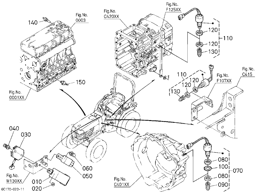

Your photo didn't make it on this posting . . . What ignition spade are you talking about? On the starter switch itself?
What about the starter relay? It's part 50 on the diagram in your previous post. Any change in readings there when the key is turned to START??
