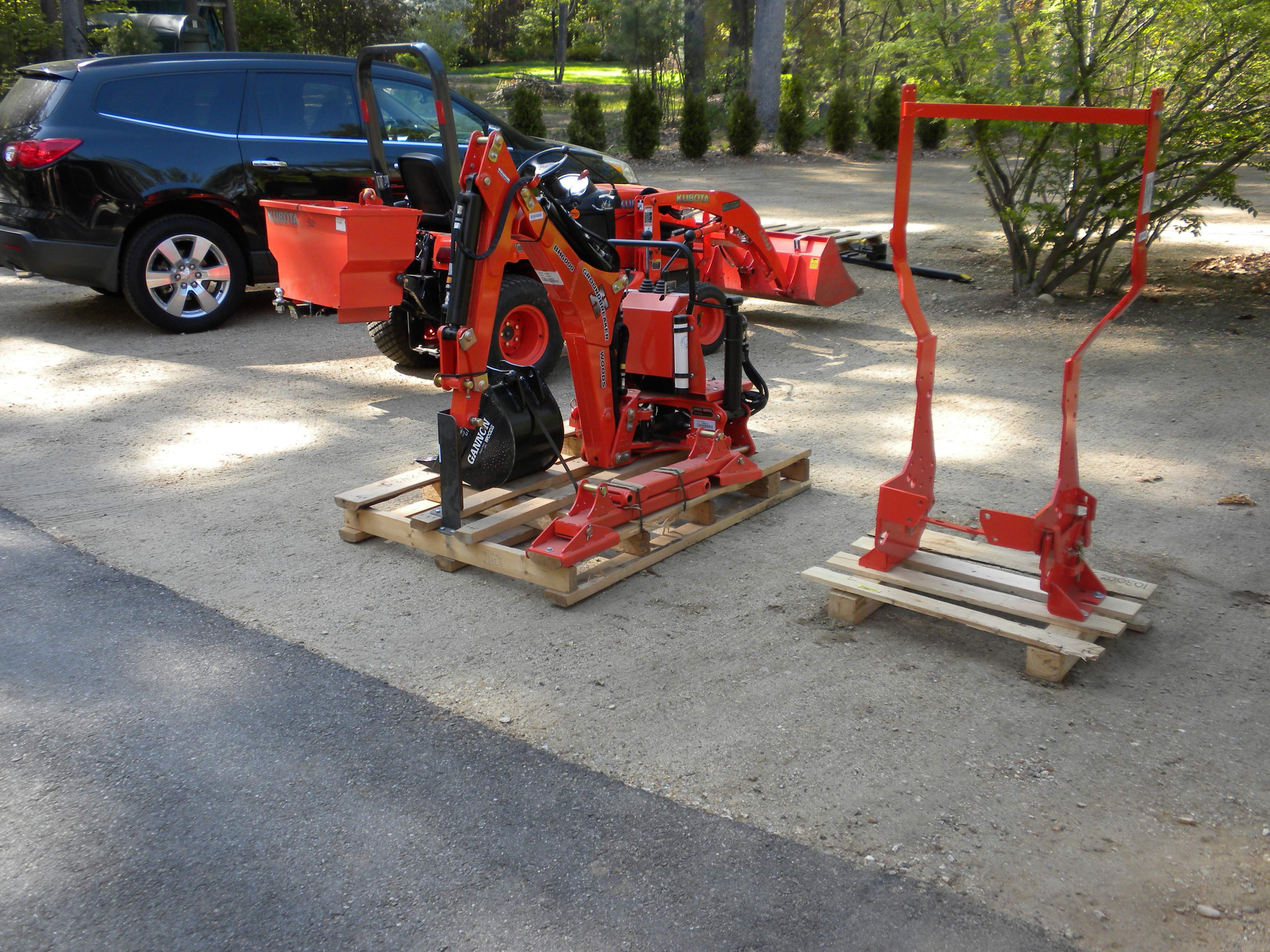

100_1427.jpgHi folks,
I purchased a BH6000 from Rosseel's about 9 months ago and have nothing but good things to say. I saw their listing on ebay but choose to contact them direct. They shipped the backhoe within 2 days of the purchase. It took one week to ship here to southeastern ma and the shipping was very reasonable. The unit was definately new new new. Paint was a perfect match.
Now, I bought the hoe only. I fabricated my own subframe due to wanting to incorporate the best features of the Woods subframe and the Kubota subframe. I mounted it on my BX2350. It works great. I would recommend Rosseel's without any reservations.

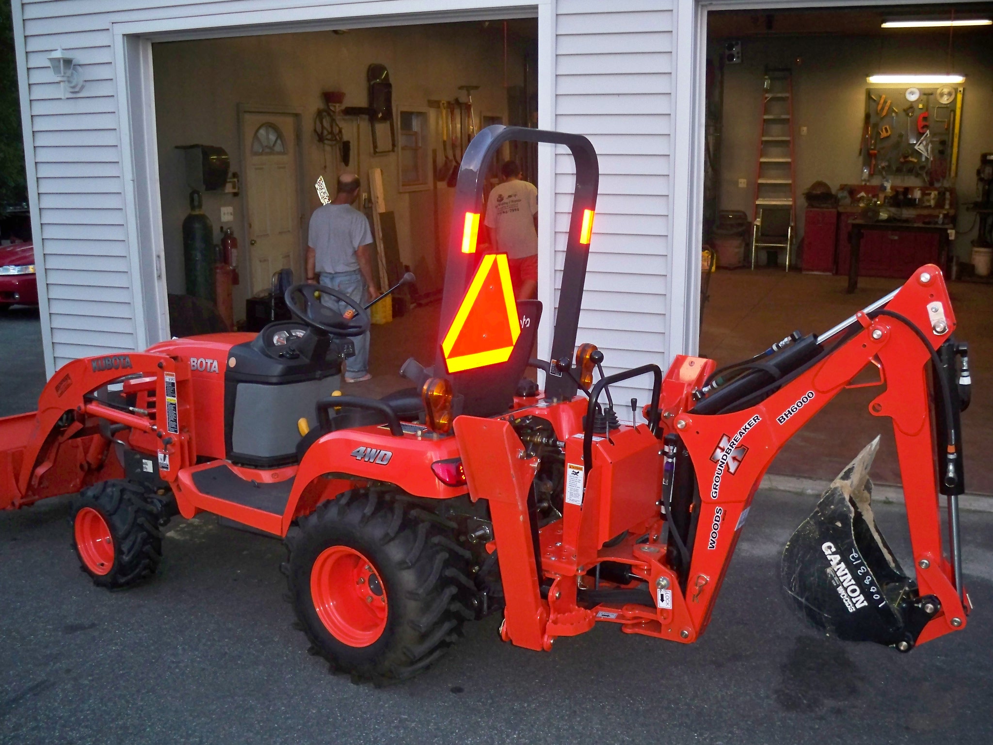

Hi All,
Well the backhoe is installed and working great. The install was not as clean as I would have liked. There were a couple of issues with the subframe which makes me think it is not meant for the 2360 even though Woods engineering told me it is the same as the 2660. The first issue I ran into was the guard for the hydraulic fan. I had to remove it and modify it because the subframe design did not allow it to be reinstalled. The other issue was no bolt holes for the platform supports. I had to drill them out myself which is no big deal, just an inconvenience. The hydraulics were straight forward and went together fine, but the seat support design is terrible. After swiveling the seat around and lifting it into the operating position, there is no way to lock it in place so if you lean back, the seat falls back down. The other seat issue is the OPC wiring loom gets hung up when sliding the seat back and forth and I can foresee the wiring getting yanked apart at some point. I am looking into options to improve this.
Even with these small problems, this backhoe is a real performer without a doubt. :thumbsup: I just ordered a 16" bucket to help speed up digging and backfilling. Thanks to everyone for there input and help!
