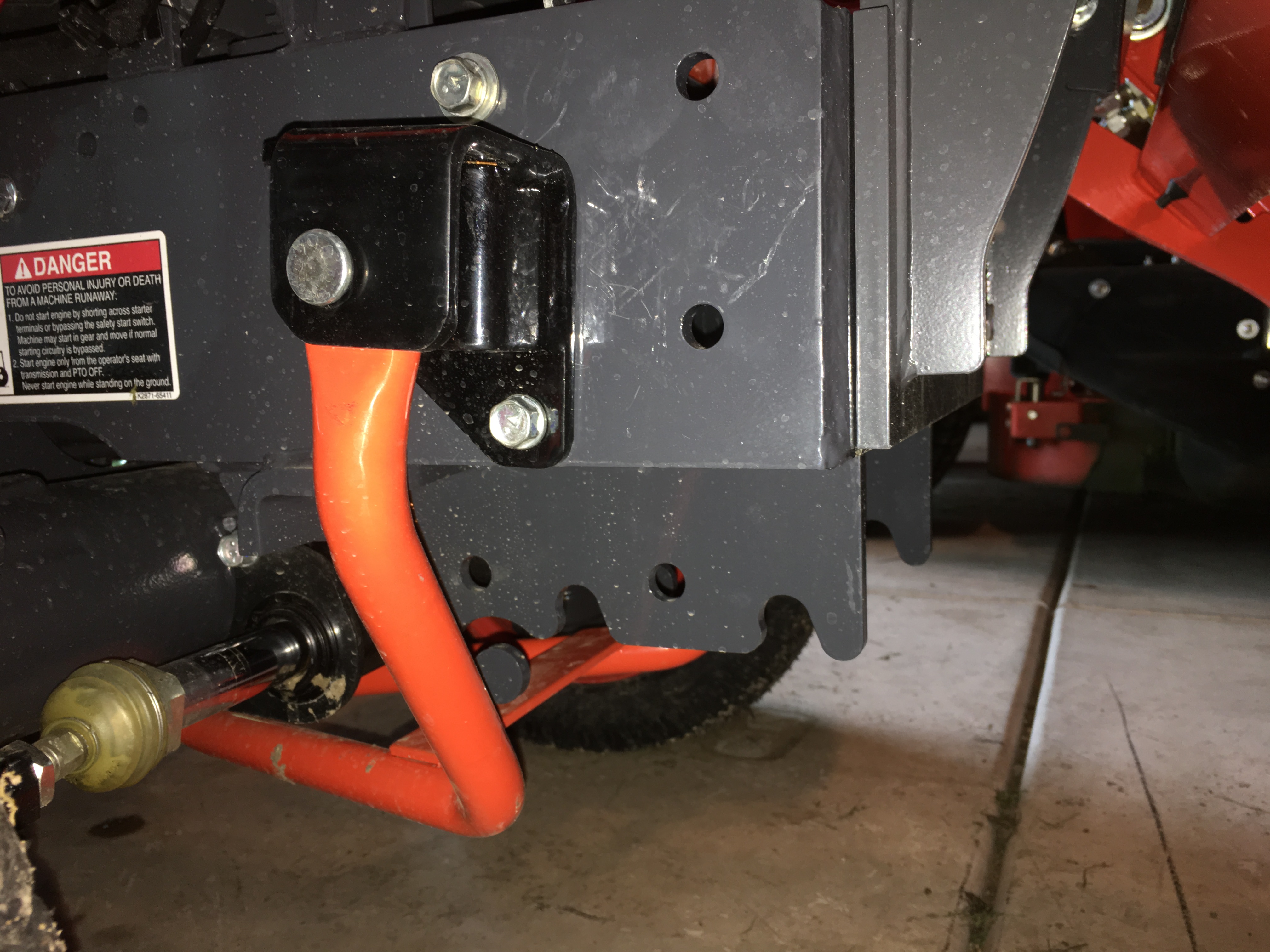

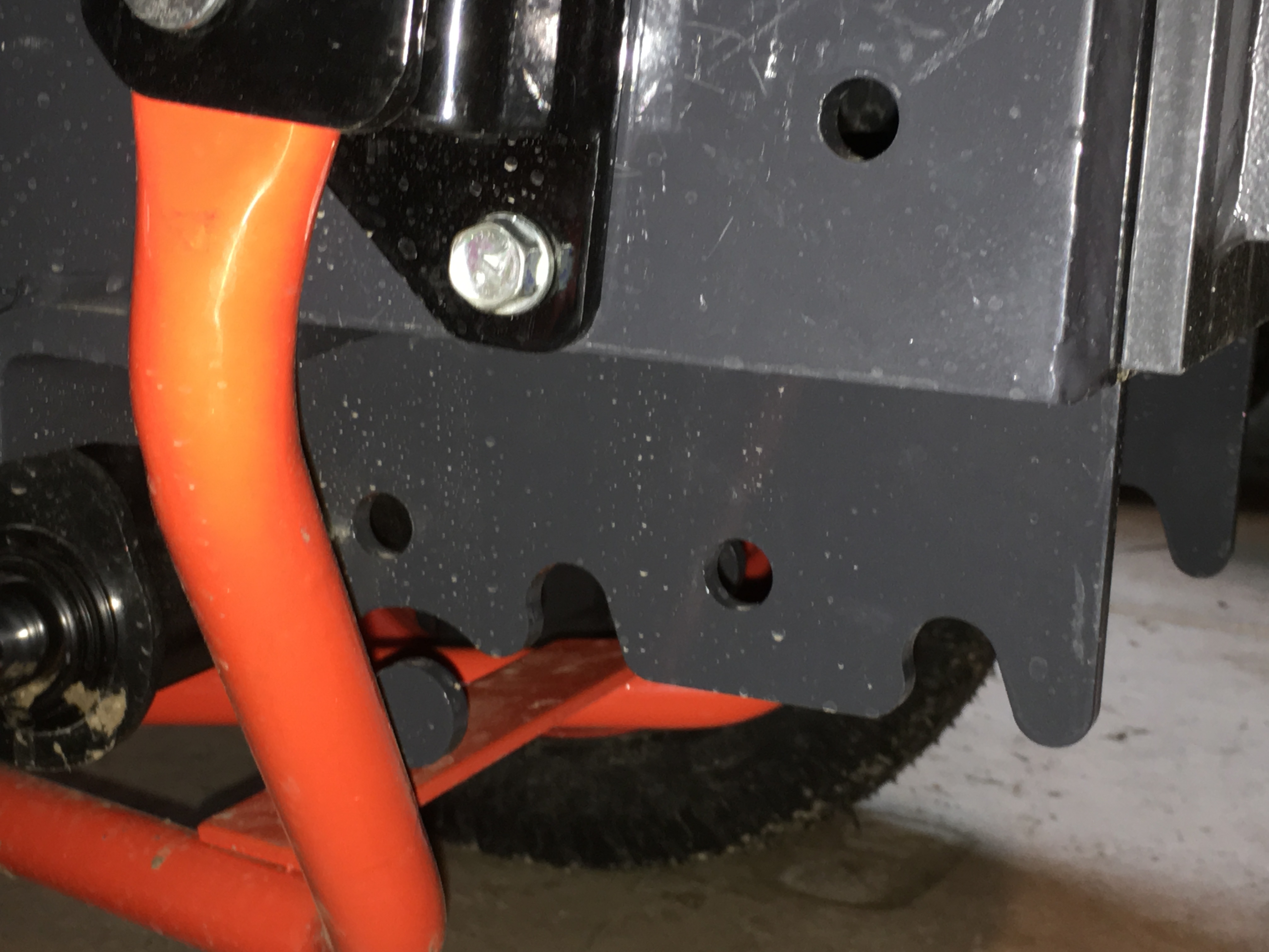

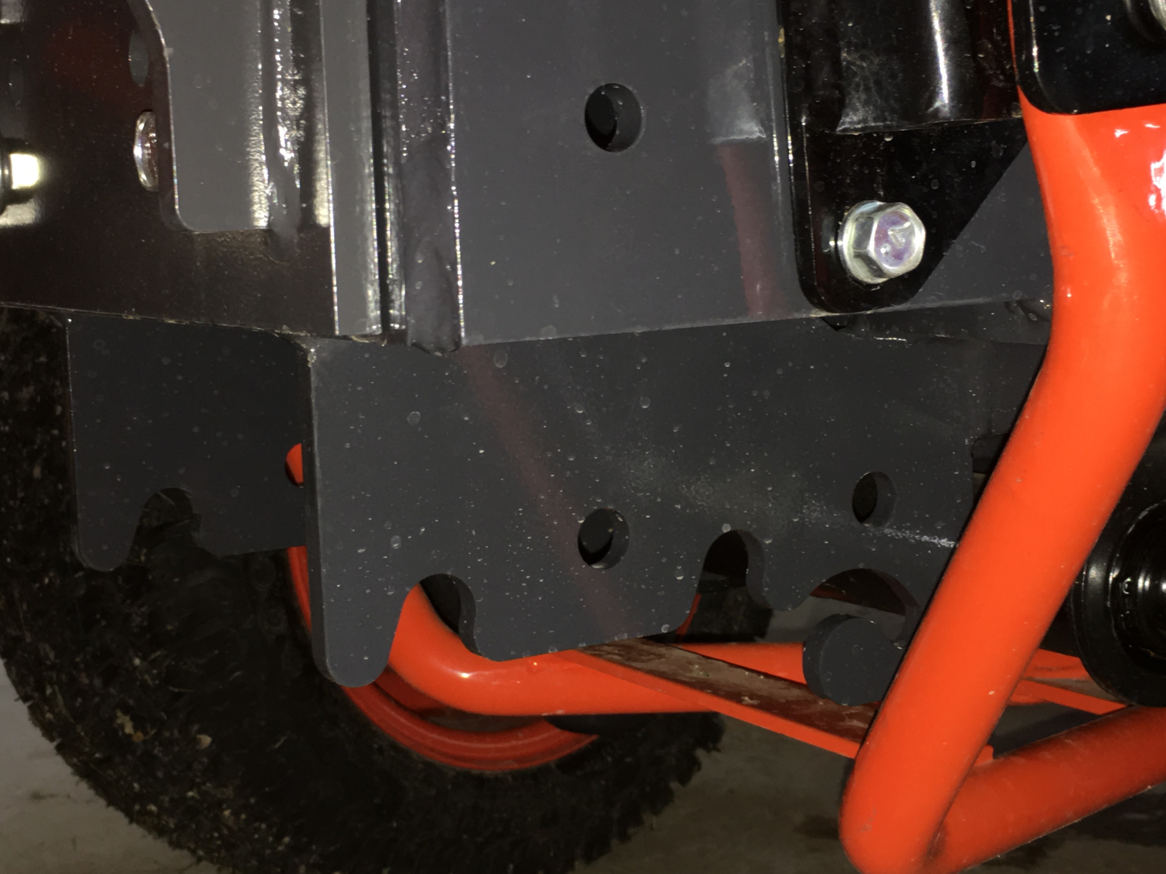

I had same question, here are a few pics of BX 2380 I took yesterday from my dealer. Looks like the bottom of front frame is the same, even has the "hook" for the BX60 mid mower front bar. It does look like the front frame may stick out about 1/2 inch more (I don;t have my BX 60 to check)? If so, would just need to have hole redrilled.

Hi Guys. Before I traded the 2370 I had it at the dealer for some service work as well as getting them to appraise it for the trade. While there we took the blade and quick hitch off my 2370 and mounted it right on to a new 2380 that was in stock. Everything lines right up we didn't need to do anything to make it work, no drilling at all. As I stated before the only issue you run into with this setup on the 2380 is that you can't fully open the hood with the hitch on. You can get it open enough to check oil and clean rad screen. One other thing that came up was the hydraulic fittings are different so they changes the hose ends from the old hitch and blade angle hoses. When I picked up the tractor they had the mower on and the blade mounted, so you can have them both on at the same time. I have the blade off right now as I don't it on right now. I can put back on quickly take a pic if you need.

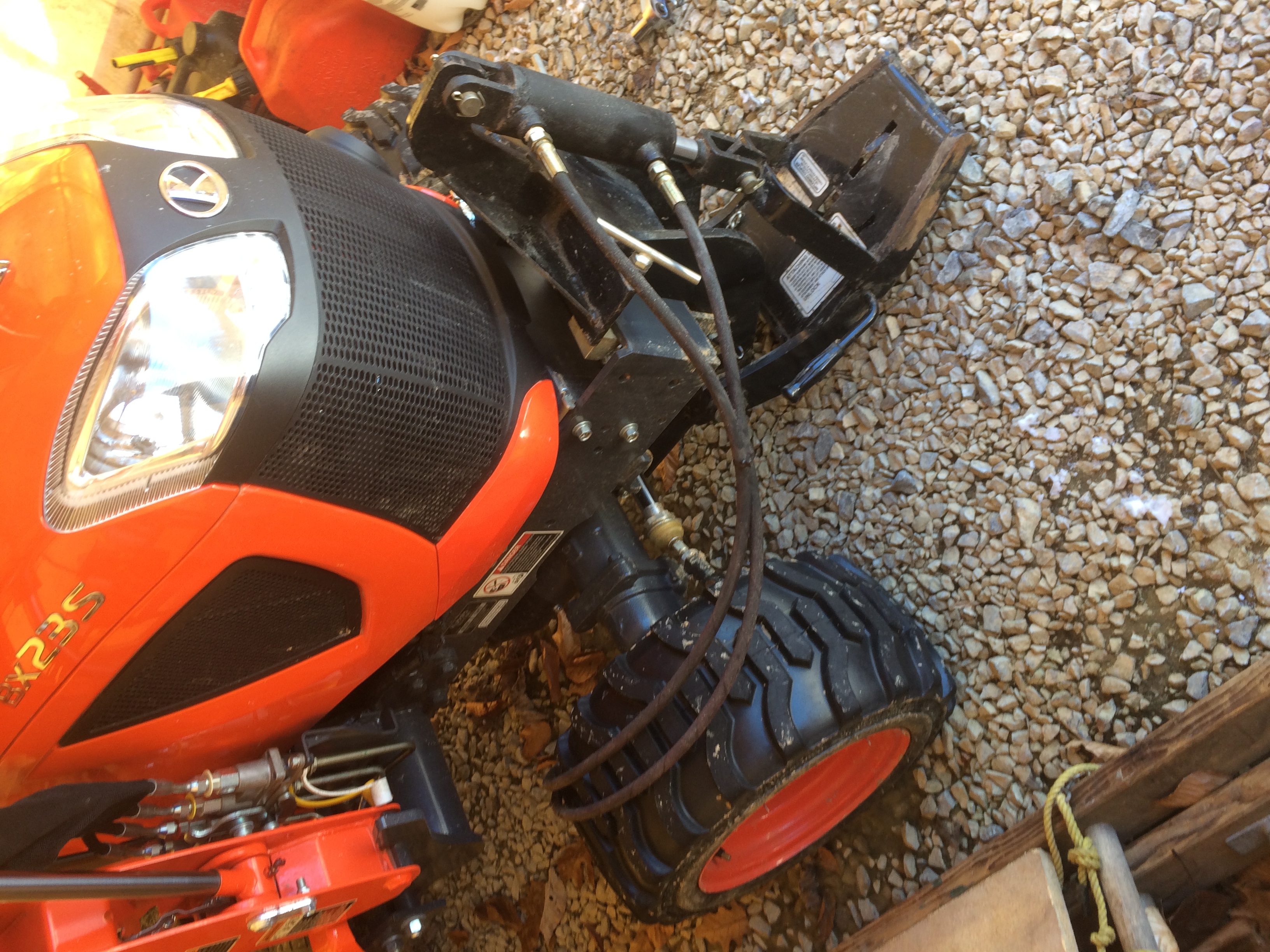

Hi I am new this site but been coming here a few years for good information about tractor. I recently traded my kubota bx2350 in on a new model kubota bx23s. I was following this tread because I still have BX2751 quick hitch for the BX2750 snow blower. I was told that it will still fit new tractor when I bought the tractor. I was informed today that it would not fit the hydro. If anyone knows if bx2751 hitch fits bx80 and what are the part number for the hydro connectors?

As Trops said in Post #12, despite what Kubota indicates, he actually tested and found out that the 2751 hitch will in fact mount on the front of the BX2380 without any major modifications, other than impacting the hood fully raising. You would just need the dealer to change out the hydraulic hose coupling on the hitch (which controls the raise/lower function) to match the new quick-detach fitting used on the BX80 series. Your dealer's parts department should have the parts diagram for the BX fittings, and should be able to change the fitting fairly easily and inexpensively. Let us know if you make the change, and post a picture!
   / Kubota BX2751 Front Quick Mount compatible with BX80 series? #16
Well took me few months to get everything in from kubota for the bx 2751 quick hitch conversion. It does fit on the new bx 23s. I did take some picture to verify it.
