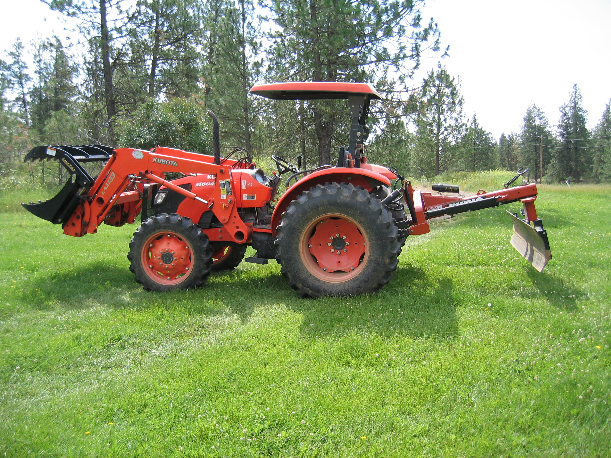

My Kubota M6040 weighs 10,100#. It has R-1 tires. I definitely try to stay off my lawns.
I have a Fit Rite hydraulic top link. Had it six years now. Not even a single drop of oil leakage. You will get what you pay for in this area.
Want greater lift - look at the M6060 rather than the L6060.
