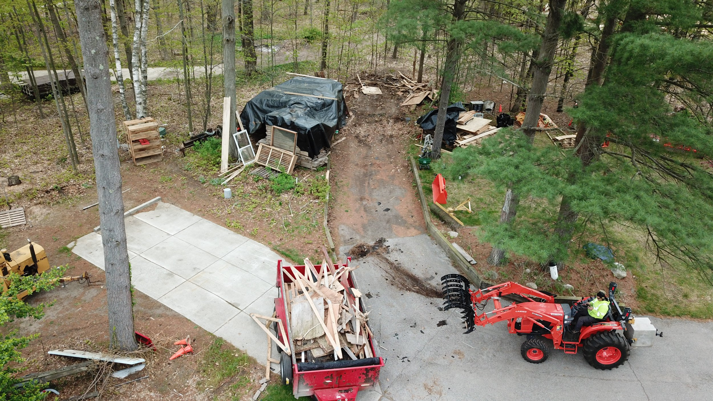

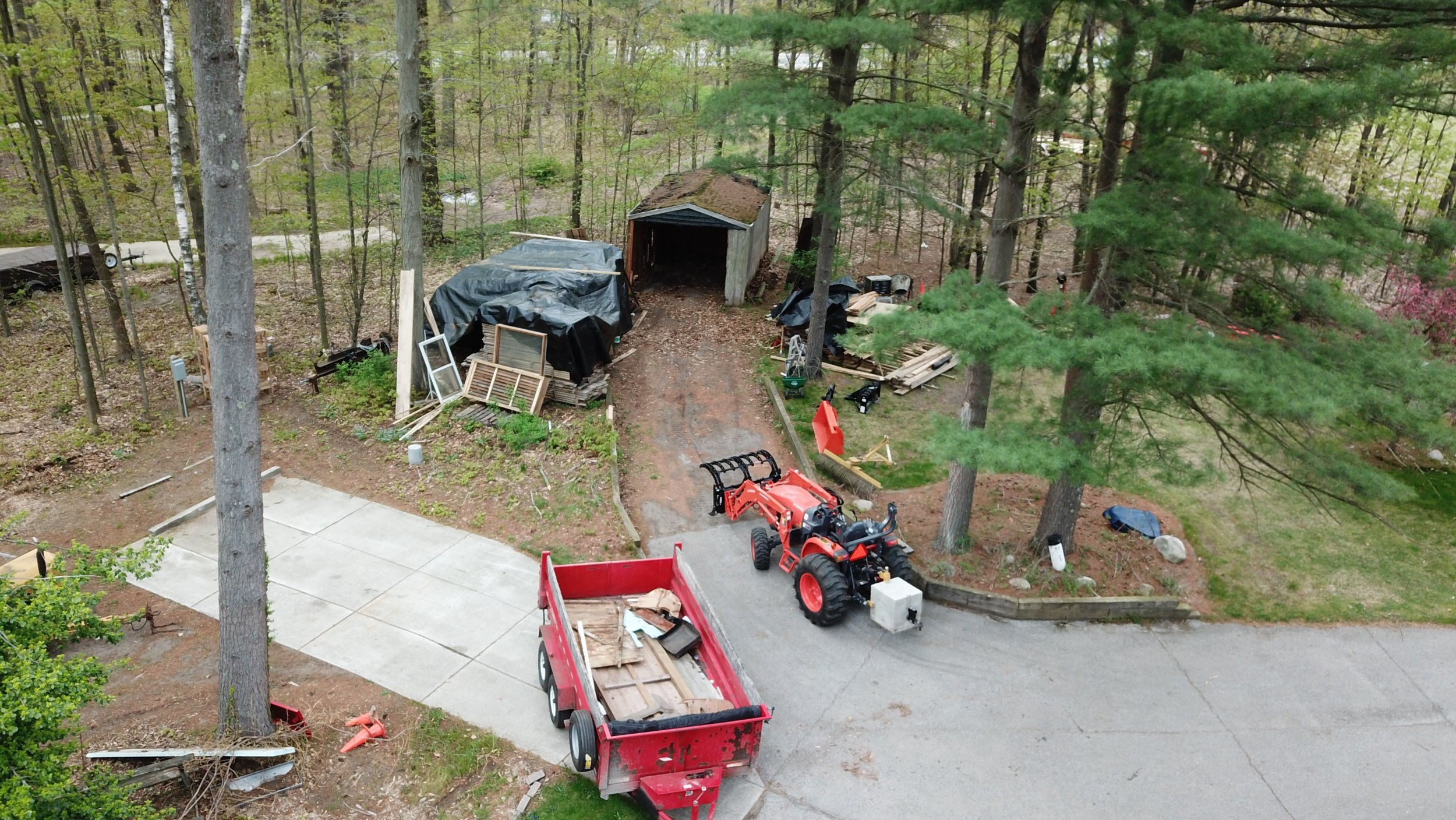

The new machine is great! The loader is definitely stronger than the one on my 5740. So far, I've cleared a lot for a new home, cleaned up my field, done a little light dirt work, regraded a long dolomite path and demolished my old 12'x18' shed. I don't know how I got along so many years without a grapple bucket.
Here are a couple pics of it, before and after. It took less than an hour to have it all loaded up and cleaned up, including sweeping the driveway. I spent more time driving to and from the dump than demolishing it. Now to make use of some of the rough sawn lumber underneath the black tarps to build a new one! Once i get it figured out how to merge two files, I'll upload the video to youtube and post a link.

Fantastic. Thats a sweet machine and package.
