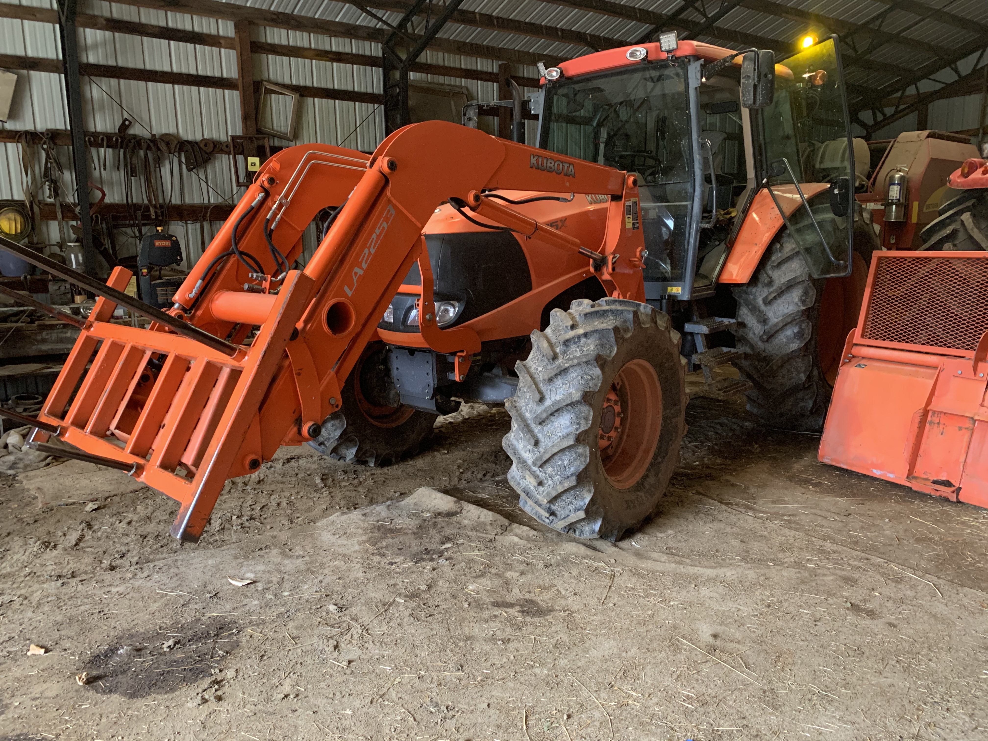

I have it on both my big Kubotas.
Does great job of taking the heavy pounding out of carrying objects with your loader. Enables you to travel faster over rough ground without bouncing the load out of bucket or forks. I would never own another tractor/loader without it.

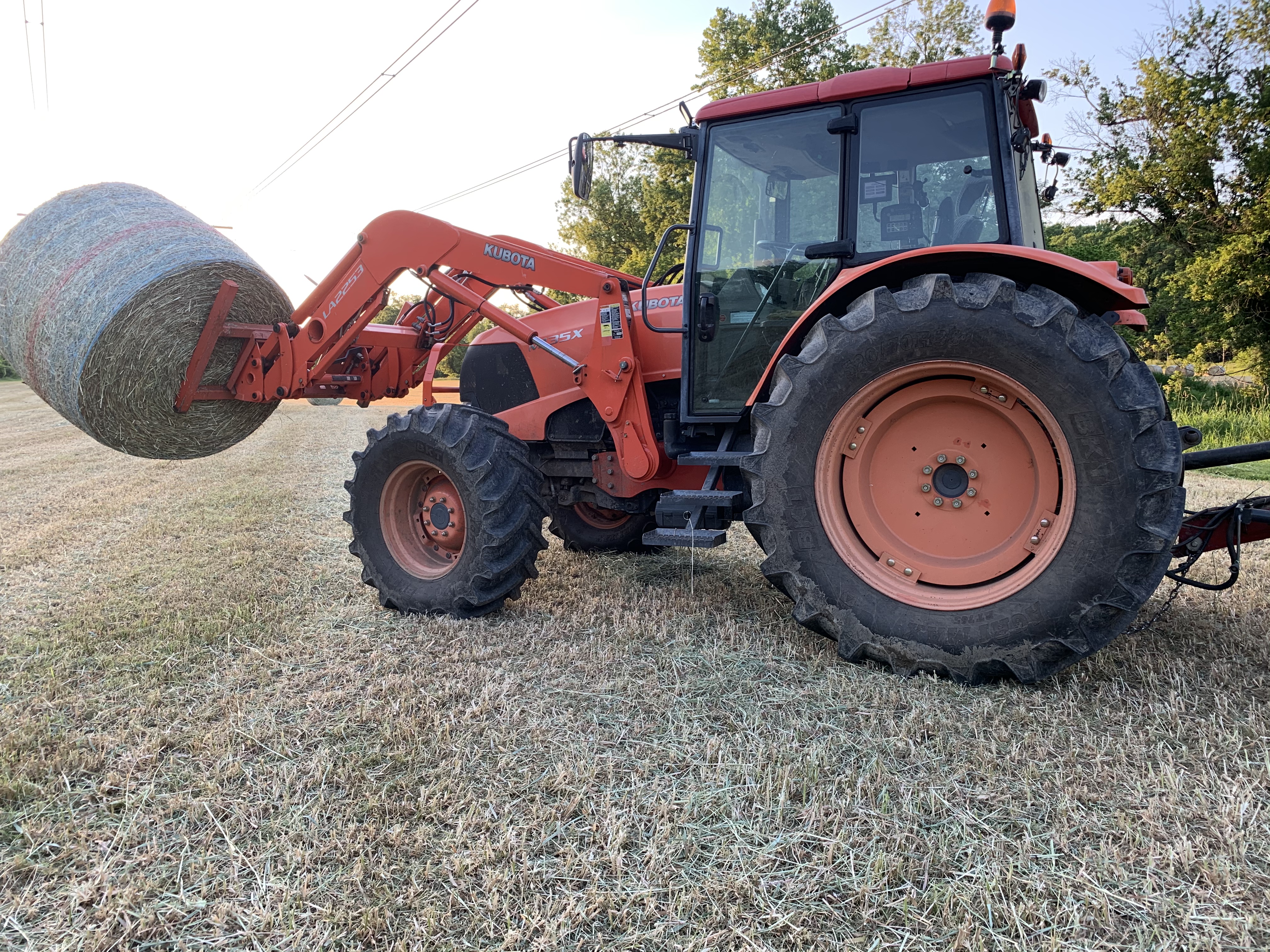

   / Kubota "Shockless Ride", SoftDrive or equivalent accumulator? #6
Nice feature. It is useful on washboard travel or at road speed even empty; anywhere that FELs tend to get bouncy. It takes about 75% of the bounce out.
That should reduce wear on the whole loader & hydraulics....maybe on the front axle pivots too.
JD calls their version "Comfort Ride". It engages/disengages when stopped via a dashboard solenoid switch. The solenoid switch makes it handy.
I'd get it again, especially at Kubota's add-on price. And I'd combine it with an aftermarket Grammer air ride suspension seat.
