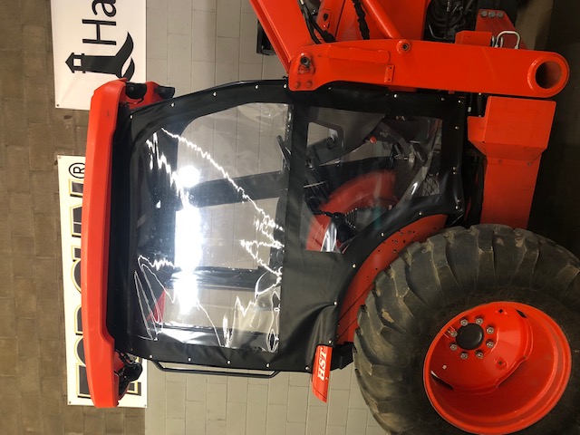

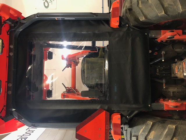

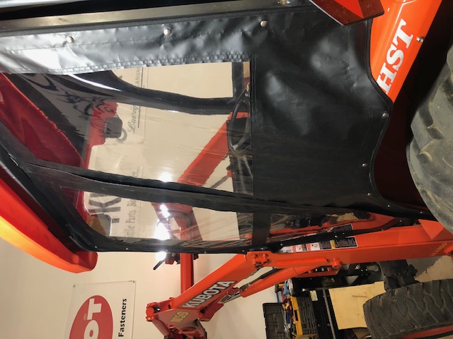

How does it attach/remove? Is it just a friction fit with the buttons? Also do you mind providing a ballpark cost if you haven稚 already?
I like it!
It attaches just like a boat cover - you can take it on or off. He charged me 2186.00 CDN dollars so about 1700 US. Not sure if the cab for the M59 and M62 are the same? I really like the open cab in the summer so it has to completely come off.

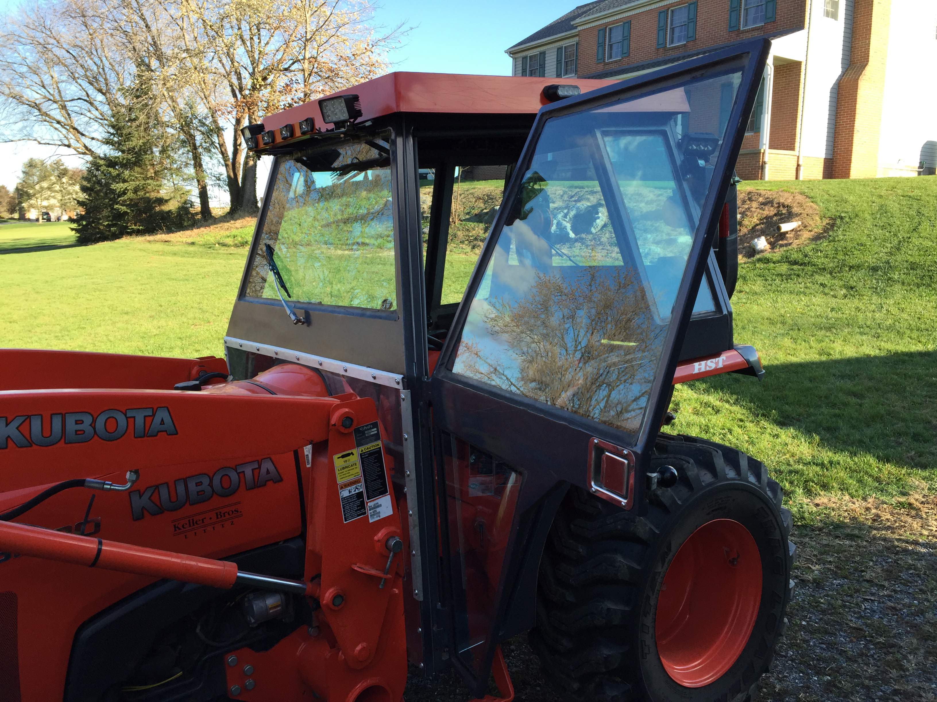

There's no backhoe on my tractor, but I can offer some thoughts on cabs in general. My homebrew cab from 6 years ago cost me around $1,200 and a lot more time than I thought it would. It is all steel and tinted automotive safety glass except for the Lexan below the windshield (an area where it was too difficult to get glass to fit). The plastic strips used below the windshield in the original build became discolored. Lexan can be scratched, but so far has stayed clear and looks good after a few years.
The cab is made in sections that can be removed and the doors are on pins so they are on or off in a minute. The whole cab was taken off the first Summer, but not since. I'd like A/C for hot weather, but for now I just lift the doors off and run a fan. That's more comfortable than sitting in the sun.
The heater is plumbed into the engine coolant and has more than enough capacity for the coldest days.

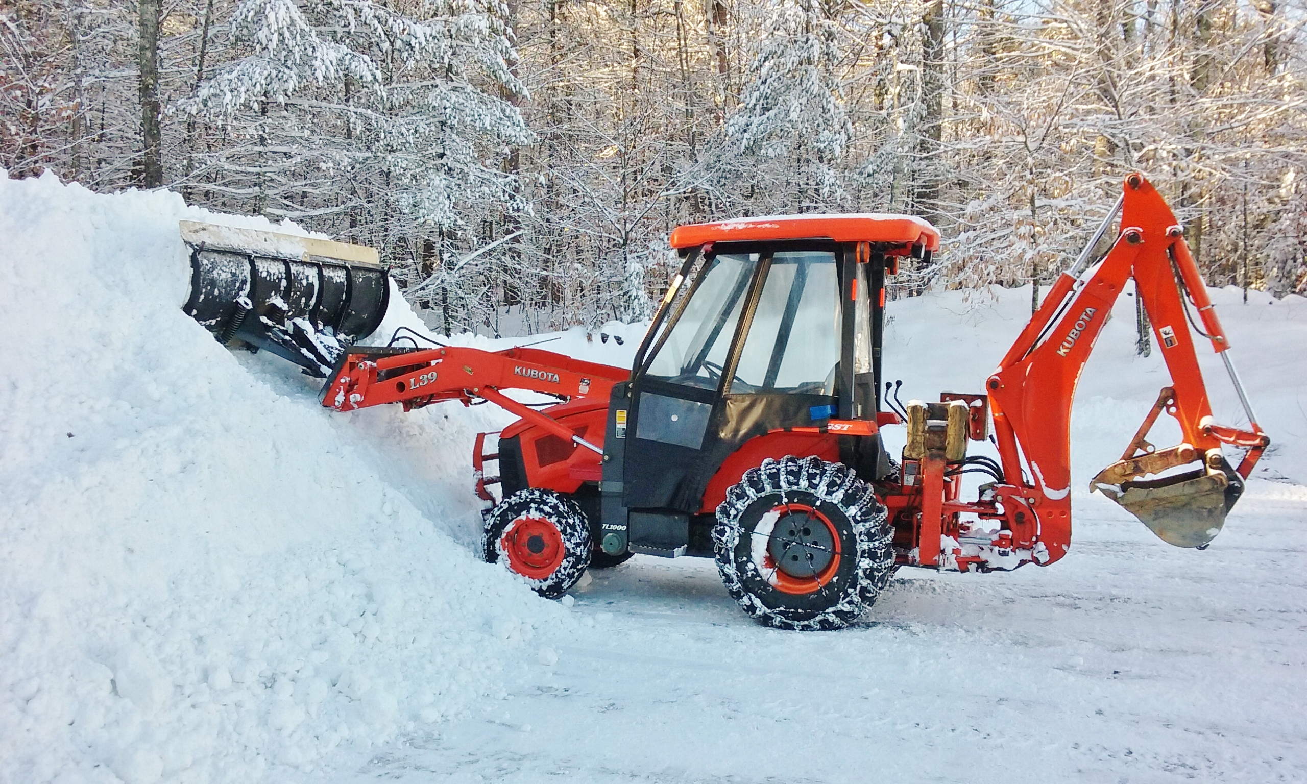

As far as the actual construction of the cab, there's not much I haven't been happy with. The goal was to make it roomy, sturdy and have a shape that was more interesting than a clear cube. You can see in the one picture that the cab is wider than the fenders at the bottom. Although the shape did add to the complexity of swinging the doors, it was worth it to me.
There are lots of homemade cabs on the internet for reference and I must mention "Roy Gage Life on Highway 9" as the one that inspired me the most. People here on TBN were quick to jump in with helpful comments as well.

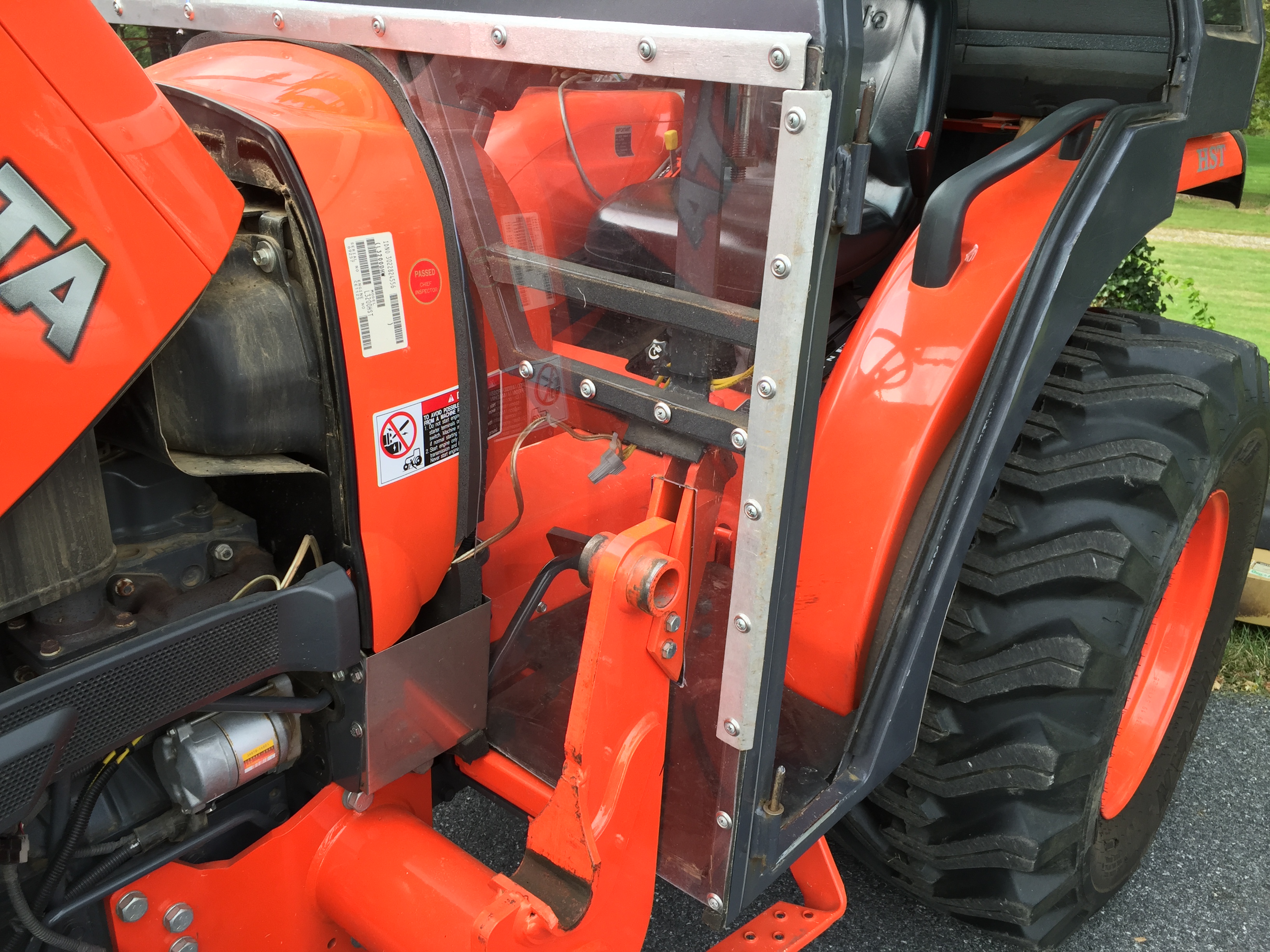

I would have spent the $70-something for the Lexan below the windshield when I built it, rather than wait for the plastic strips to yellow and get ugly.
The speckled paint that appeared to be a problem really hasn't been an issue. I guess when it was allowed to cure thoroughly (kept putting off dealing with it) it is holding up well. This is one time when laziness paid off. I've gently washed the inside of the cab a few times and the speckled paint hasn't washed off.
After stumbling onto CurlyDave's post about having heater hoses burst in the cab, I re-plumbed the heater with copper that extends out of the cab. The comment on skin grafts created a powerful image. It's a much neater install now and the valves are under the hood.
Not so much cab construction, but exterior cab lighting is now all LED. Work lights face all four directions. LED flashers on all 4 sides because I travel about 1.5 miles to clear snow at our church. The pictures below show the different lighting and the Lexan around the hood.

I have a M59 - I am having a boat cover company fabricate a Cab. He is going to use a Auto Glass Wind Shield and the rest will be high quality boat canvas and vinyl windows. i just need to come up with a heat solution. Just purchased a HLA 3000 Hydraulic snow blade for the FEL. 1 Km driveway to keep clear. I will post pictures when it is done later in October.

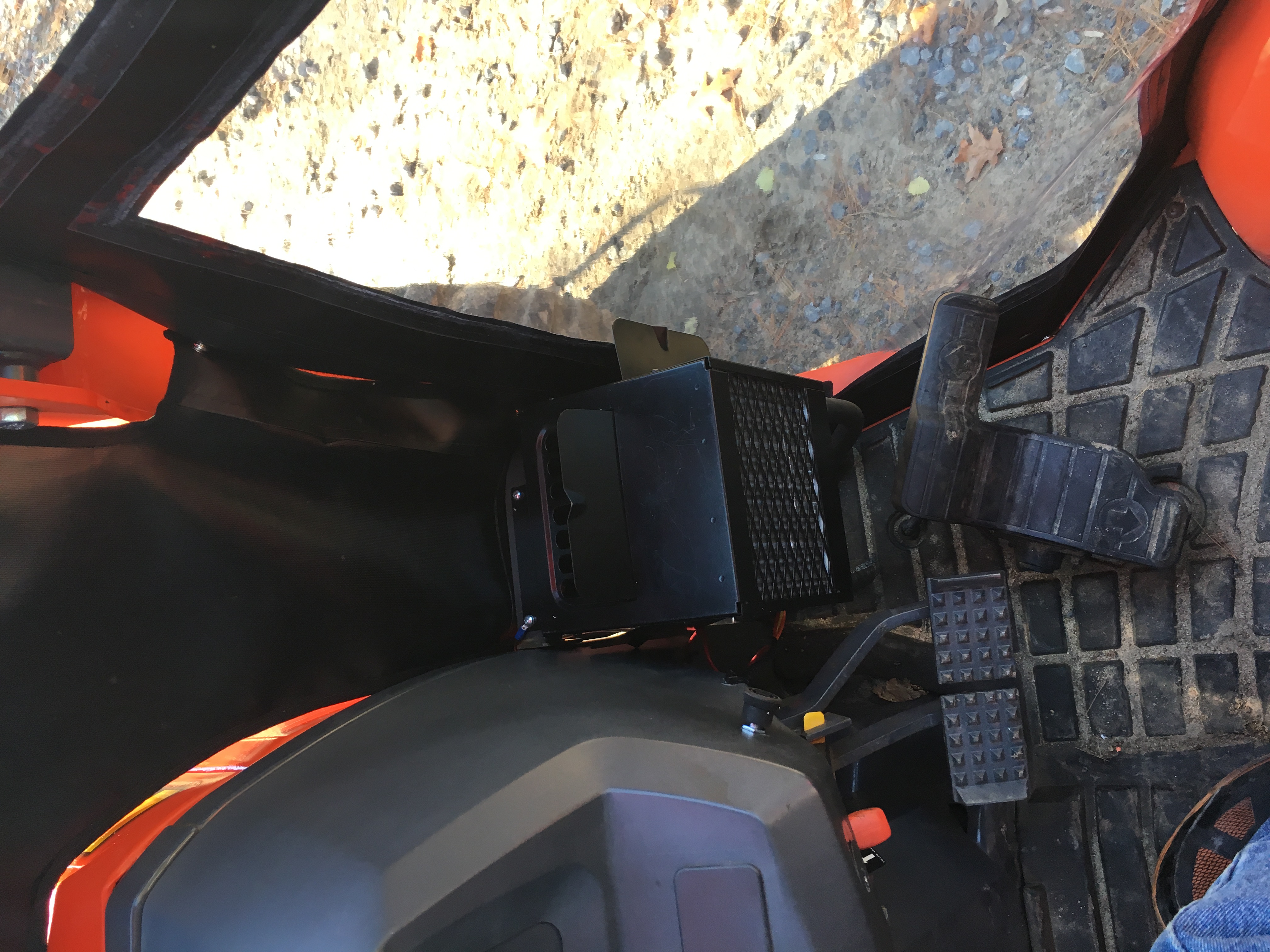

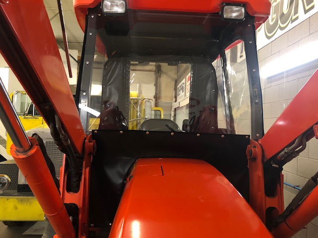

IMG_0935.JPGHeater is installed....Piece of cake to install. Works really well and i am very pleased. Also installed some LED's up front, what a difference. Bring on the snow!!!

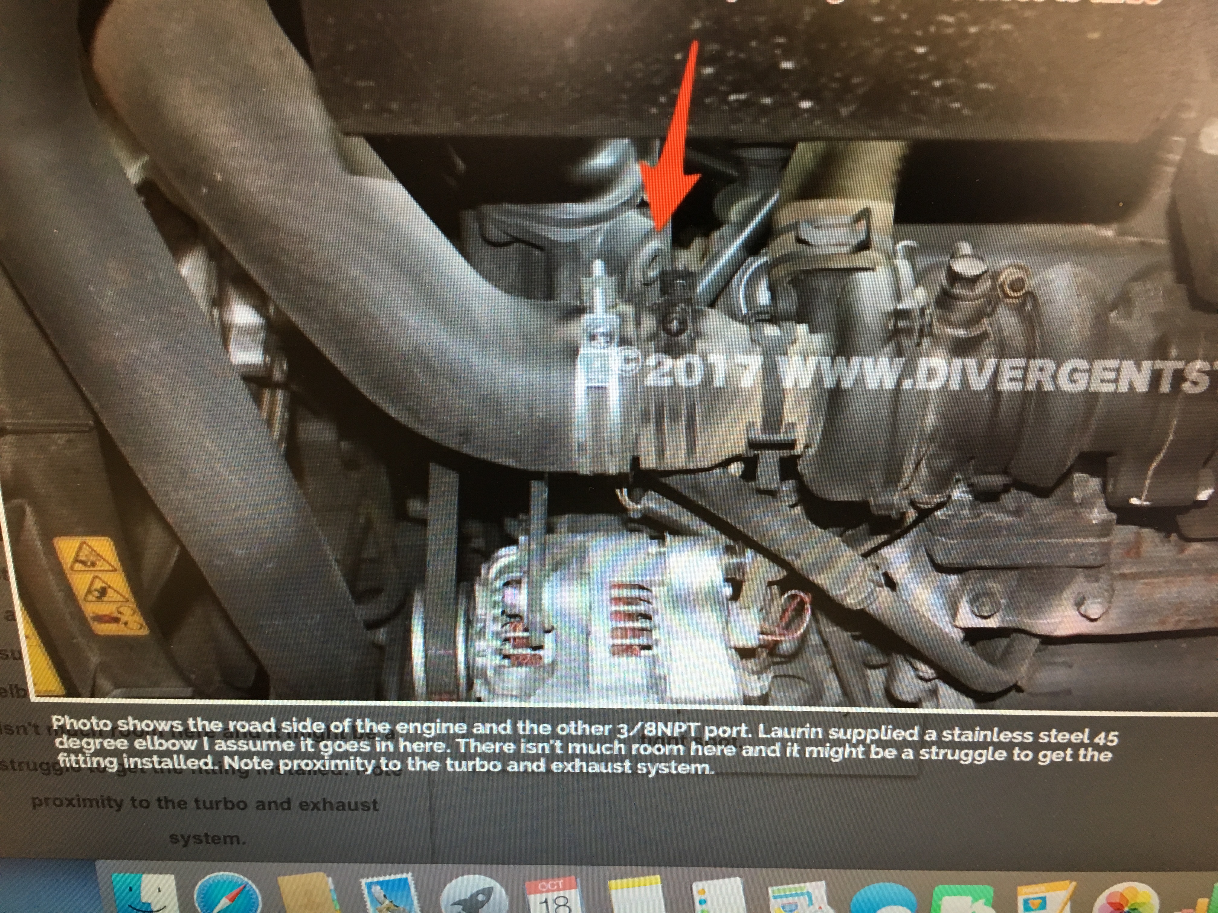

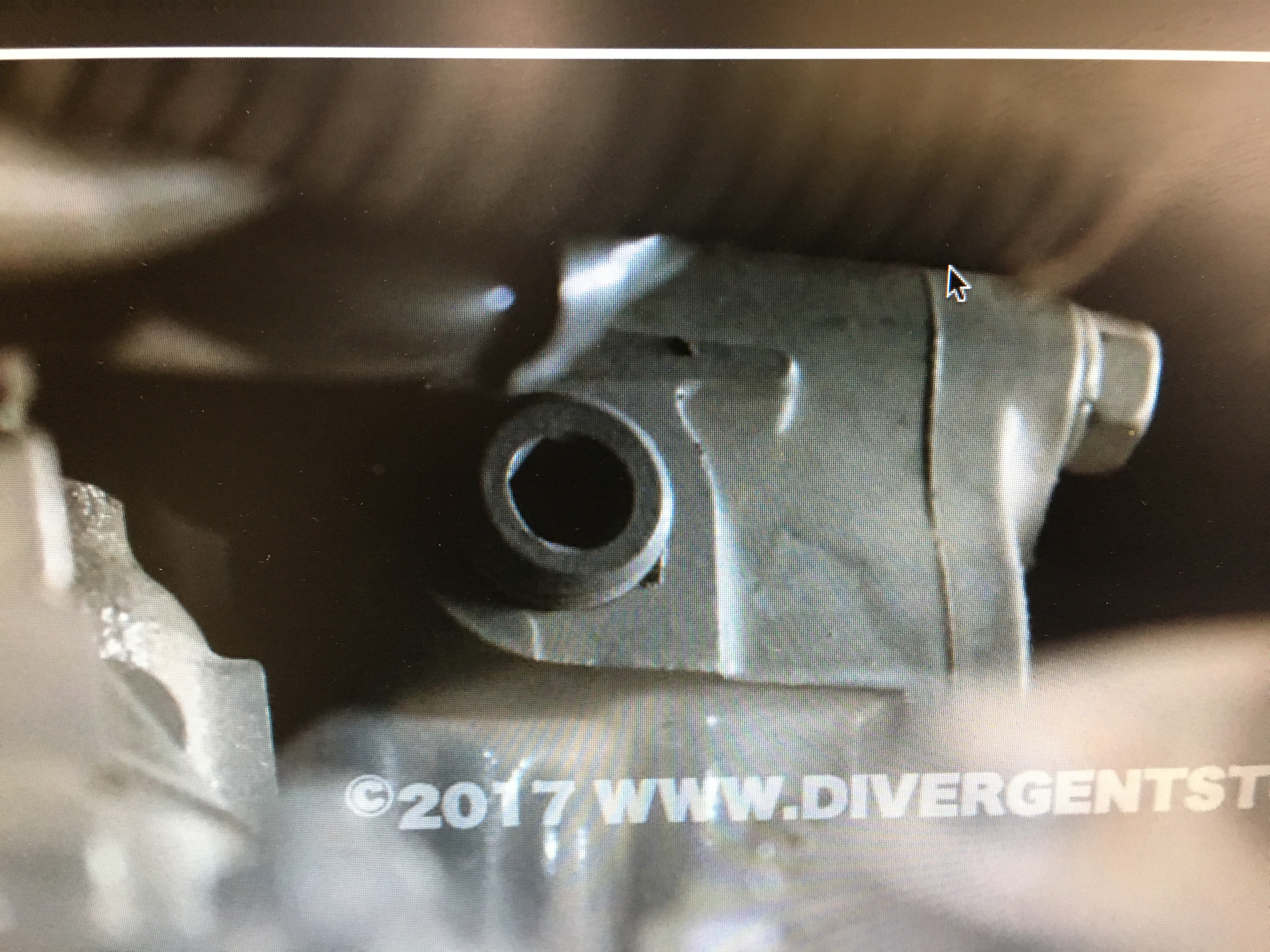

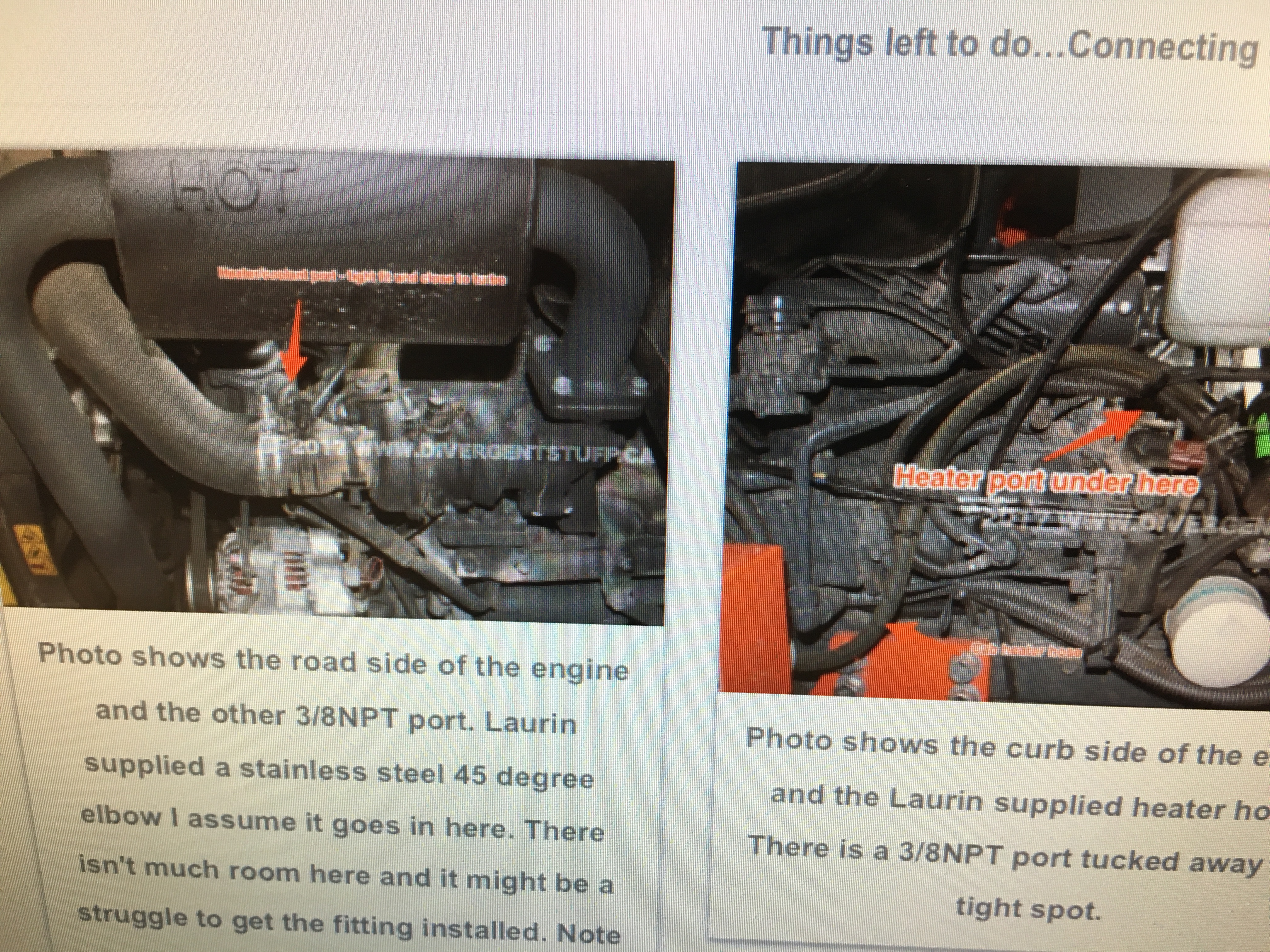

Princes Auto SKU 424003 heater 13,500 BTU
Princes Auto SKU 8003273 Switch
6 feet 5/8 heater hose - you can get that anywhere
Laurin Heater fittings (2) Hex Nipple Pipe 5/8 X 3/8 NPT code 156150000
Laurin Water control Valve for heater code 157800000
Need a short 3/8 elbow to connect The water control vale by the thermostat - Napa auto parts.
Lights Princes Auto SKU 8694796 4X5 Square LED Work Light (take off your stock lights and Brackets these with thread right in to the stock brass inserts in the Canopy )
Everything comes off in the summer except the windshield - the heater can be shut down at the thermostat - 2 min to unbutton the doors etc.
