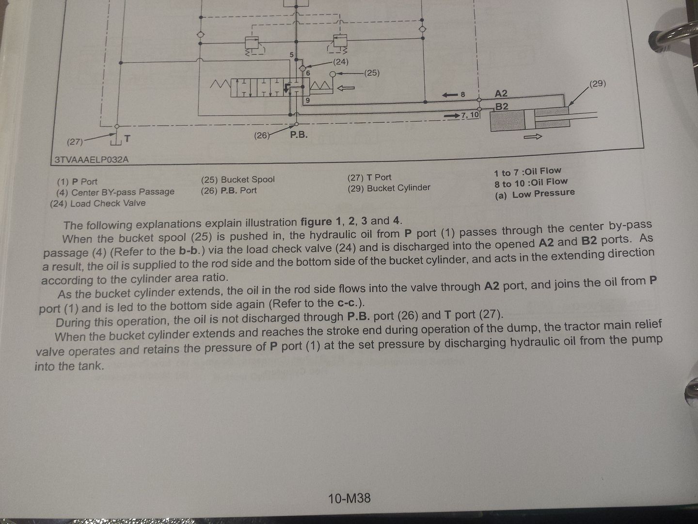

I'm attaching a picture of the FEL control function for a Kubota with 3-position FEL valve. If someone has a tractor with this sticker on the loader, I strongly suggest they go 3rd function or at least prepare to use the lift function for the diverter.

Not all tractors, in fact most I would say have the regen at the far right, not like the Kubota units that have regen before the normal dump. To the best of my knowledge, only Kubota and JD use the regen only dump circuit on their tractors.
Say the cylinders are 2" dia with 1 1/4" dia rods. Pump is set at 2500psi. Rod side has 4800lbs of force. Piston side has 7850lbs of force. Now go into regen and you only have 3050lbs of force. So yes you have gone from 7850 down to 3050. You have lost over 60% of the force that you would have without regen.
Yes you loose power in relief, that opens another port for the fluid to return to tank. Sort of depends on the system design and size as to just how much is lost.

That seems odd they would place regen on the far right. Using a bucket, wouldn't you want regen when dumping so you don't lose control of the load dumping accidentally? Maybe I misunderstand the true purpose of the regen?
I appreciate your math. That seems to coincide with my experience.

I'm not sure what you mean by "losing control of the load". :confused: Either you dump the load, or you dump the load quickly. (regen at far right) If anything, to me it makes more sense to go slow, then fast vs fast then slow (Grand Ls & M models I believe?)
Not that it really makes any difference, they both work, just have to adjust if you go from one type to the other. ;)
Regen is suppose to dump faster, but to do that, the bucket needs to be loaded, the weight with the additional fluid from the rod end bumps up the GPM a bit that is flowing into the piston side (closed end) and is suppose to speed things up. For whatever reason this seems to work well on some machines and not so much with others. I believe that how ever it is that the valve is made happens to be why some seem to work better than others.
Didn't use to make much difference, but then people became aware and some what educated about this stuff. I wouldn't doubt that the manufacturers don't really like us all that much. :confused3:
   / L3200/3800/3301/3901 Rear Hydraulic Remotes Install Corrections/Hints #30
Oh, I thought the purpose of the regen function was to maintain bucket control when dumping heavy loads. I don't understand how applying pressure in the opposing direction of the cylinder as well as the desired direction would result in a FASTER dump? I thought the concept was to control the dumping action even when the force of the dumping load was greater than the ability of they hydraulic system to control it. This probably wouldn't happen much on smaller machines with littler buckets and reduced loader capability.
