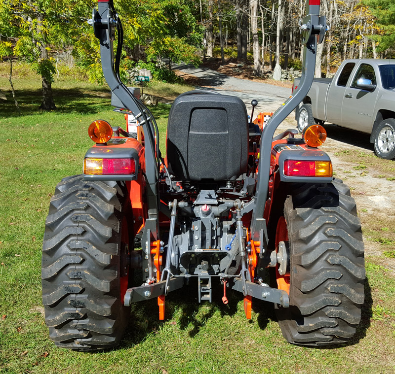

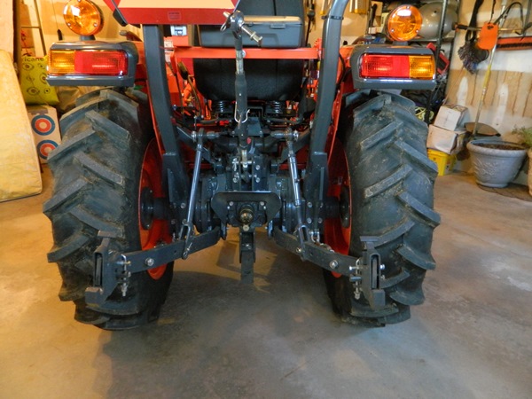

They are actually after and before shots respectively in each post. Good eye....They were definitely in the narrow position and now they are at the widest.
New tractors are almost always shipped in the narrowest position. If the dealer doesn't move them out for the buyer, that's what he ends up with.
I run my tractors at the widest position possible for the equipment I use. Tremendous gain in stability and ride. :)
Ok thanks, I can see that better now, can see the difference before and after, quite a difference.

Pic of my L3901 with 3" spacers....

How do you like that lower link quick attach system?
