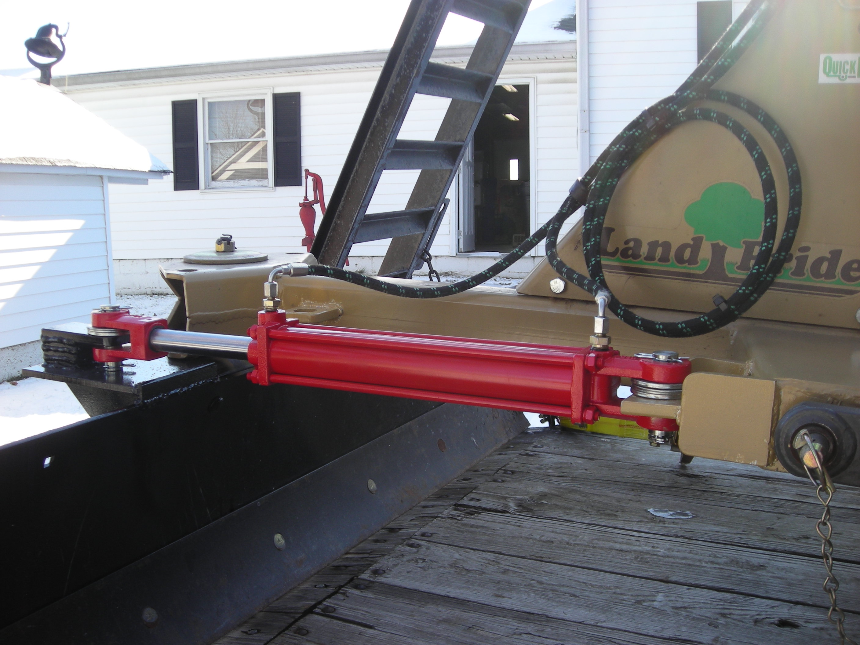

+1 on the 7 foot blade, I have a 6 foot and it's really not wide enough for snow. You want to be able to "wing" the snow back from your clearing path without driving through the ridge left from the last storm. Offsetting the blade helps, but the extra foot of blade would be nice in my case.
I think you want at least a foot or more outside the wheel tracks on one side. Too much blade and the tractor won't pull it through deep snow. I think an 8 foot might be too much for the 3940 under heavy snow conditions, but I could be wrong too.
Since you already have rear remotes, if you can swing the cost a hydraulic angle blade is sweet. I added that feature to mine and would never choose to be without it now. Getting down off the tractor every time you want to change the blade angle gets really old in a hurry. You may want to look for a blade that accepts plow shoes though you may not need them if your drive is paved.
DSC00677.jpgView attachment 294714

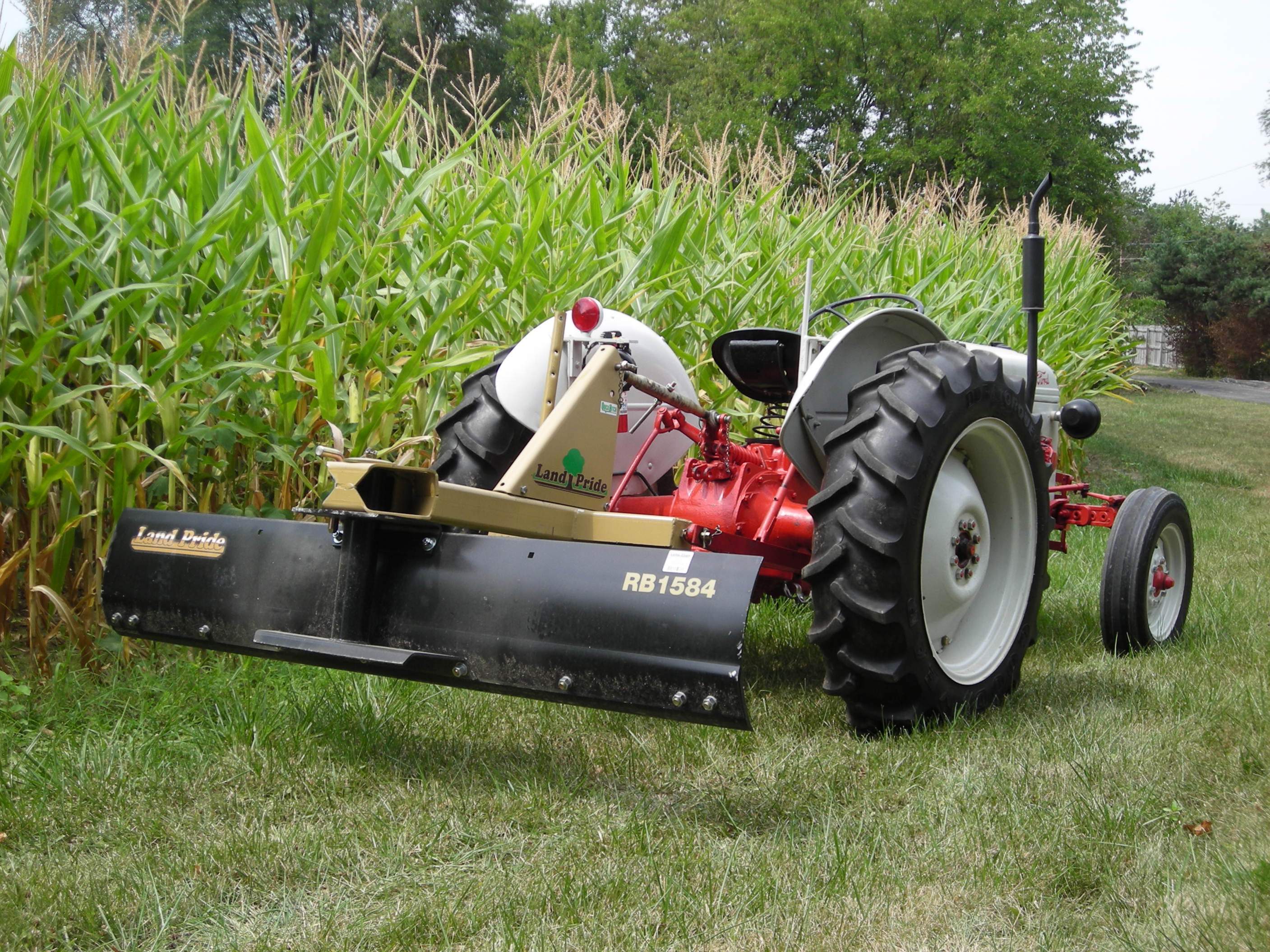

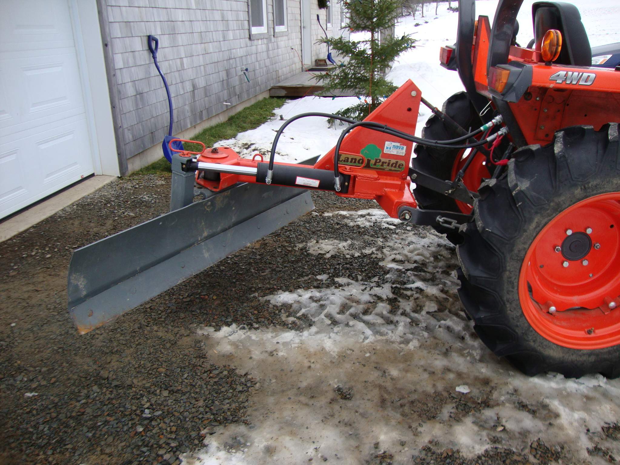

I used a rear blade for years to clean snow from blacktop driveway. Works okay, but for deep and heavy snow, not the best. I got front mount blade when I got my L3940, works great. If you are set on rear mount blade, Land Pride makes a nice heavy duty unit, RB1584, nice size and weight for L3940. I added the hydraulic angle myself. Philip.
