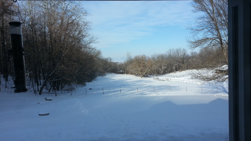

To give you an idea of the property, here's a shot looking out our front window. You can just make out the barn on the right and the Mississippi at the top of the frame.
The pasture in the view is about 1.5 acres including an overgrown .5 acre part at the far end. The area that is "fenced" (and I use that term loosely) is about 4 acres. The pasture around the barn is 1.5 acres. Behind the house the land climbs 300' over linear 1000' so won't be doing much back in there. :)
Soooooo, where's that bright orange thing that we have all been talking about? :D Great view by the way. :cool:
