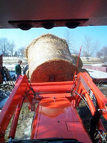

I'm looking forward to getting her out in the field and putting it through the paces or should I say harvest. When we start the 1st. cut, I be shooting pictures and will post them on TBN for your enjoyment.
I have attached a picture looking through the cab at a bale, so you can see what I see. /forums/images/graemlins/laugh.gif

Are your rear tires loaded to be able to carry a bale like that?
   / L4630 vs. L5030 #11
Seems like a lot of weight out front that far. Do you have any traction problems on the rear tires when heading down inclines?

</font><font color="blue" class="small">( Are your rear tires loaded to be able to carry a bale like that? )</font>
Nothing but air.
Daryl
Forage Services, L.P.

</font><font color="blue" class="small">( Seems like a lot of weight out front that far. Do you have any traction problems on the rear tires when heading down inclines? )</font>
The new loader mounts on 2 pins, back of the front wheels (look at one of the pictures). I'm not a geometery whiz, but it seems to move the roll center back. The 3710 I had, got light in the rear even with a backblade going down hill. The 5030 doesn't even with nothing mounted on the rear. We have a pretty steep incline behind the barn and I have to traverse it to put bales in the feeders. I always have the tractor in 4wd with a bale on the front.
A nice added feature of the 5030 is a tremendous amount of wheel cut as compared to the L3710. The 5030 will actually turn a tighter radius than the 3710 would.
Daryl
