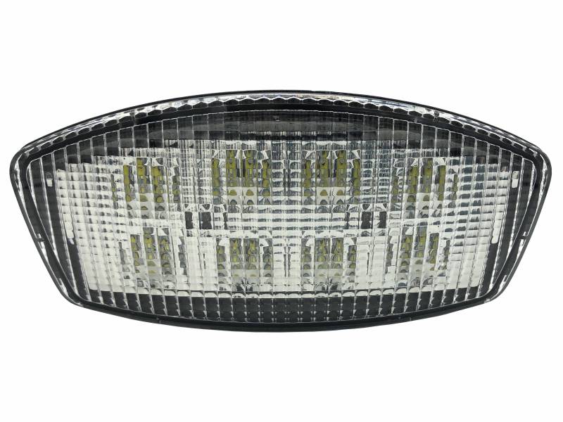

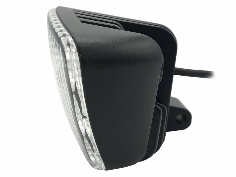

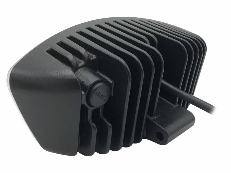

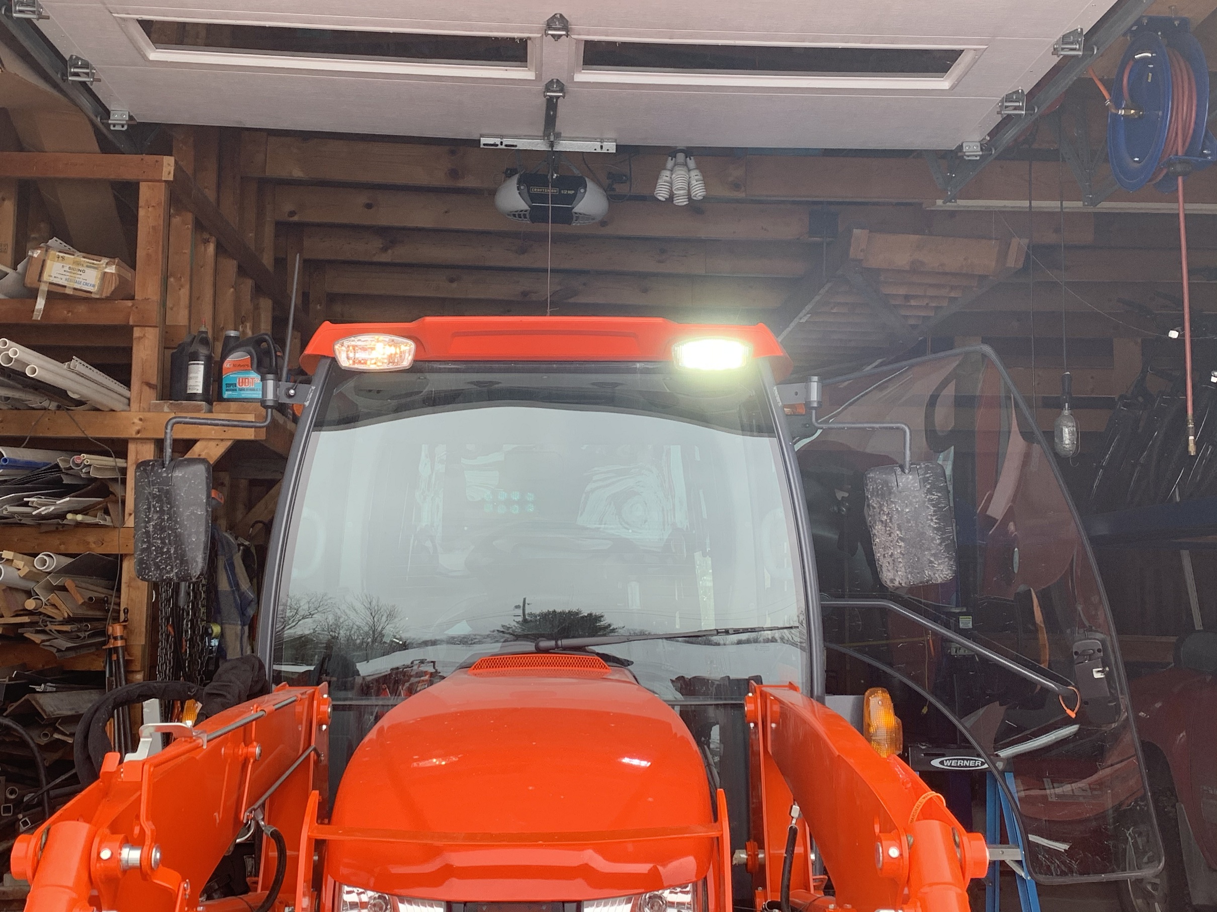

Anyone use these TigerLight TL3240 LED cab worklights on an L6060?
LED Work Light for Kubota Tractors, TL324 Agricultural LED Lights; from Tiger Lights

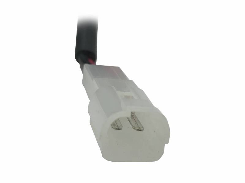

Not cheap at $95, but they are supposed to be plug & play. They appear to have the same profile as the Kubota OEM halogen cab lights but the connector looks different.
I have a bunch of LED work lights laying around the shop that could be altered to fit the L6060 but it would mean making new brackets and cutting off the OEM connectors. Also, they won't fit in the alcove molded into the cab roof like the OEM lights. They would protrude forward a few inches and block a bit of the view out the cab windshield. A very minor point I'll admit but it can be an issue when working with the FEL at full height.
Can anyone verify these TL3240's are truly plug & play on the L6060? If so, are they bright enough to make them worth $95?

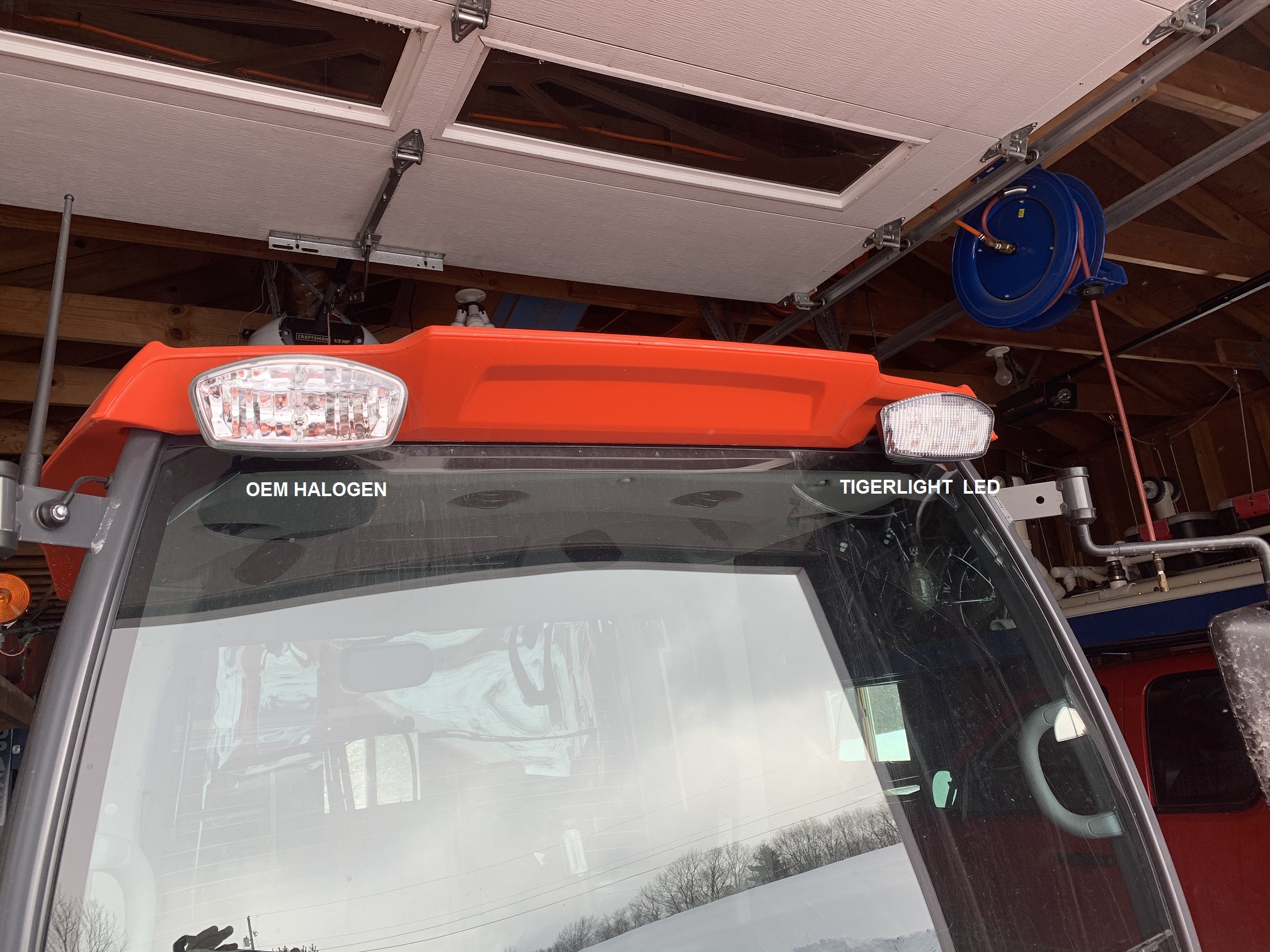

**** EDIT****
I went ahead and ordered these Tigerlight cab work lights. They are a direct replacement for the OEM halogen cab lights on the L6060 as well as many other Kubota models. The connector and mounting bracket fit perfectly.
Although it's difficult to see in the pics, the Tigerlights easily throw 5 times the light compared to the OEM halogens! In my case, this will make night work a lot easier! Well worth the $$ IMO.

Thanks for the post. I have bookmarked this. I have too many projects at the moment but new work lights are on my list. To you happen to know if these lights will also work on the rear?
   / L6060 Cab Questions
#76

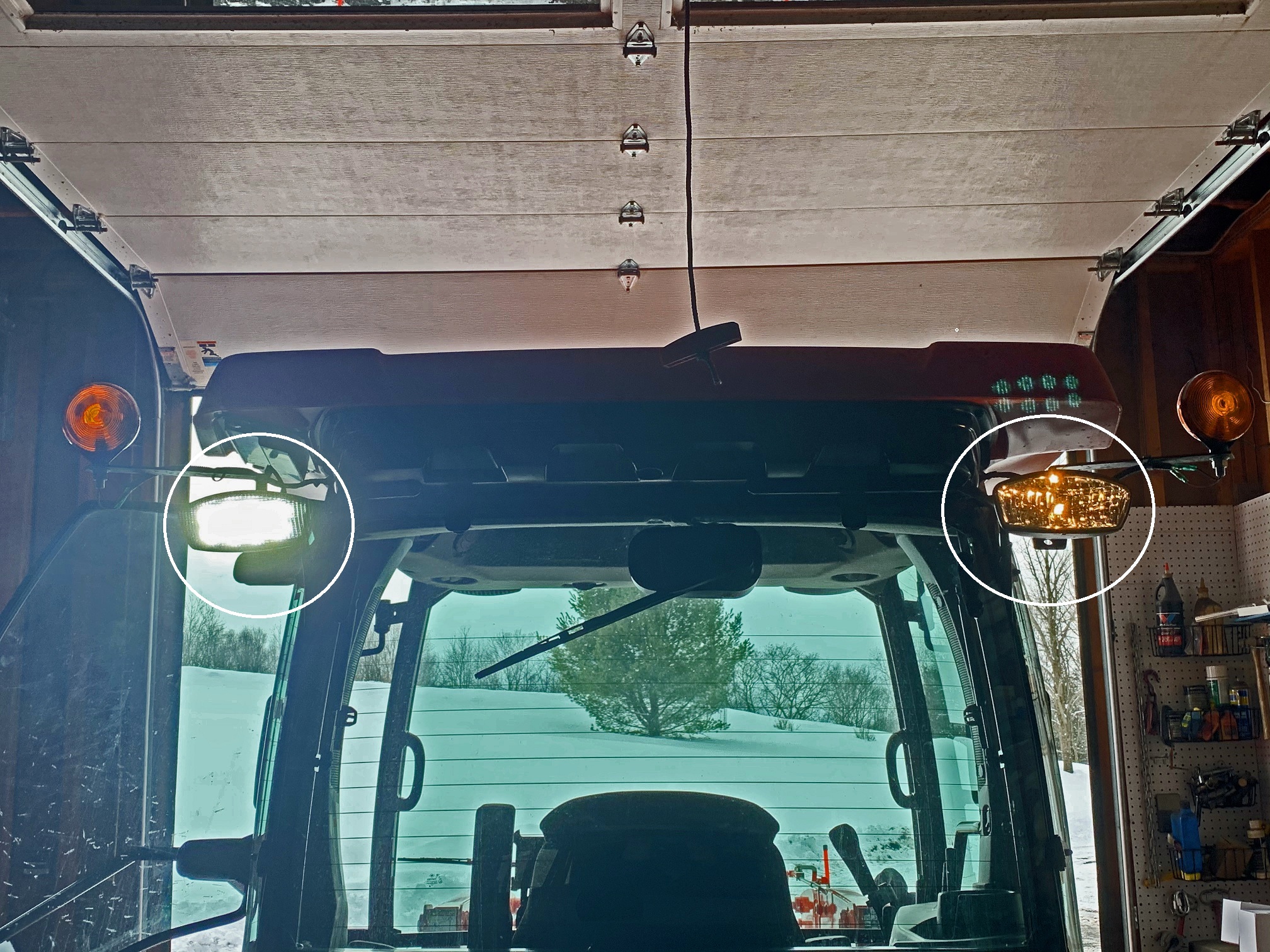

Yes, they will work on the rear. All four lights are the same. It isn't easy to tell but the second pic shows a comparison from the rear. It's a 60 minute project at the most. The hardest part was separating the electrical connectors.
Yes, I put them front and rear on two L6060’s. They fit perfectly and make great light. I bought them from Larsen Lights.
