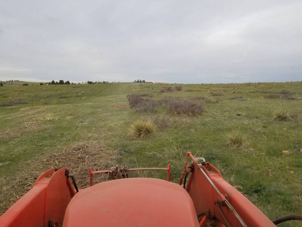

Strongly advise not using with a grapple until you have a screen to protect front end of the tractor. Tore the metal in the front grill, over $340, wow. That is the screen only. Have looked on line for options and found nothing.
I have failed to find a cab light, am missing or is Kubota missing it?
Having about 10 hours maybe few more on it using grapple and Phoenix Flail mower from Carver Equipment that is offset and tilts. Like both implements. Both need experience and require paying attention when using. My 16 year old grandson who learned to steer when 2 or 3 years old on my Kubota M6800 but about 6 lost interest in them has found at least a new "LIKE". Find the operation of certain features very different than my other two Kubotas and JD 5525. The rear remotes feel like toys compared those have used on my other tractors and excavator. Short little things and little feeling to them. My other tractors can feel the operation of the remote implement.

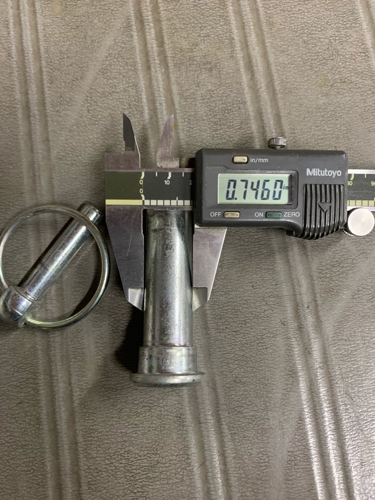

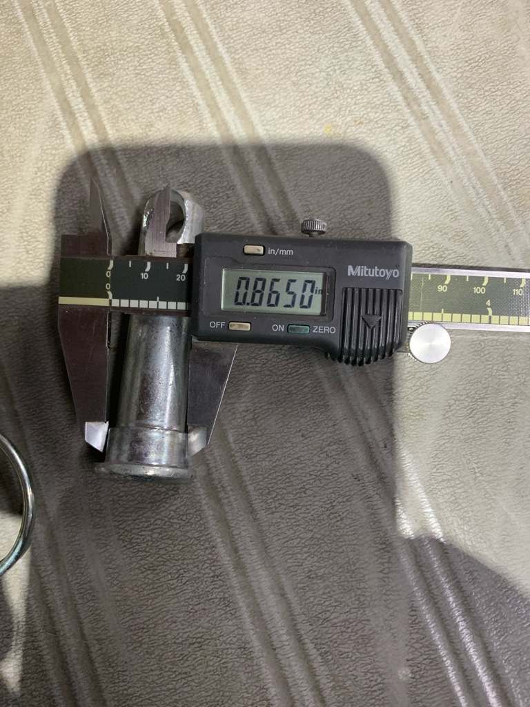

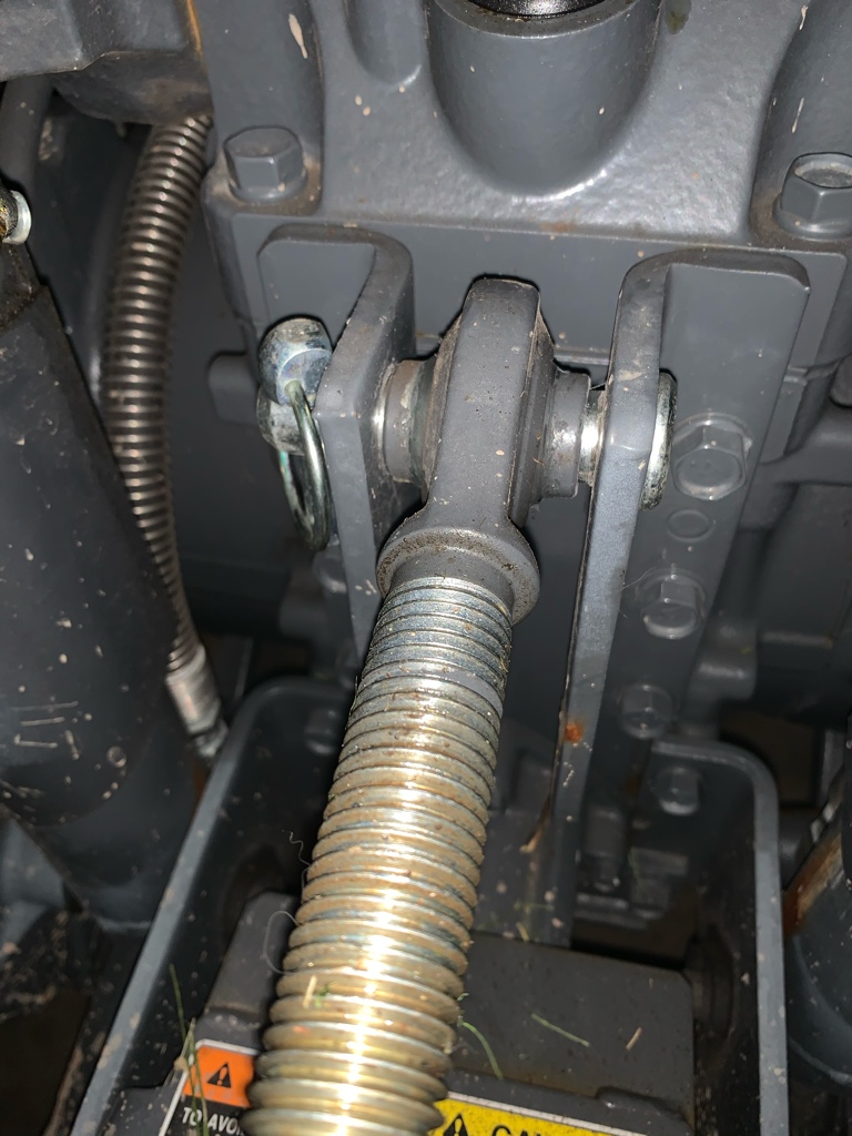

The top link is Cat 1, 3/4” Pin. The bracket on the tractor has larger holes on the RH side, thus the stepped pin.
But for your hydraulic top link, the eye needs to accept a .750 pin.
   / L6060 finally gets here. #56
Popgadget,
Thank you very much!! Really appreciate that help. I looked at some weld on ones today by Speco but they didn’t seem very heavy duty so I may order a threaded one from Agrisupply or somewhere and cut it off to use.
That one threaded end from Kubota is $103 for some reason. About $6.99 from everywhere else lol.
